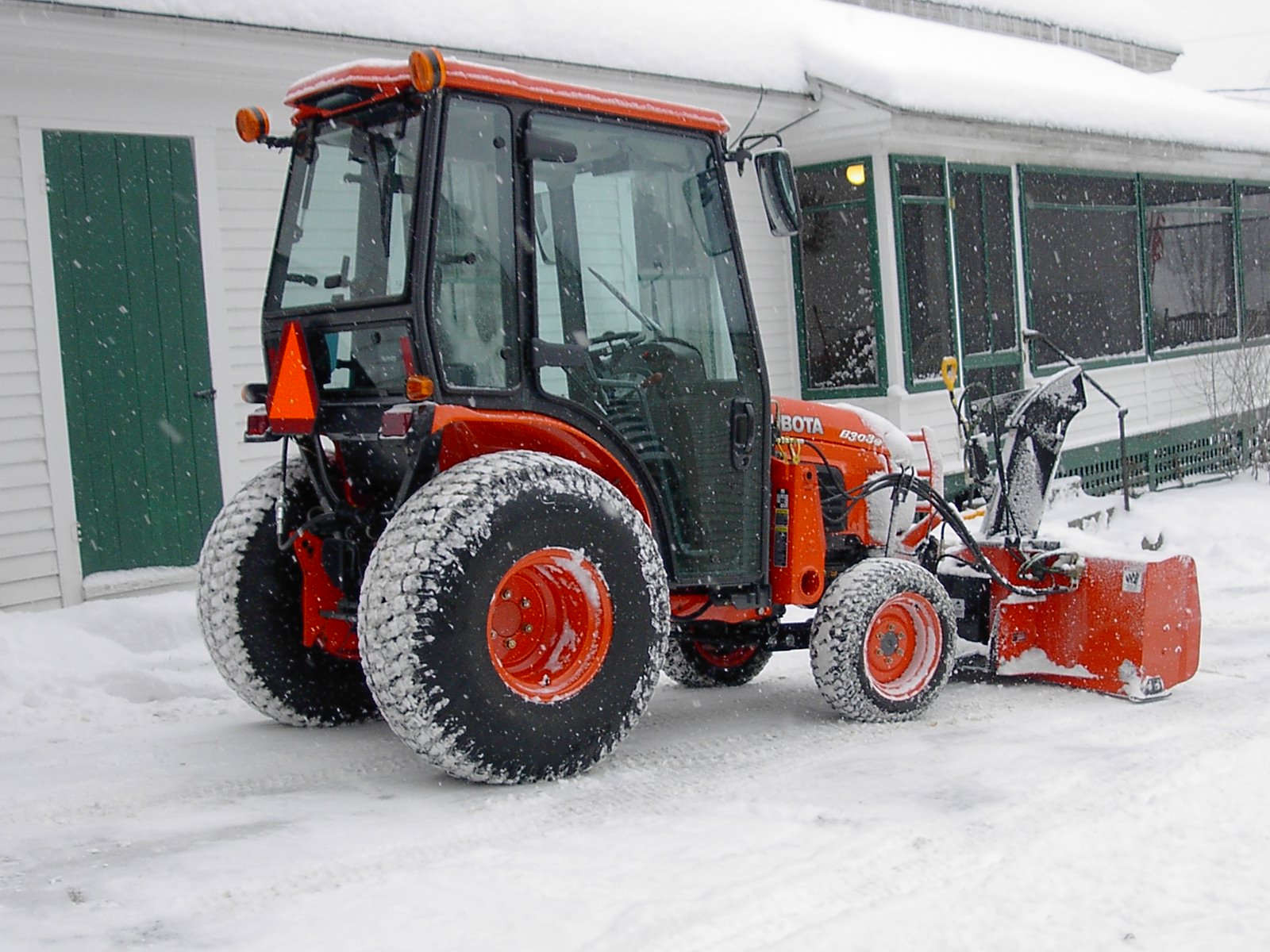

We have about 6" of snow here this morning...Suppose to be going away later on this week, but, I'm gonna help it along today...Orange power!
Don
/ Snow clearing #26
I think we had about 10" by yesterday morning and then it seemed to snow most of the afternoon.
Blowing a path to the cellar door, mainly all down hill so I have to do this every storm or I might not be able to get back up the hill!
Today it is snowing again and the local weather report is an estimated 8 to 20 inches depending upon location. I guess I can expect close to 20 inches. Some are talking about a repeat of last year! It seemed like we had two storms a week through out the winter really makes one wonder how nice it is in the no-snow zones of the country!
/ Snow clearing #27
Wayne. How is that cab on your rig? Was it expensive? Does it work well to keep you warmer? It it hard to keep the vision clear? I would love to fab one up for my 1050 JD. I need to get it able to move snow properly first though.:confused:
