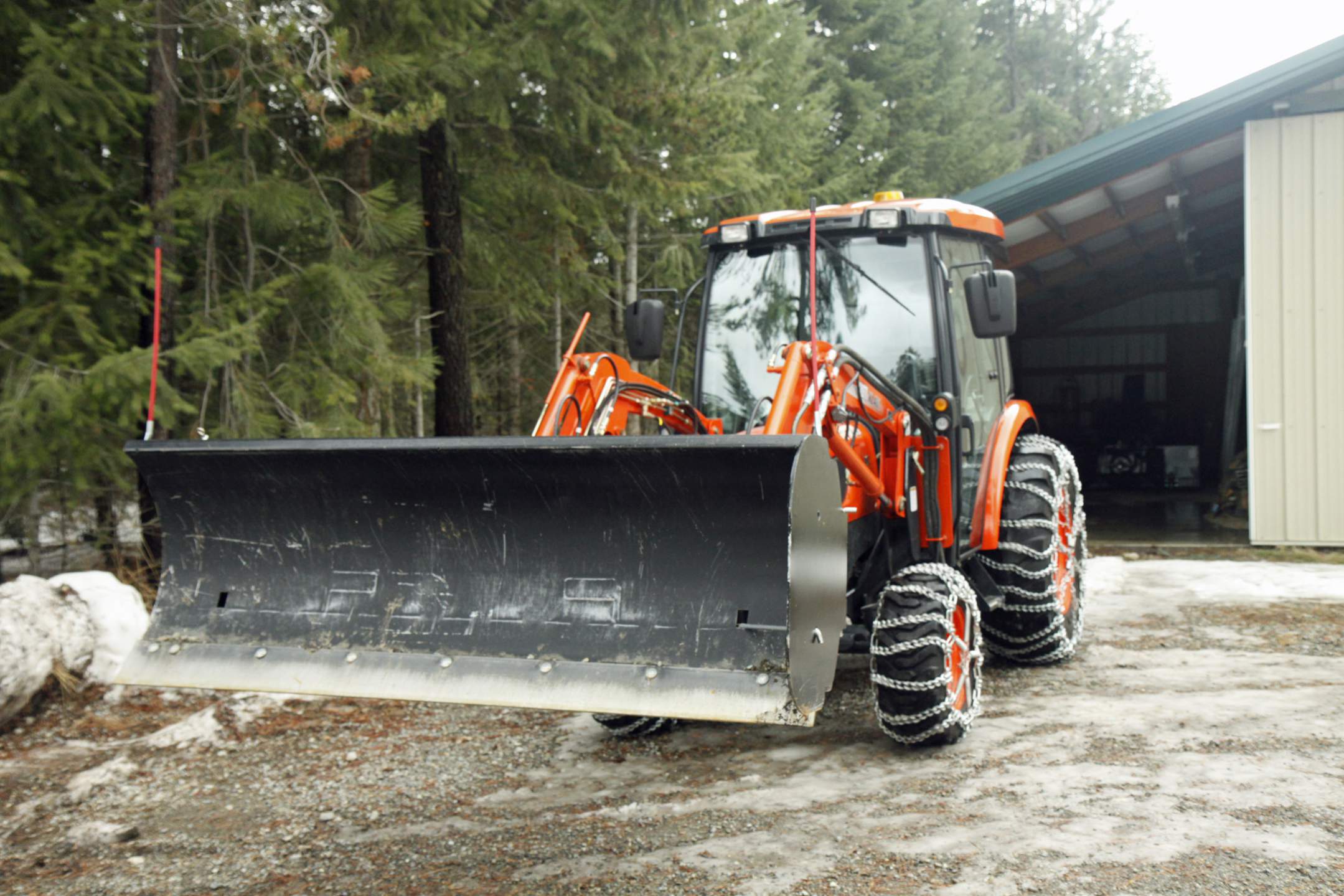

Meyer 7.5 ST Snowplow attached to my 2001 GMC Sierra, supplemented by LA 181 FEL on my BX1500 for the tight spots and final cleanup.

I have a 100 foot driveway and also plow the neighbors. I usae the same procedure that Mossroad does to start the plowing. I use turf tires and have never had a problem with traction even when plowing 6 inches of the wet stuff.
Tractor and plow ready and waiting as the first snow is expected next week.
