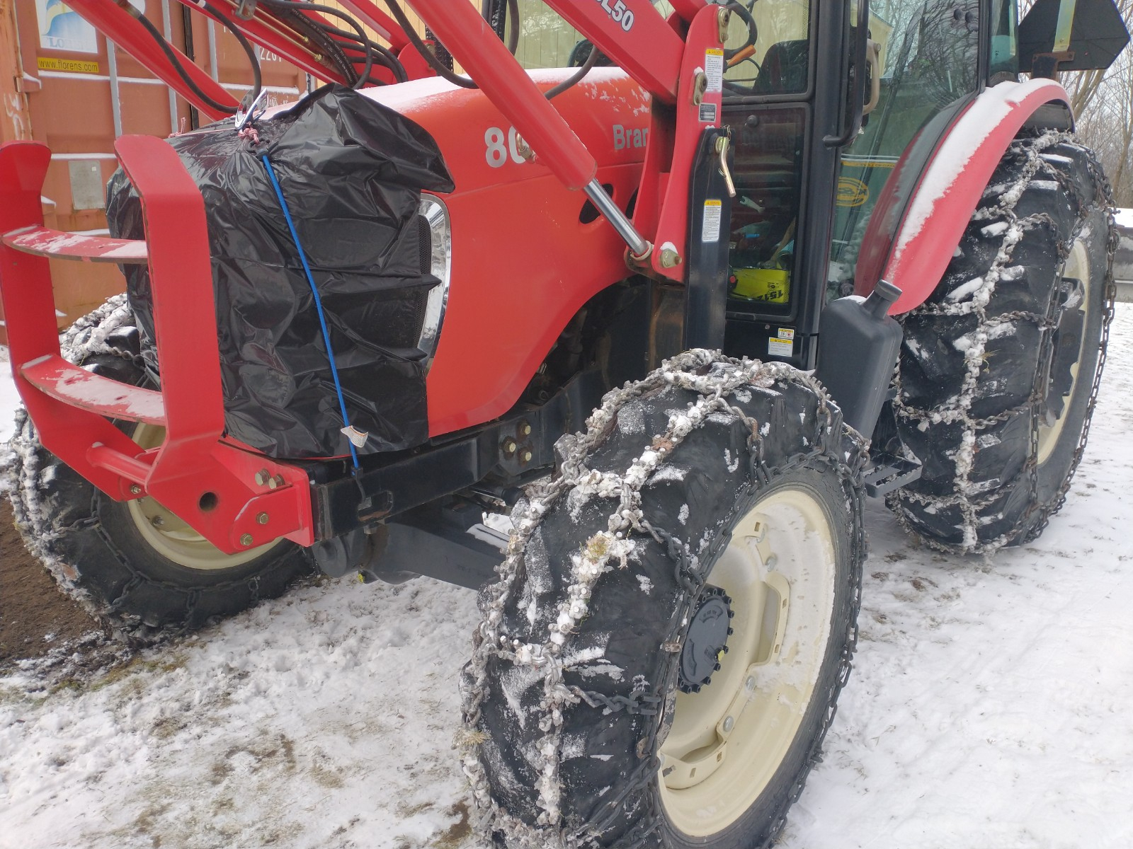

I did a lot of research and reading threads about chains on this site before making a decision and I went with studded euro style chains. The decision was based on how much ice I know that I can get depending on the year. I was not disappointed in the performance and the studs to a very good job of breaking up sheets of ice.
/ Snow Chain Recommendation #25
Good for you Yooperdave, I have the V-bar per 2 link chains up front. And they were 140 shipped and change. So far they really help on my non studded Duo h-pattern rear chains. But I think I'm going to upgrade to Trygg or Aqualine chains in the rear, my driveway is nasty heading onto the highway. I have very little fender clearance in the rear tho.

I don't think that you will have any clearance issues with the Trygg or Aqualine chains it looks like the dou grips clear good.
They are a fairly low profile chain.
And you will be amazed at how much better the grip is.
