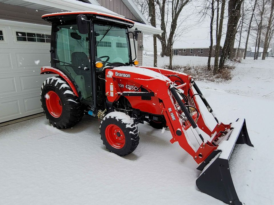

I now have a CUT with industrial tires which I am aware provide lousy traction in the snow.
I plan on installing chains to the front wheels only so I can confidently plow my sloped driveway.
What do you recommend as an economical solution?
TIA
Yooper Dave

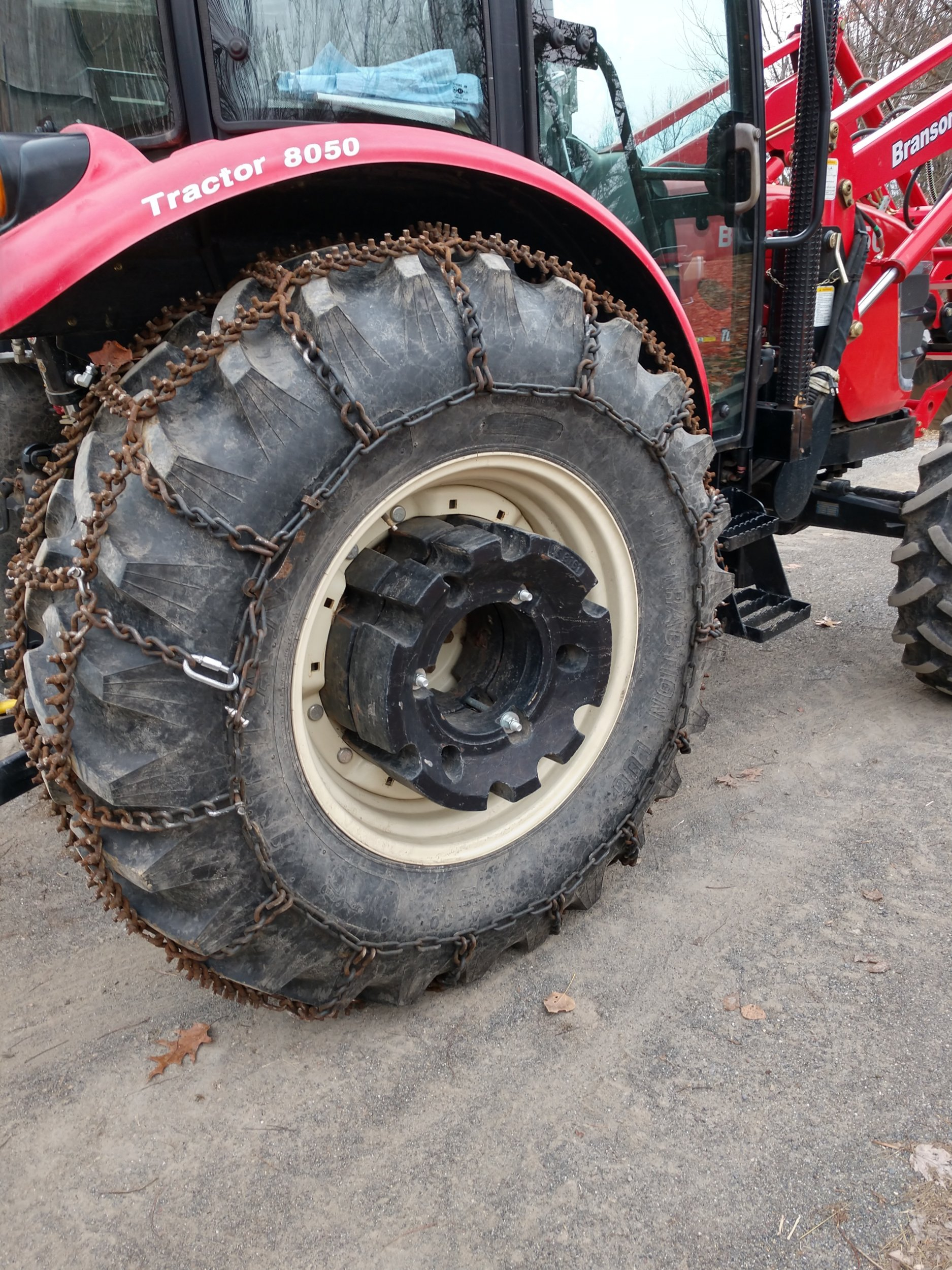

Economical solution. 2 link ladder, 3/8" twisted cross links. Paid $260/pair July 2021. Had to buy a much larger set and remove 3 links from the cross links to fit.
All the 2 link ladder for my tire size were for garden tractors. Very light weight.
If I had to do it again, (economical), I would go with 5/16" cross links.
Ride is a bit rough. I'm plowing gravel surfaces and blowing trails in woods. No road travel. Will stall the tractor before the tires spin.

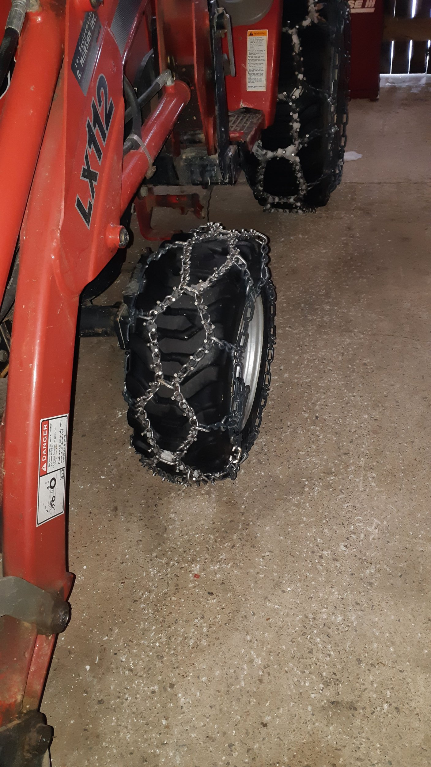

Get Trygg or Aqualine european style studded chains, there is simply no comparison in smoothness of ride and grip. The Aqualine MPC's would be a good second.

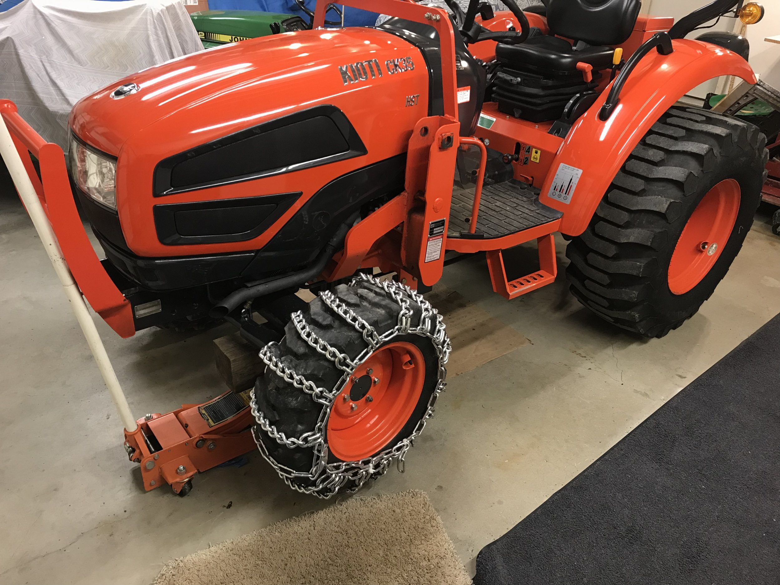

I found that 2 link ladder chains for a garden tractor (MUCH cheaper) work just fine for me on the front.
I have a half mile private road, 1/4 mile drive & 2 neighbors drives I do with hills.
Real tractor 4 link chains on the back made the ride too ruff and were taken off that same day.
Don't seem to notice the 2 links on the front as far as ride goes.

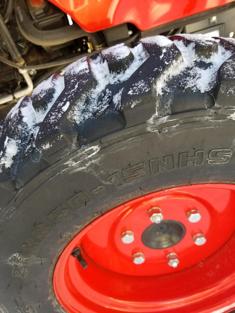

I posted a picture of my front tire 28 x 8.5 - 15. Is this a difficult size to obtain chains?
