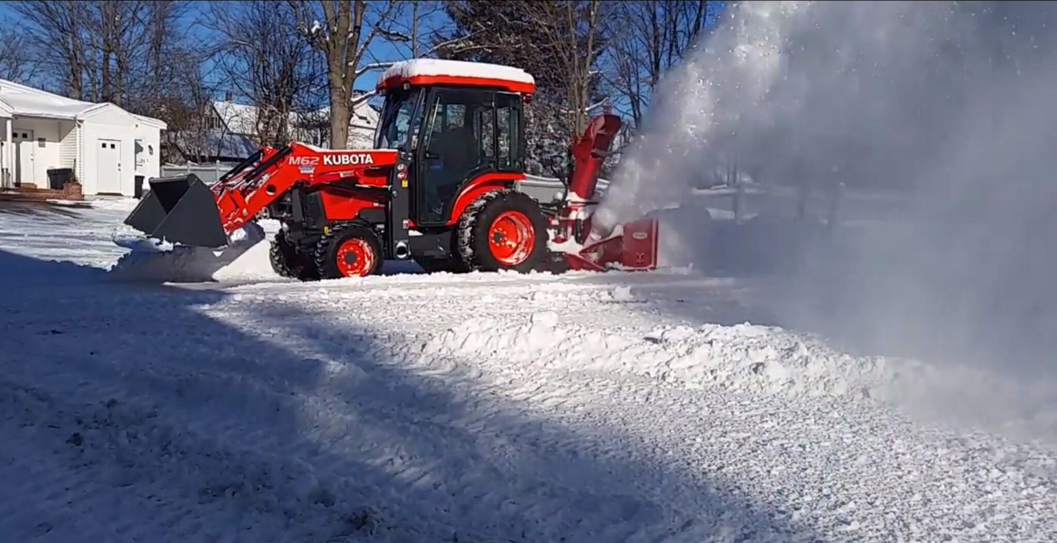

   / Snow Blowers #15
I've run both front and rear mounted snow blowers on my TLB's. I made an adapter to mount a 5 foot 3PH snowblower and ran a hydraulic motor to drive the PTO with a 16GPM hydraulic remote setup. I currently run a 6 foot blower on the back of my M59.
The front mount is great and saves your neck big time but the hydraulic flow just isn't enough for heavy snow. The other negative with my setup was that the blower sticks way out in front so if you need to negotiate a lot of curves or have lots of obstacles its slows you down and you can't get into as many tight spaces.
Running the rear mounted blower on M59 cut my clean up time in half. The hydrostatic drive is awesome as I can leave it in high gear and can vary my speeds easily and beats my old gear drive TLB hands down. The rear PTO never seems to get bogged down by snow and I never went back to the front mounted blower setup.
I just added a cab to my M59 so I'm actually looking forward to winter again this year.

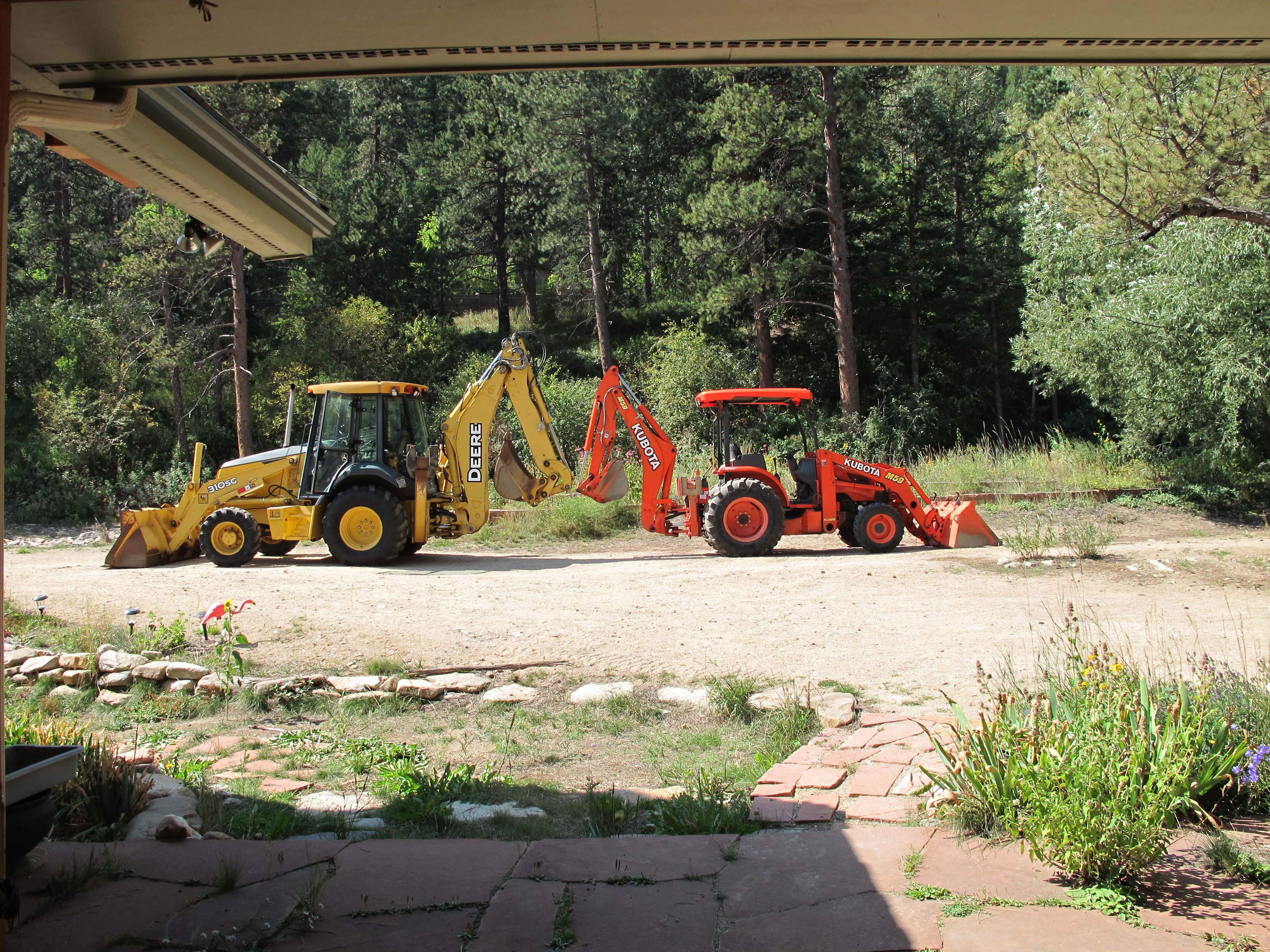

I may have been trying to fit a snow blower to the wrong tractor. The M59's SSQA, cat II 3pt, and PTO seduced me at first, but now that we've discussed it I can see advantages to putting a snow blower on the JD 310SG. The JD doesn't have SSQA, a 3 pt, or even a PTO....but it does have a heated cab and an accessory flow circuit that pushes out 36 gpm at decent pressure - with cooling and filtration built right in. One of the reasons I didn't consider going that route is that attachments for the 310 tend to be somewhere between way too expensive and downright unaffordable. It's commercial; not homeowner.
In fact, I've never even looked to see if there is an SSQA adapter for the JD 310, but since there is someone who makes nearly everything else for the JD commercial backhoes, SSQA might be available. Anyone know?

   / Snow Blowers #18
Roger,
That is a great photo!
I was interested in doing something very similar many years ago. The general consensus seemed to be that the weight and power of the full sized backhoe/loader would pretty easily overcome the design build strength of SS attachments.
http://www.tractorbynet.com/forums/attachments/245854-skidsteer-attachments-full-size-backhoe.html
The major disadvantage of this setup would be lack of maneuverability. Similar to a hydraulic power pack system and FEL mounted blower on your tractor, it's going to make for one LOOOONG package with a large turning radius. Just think of how far forward that blower would be, plus the backhoe sticking off the back of the 310.
If this wouldn't be a concern for you, then it may work out very well if you could find a heavy duty blower. However, to get a blower as heavy and wide as you'd need on the 310, I don't know if you'd be saving any money.
I'd think,you'd be well over $10k for something that stout, and still,risk damaging it very easily with the power of the 310. Personally, I believe your better off investing in a cab for your M59 and going with a rear mount blower.
I almost always think an inverted pull behind blower is better but in your situation I'm sure you get too much snow at one time for one of those.
