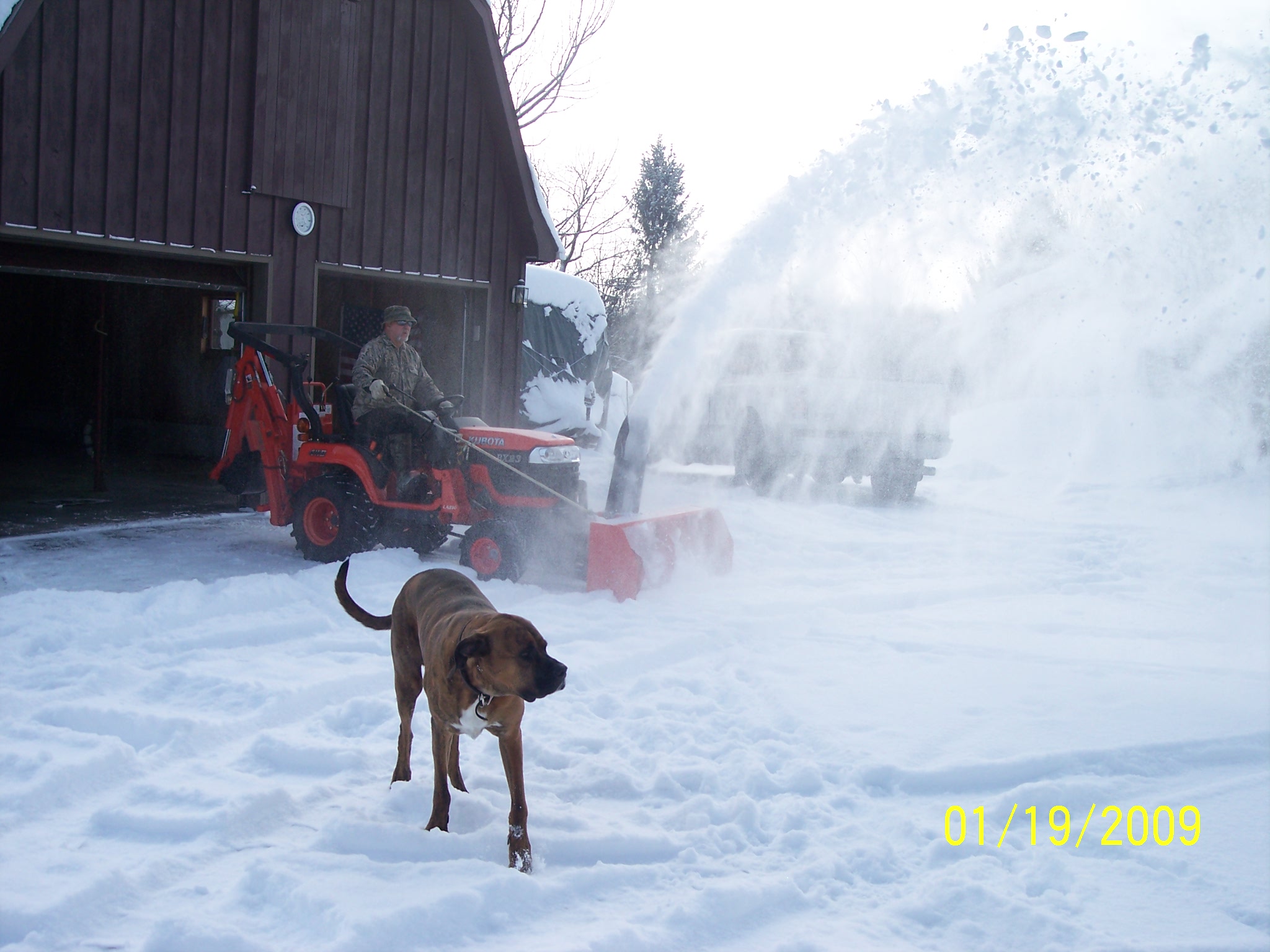

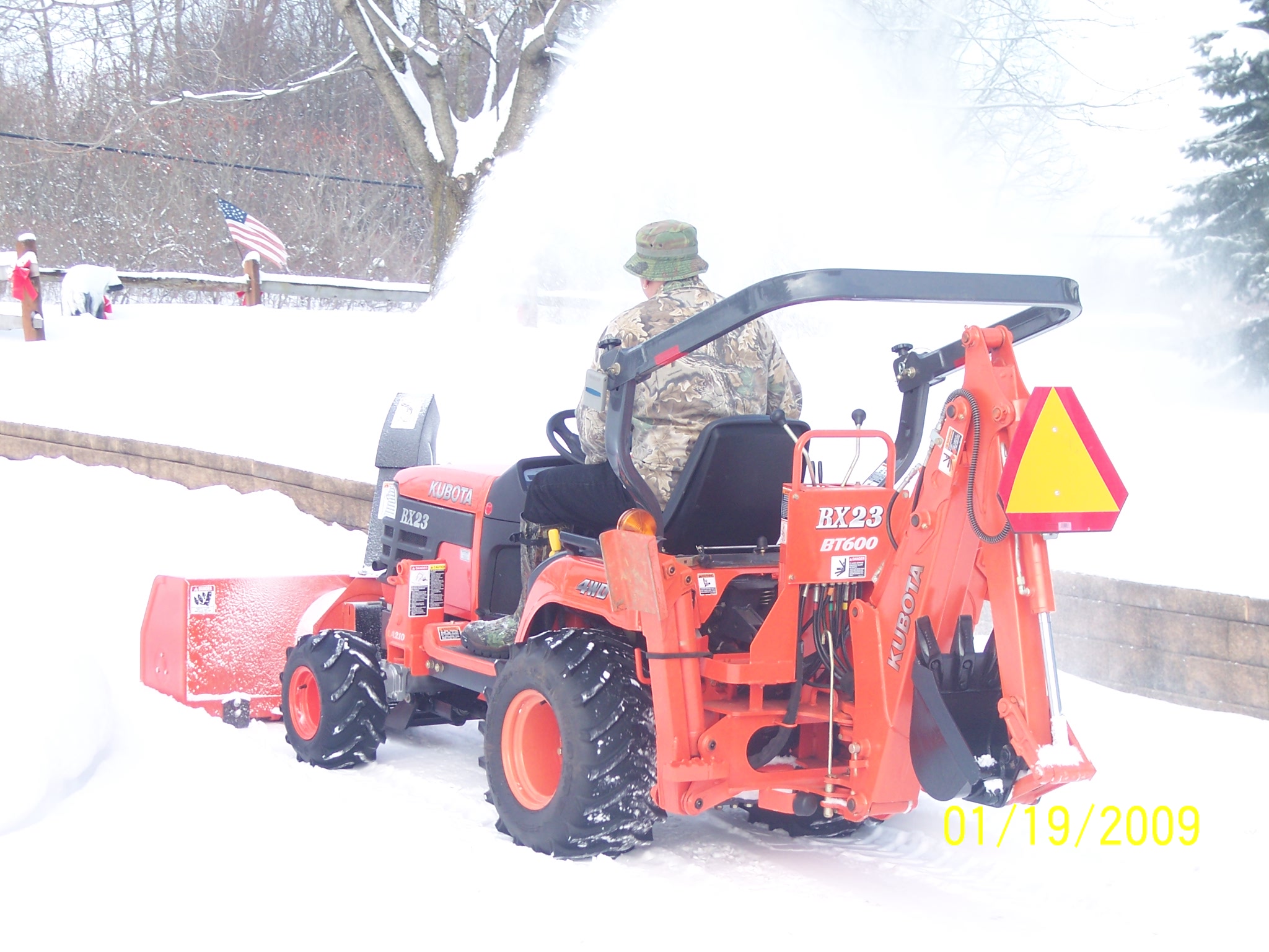

You know when I had a rear mounted snow blower It would blow snow just great! I could make paths across the back lower 40 for the dogs to do there duty. But after having it a few years I really hated looking backwards or cranking my neck around, and always going in reverse. Then I purchased my new tractor with a front mounted snow blower. WOW! It could and did blow the snow almost twice as far as my rear mounted blower. Only thing is when it's on, no FEL. Yeah I could remove blower and install FEL---but?? Front mounted snow blower was best for me.Hope this helps, good luck with your decision.

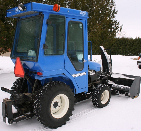

You might be able to have the quick hitch on the B2620, but not on the B3030. If you look at the picture below you see the push bar with the black rectangular piece of flat steel with six holes in it. The quick attach unit for the snowblower mounts on that. That steel plate is, horizontally about 3 inches from the big crossover pipe on the loader, which means when the snowblower quick hitch is on the tractor, you could not lower the loader all the way down without the crossover pipe hitting the quick hitch. As you know, you often need the loader all of the way down.
Although both could be on the unit simultaneously, your loader wouldn't be very functional.
To me it looks like the 2620 loader and snowblower setup works just like the B3030.
