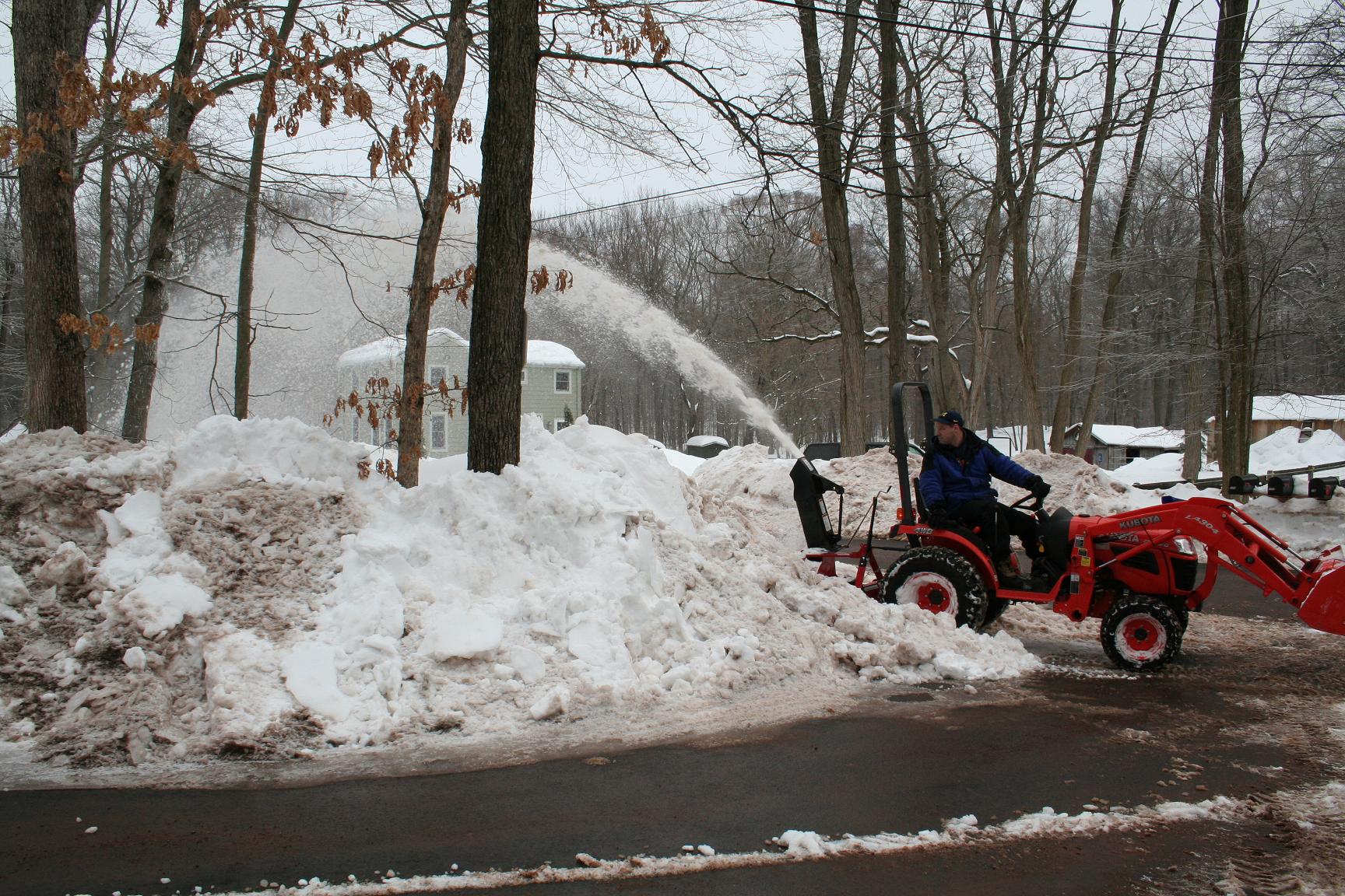

I just got a Bervac 48" rear mounted delivered this past Saturday for my little Kubota 2320. From my understanding Bervac's are made by RAD which makes them for other companies including Kubota.
I like have the FEL on to shove some piles around or to break down some of the icier stuff along the street. Honestly though, this little unit didn't have a problem chewing through most of the mixed ice/slush/snow at the end of the driveway and along the street. We can now look both ways coming out of the driveway!
I have an 800 foot long gravel driveway. Packed pretty good, soft in the spring though.
But now that I have one, I'm sure we won't get any more significant snow =P
Looks good Dubeast,
what type of shoot control does this unit have..? Manual ?
BY
/ Snow blower recomendation ? #11
Yep...manual chute control...think there is an option for automatic control though.

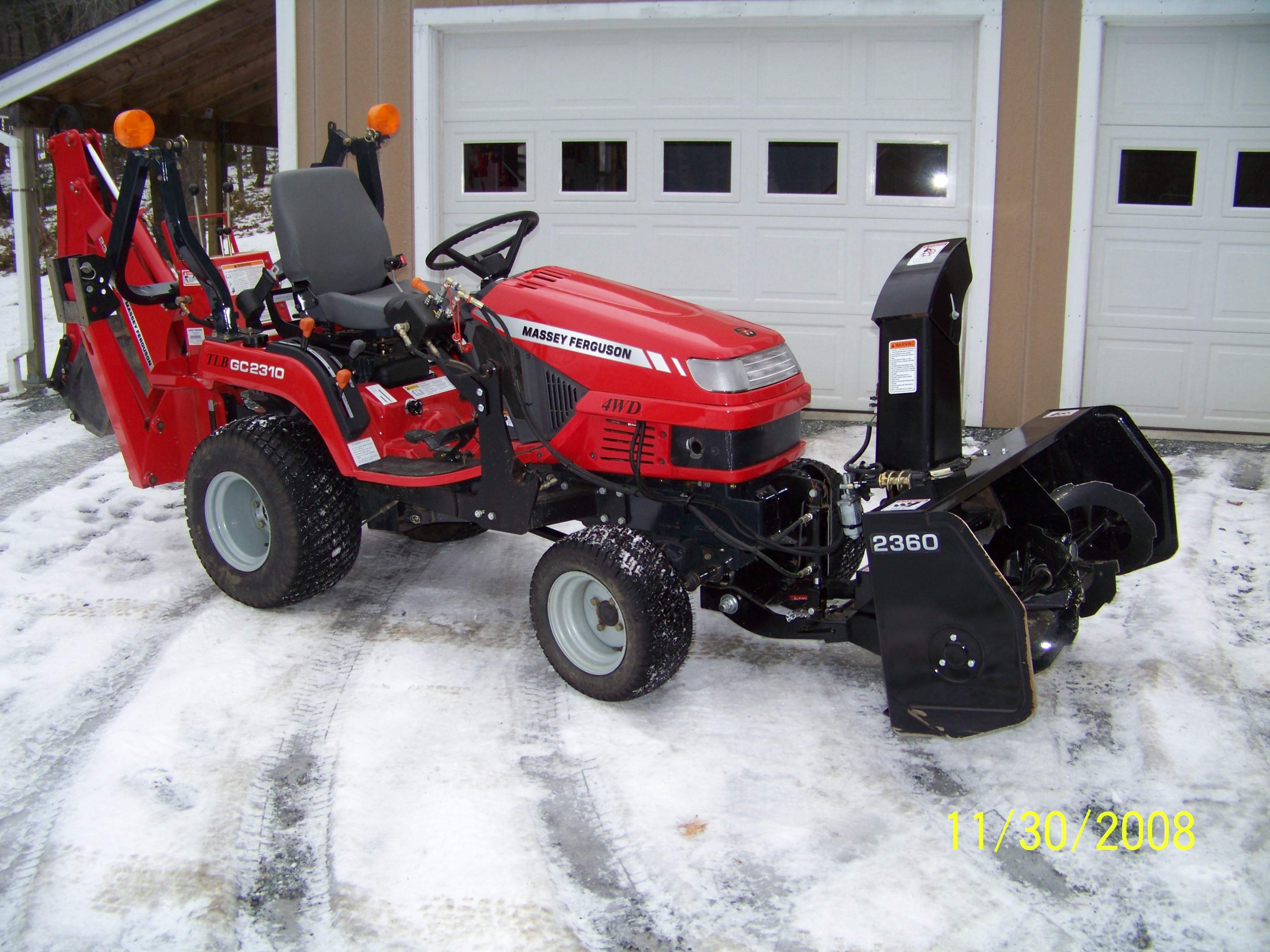

My driveway's only about 350 feet, but I keep a path open all round the house and have a large open area in front of the garage. It was expensive, but I never thought about anything but a front-mount blower; that's really the main reason I got the tractor.
It works very well, chews through anything I've pushed it into so far, and I've found I really don't need the FEL except maybe a couple of times during the winter and spring. Even then, it doesn't take me long to switch them at all, so that hasn't been an issue for me.
Mine has electric chute controls-- a bit slow, but handy, and they don't change position during operation due to normal vibration.
