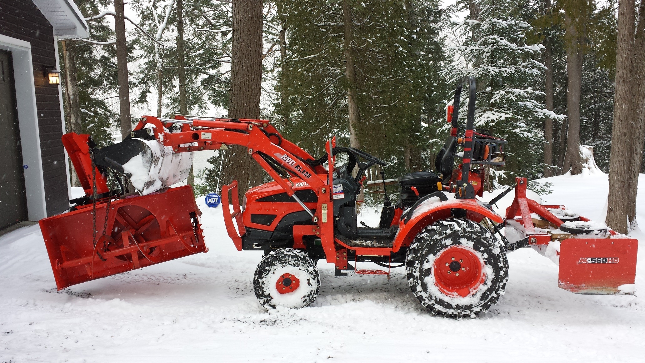

Well, as usual, I'm late to the party... I'm still going to suggest welding some 3/16" strap to the blades... make the pieces all the same length and width so balance isn't screwed up... NOW .... usually the impeller is not centered in the housing... So, when welding the plates in position, be sure you measure plate placement where the impeller main shaft is closest to the housing where you put the new 14 gauge liner... I would leave about 1/16" gap at the closest point of the housing... Make sure the impeller shaft bearing is not sloppy.. that could have disastrous effects on the impeller modification.. You could even modify the outboard edge of the newly installed plate to have the cup effect of the one impeller suggested in one of the posts... I'm thinking I may make that modification to my new blower...

Thanks for the suggestions. I have it exactly to about a 1/16” from the tightest spot of the housing. And that’s why I’m only doing one of the blades at a time. So I can fit it one perfectly. I thought about trying to modify the impeller. But I would then want to balance it and since I can’t remove it I figured I better just leave it the way it is. Between relining the housing, getting the clearance down to a 1/16 and adding the triangle piece on the upper left hand side of the opening I think the performance will improve. If not she will be for sale!

On a side note- I have to build an impeller kit for my blower. I've got the power to run it, but it just doesn't throw far enough for my needs. and the drum gets caked up with sticky wet snow. I figure if I can use some thick conveyor belt material and close up that gap, it won't plug up as much. Mine's a 6' McKee Sno-Lander 520.

While always on my 'to do list' is to close up the fan to wall gaps, that or make up a 4 blade fan.

If you look at newer blowers most have a part of the circular fan opening blocked off near where the snow enters the chute
You can experiment with your blower by adding this triangle piece. Make it from plywood to start with so you can fine tune the size.
Bolt the piece on, don't weld it on when you get to the correct size as it must be removed to remove the fan should you ever need to.

Thanks for the suggestion, I already have it on there. I will post some pictures.
Just need to wrap a few things up and sandblast prime and paint the blower.

Here is a picture. All blades are clearanced to the new smooth housing to about a 1/16
Front plate is on with 4 bolts.
Just need a few more touches and it will be ready for sandblast and paint.

The triangle wedge that is welded to the upper left portion of the impeller throat is there to keep the snow
inside the impeller housing so it can be ejected through the chute and spout.
If you look closely you will see that the base of the snow blower chute is directly above the left side of the impeller housing directly above the triangle of plate steel, and yes there is room to remove and install the impeller in the event the impeller is damaged or the snow blower drive train needs to be removed.
Toro has modified one model of its walk behind 2 stages with a spill over opening which essentially allows the
snow to be thrown out to prevent the impeller from plugging.

The gear box shaft extends a long way from the back of the fan housing to support the fan. The fan will not come off and out of the enclosure with the triangle in place
The only way to remove the fan is to pull the gear box back!!
This dimension spec from COMER shows the fan shaft of the gearbox is 6-1/4"
The fan is 10" deep x 30" diameter.
The fan has to move forward approx 6" to clear the gearbox shaft
That is why more expensive blowers have the triangle restrictor bolted instead of welded.

In one of the pictures I noticed that the inside of the chute was very rough. The paint was pitted and rusty. Along with impeller clearance I'm thinking that the roughness inside of the chute is also part of the problem.
I have a JD 59 for the front of my tractor and even though the impeller clearances are on the high side I can still throw snow 30-40 feet. The inside of the chute is shinny metal as the paint is all worn off.

Yes the chute was pretty rusty and pitted. The blower sat for awhile. It will be all sandblasted and primed. Sanded smooth then painted shiny kubota oranage. Will then wax it with snow ski wax. The blower should work good after all the fixes are done.
/ Snow blower performance #80
Going to all that work I'd suggest, if U can, to line the chute with some plastic that you could heat and mould to fit.
Even a strip lining the curved backside of the chute will help greatly.
I had some very thick 8" wide PVC tape that I lined mine with. Made a fair difference until the tape shredded from stones.
Waxes and oils just don't last.
When I store my blower for the summer I 'rattle can' spray all the bare metal parts as even the thin spray can coating is enough to prevent rusting over summer. Naturally first blowing event removes the paint but there is no pitted rusty metal to deter snow movement out of the chute.
Ice and snow will grip on the rough metal but not on a slick surface.
