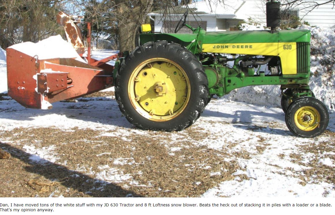

could this be a similar brand blower? if so, maybe it helps us narrow down what brand the blower is,
notice the spout rotation in this Loftness (pic stolen from another BB)
I sent one of the owner's photos to Loftness to see if they can identify the blower.
Dave m7040

Thanks for the reply, maybe they can identity the blower
the impeller is is connected directly to the to the pto shaft via a straight through shaft in the gear box. It turns at a 1:1 ratio with the pto shaft. Therefore is spinning at 540 rpm with the pto.
There is no chain/sprockets.

Dan
I contacted Loftness and provided a photo of your blower.
See if you can find the serial number where they suggest.

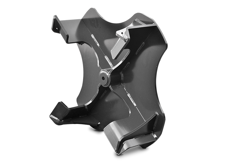

A few suggestions,
Before you add length to your impeller blades, check the impeller housing for wear, holes and such. You may need to reline the housing before adding to the impeller blades.
Look at various impeller designs before modifing yours. I have a WIFO blower which works great, if you scroll through the pictures in the attached link you will see how they designed their impeller. Check other designs to see which you prefer. http://www.wifo.ca/products/snow-blowers/3-point-hitch.html 3ph-snow11.png Notice how the last few inches of the impeller blades cup the snow.
Check the passage way between the impeller housing and the chute. You have a lot of snow built up around the base of the chute which makes me wonder if something isn't disrupting the snow flow.
The surface finish inside the chute can also disrupt the flow of the snow. If needed you can pick up spray cans of pickup bed liner from the parts store. That will provide a good smooth surface that is also durable.
You may have several problems that need addressed, cover them all while doing this. A few better pictures of your impeller/housing might get you better input.

That looks like a good design on the impeller. Unfortunately I don’t think I will be able to remove mine.
I plan on probably relining the drum and clearancing the impeller to fit. And a coat of paint. If it don’t perform any better next year I will send it down the road.
