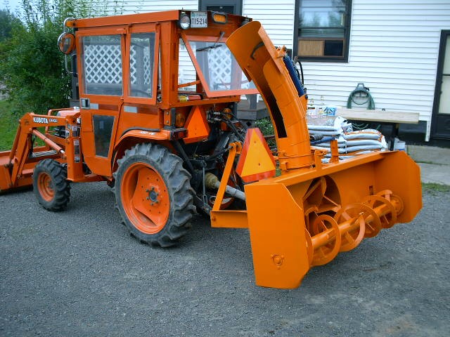

60" may be pushing the envelope a bit (3.2HP/ft. of width), but, as dwenham says, with HST it can do it. I run a 72" blower on my B7800 (22HP @ PTO, 3.66HP/ft. of width) with absolutely no issues re power to throw the snow. I don't know how slowing your RPM's would affect its performance, though. I always run the blower at 540 RPM. I have to clear a lot of tight spots and I wouldn't be without the powered deflector.
