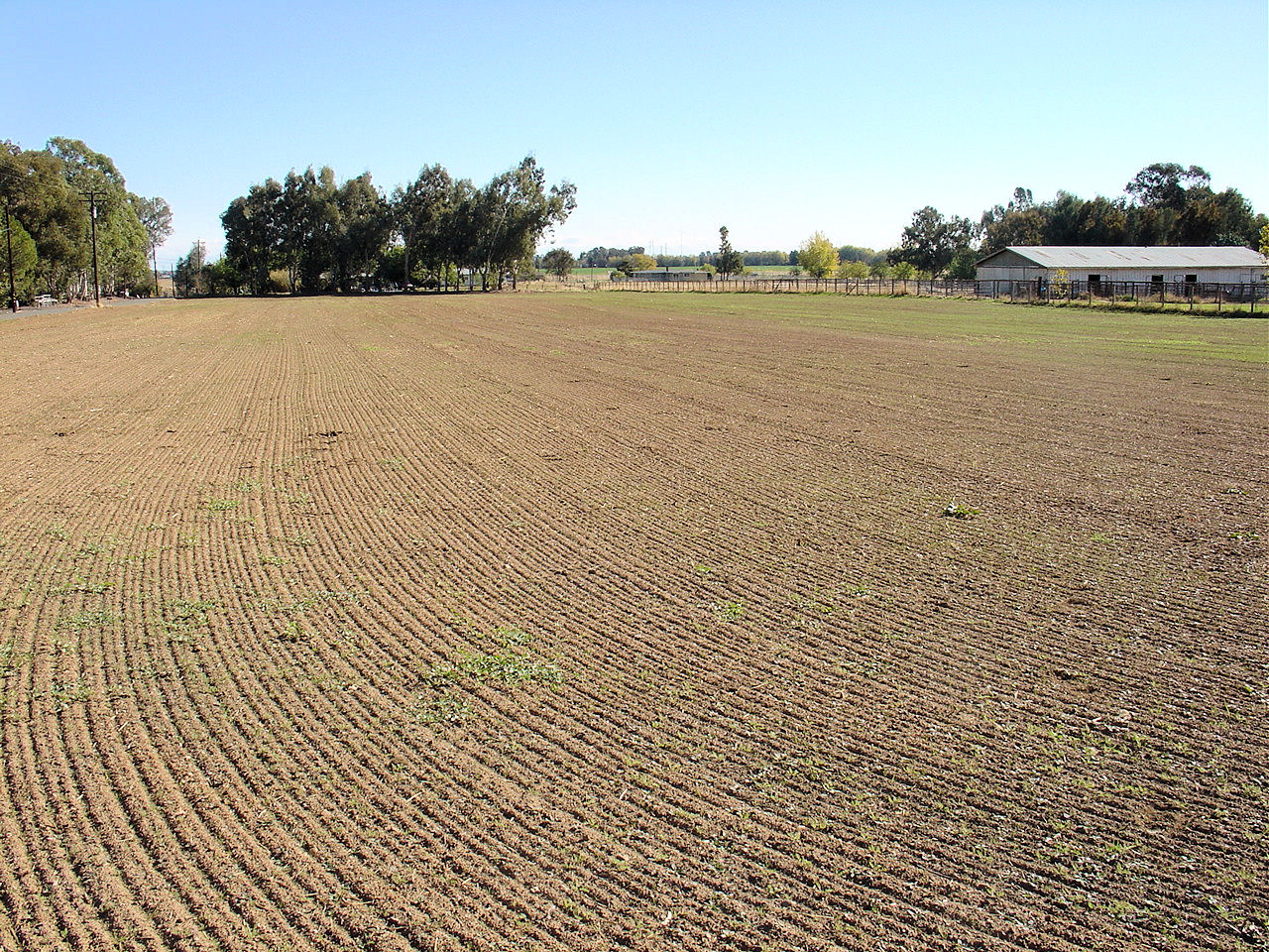

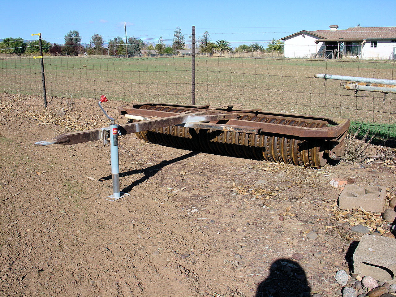

I'm guessing that you want something like this:
There is no way to get it with a one-pass discing and a one-pass dragging.
First, you have to get rid of the foliage debris. That can be done by discing, wait two weeks, disc again, then once again in a week.
The next step is some sort of drag. I took an old beat-up spring harrow and welded a 6" drill pipe to the front of it and a very heavy logging chain to the rear. It is ugly as sin, but works very well at breaking clods and leveling in a couple of passes. (I once tried chain link fence on the bottom but it soon broke and wadded up.)
Finally, a cultipacker is used to compress any surface rocks into the ground and make the whole field look raked.

I'll get some pics next time I disc. Alot of great ideas and I am still learning so it is appreciated. I have seen alot of locals running a ring roller (?) behind the disc, but for the life of me I cannot find anything about them other than on craigslist. I'm guessing its actually called a cultipacker maybe. I totally believe its gonna take more than 1 or 2 passes to get a nice clean seed bed. I'll be researching more, based on the ideas posted. When I have time. lol I just picked up a new flail that I'm rebuilding so discing will be on the back burner for a bit...........
