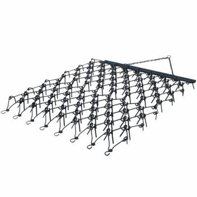

Could you disc and then use this from Tractor Supply to smooth everything out??
After the seed is down, could you flip this over and go over the seed again to get it in the ground?

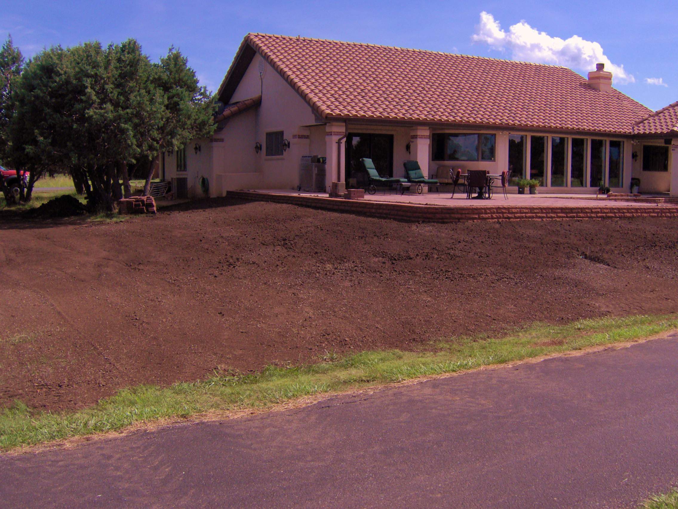

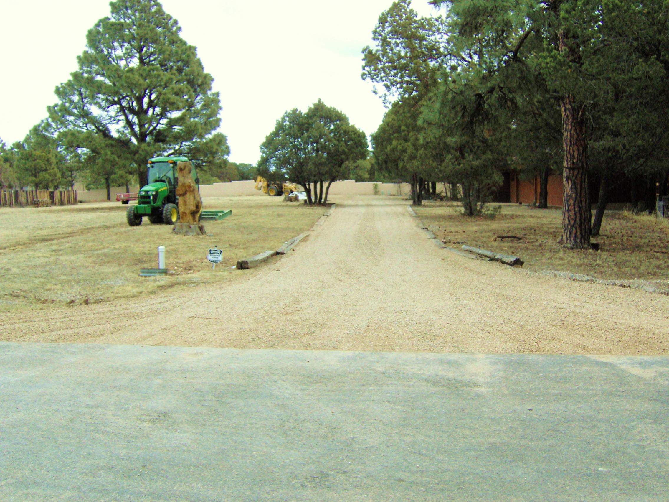

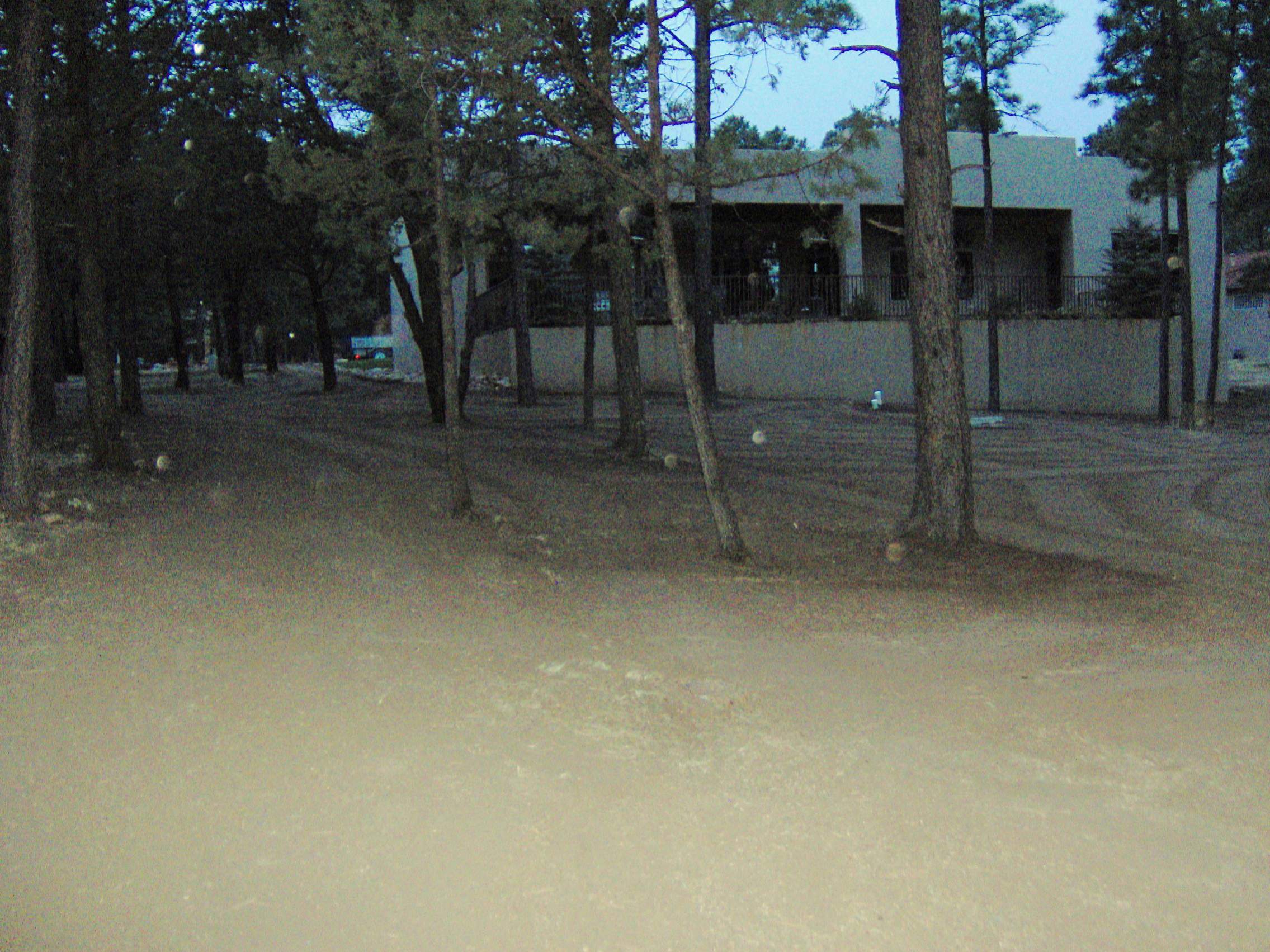

Thanks for the kind words, I live in Ruidoso New Mexico at about 7000 ft elevation. I have Tall Fescue that is green about 9 months of the year. Here are some pictures of the landplanes and harrow I built to smooth out the erosion ditches and stump holes. Both are 8' wide and cost about $1150 to build both tools. The last three pictures are of customer projects that the landplane was used to smooth out.
