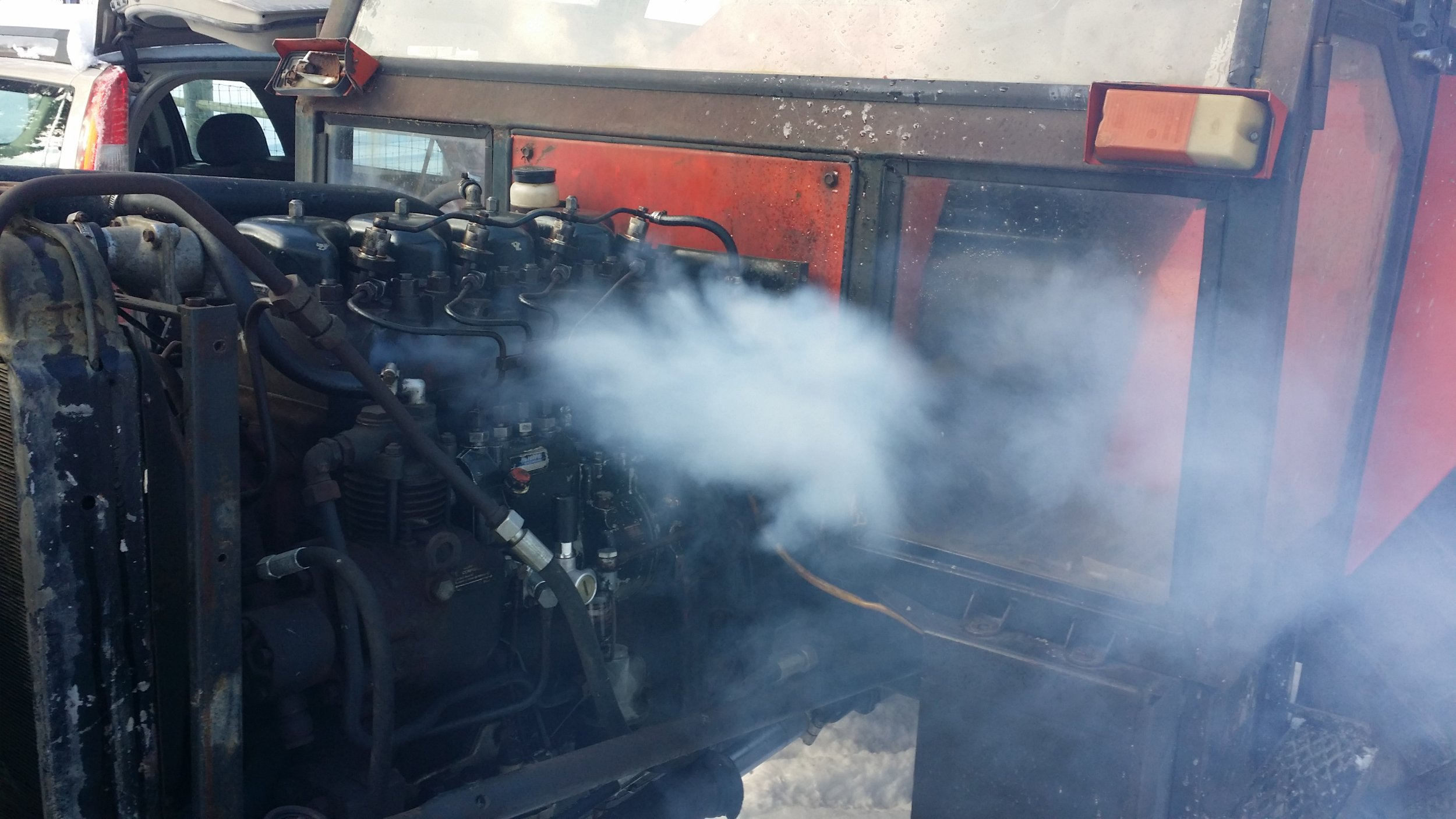

I have saved a Zetor 7045 from a farm where it had been sitting outside for over 20 years. The hour meter shows 2122 hours. The engine was seized, which was expected.
I have replaced the cylinders and pistons and the valves, I have ground the valves/ seats.
The injection pump is tested and adjusted and the nozzles are new. This was done at a certified diesel shop.
The tractor starts but smokes heavily, white smoke, not consistently on 3 cylinders. Three of the four exhaust ports are wet, one port looks fine (the port not smoking). The compression test shows over 300 PSI at room temperature. A test with a different tester showed 232 PSI at 21* Fahrenheit.
I have switched injectors from one cylinder to another, and the smoking stays with the cylinder.
I have been trying to locate this problem for over a year now. It would be nice to use the tractor this spring for planting.
I have no idea what is causing the 3 cylinders not to ignite correctly.
Now I am thinking that the valve springs might have lost their strength. I discovered that I can push the valve down by pushing on the spring retainer cup with my hands. This seems odd.
What do you people think?

White smoke is usually unburned fuel caused by low compression, a "cold" engine, bad injectors, injection pump out of time. In your post you stated you covered the radiator and once the engine temperature went up the smoke just about disappeared. Is there a thermostat in the engine? Is it functioning properly? Also have you rechecked the injection pump timing?
From what I have read of the posts I would be inclined to believe it is too cold. Most diesels do best running on the warmer side.

White smoke is generally associated with low compression, retarded injection timing, or low cetane fuel.

I have a 5745 and done about the same job as you did, although mine was not seized It definitely is surprising that you can compress valve springs by hand. Remind me to never shake hands if we meet. Why don't you try and compare that with your 8011?
When compression testing, the rpm's are low, so even weak springs have enough time to close the valves and therefore you will see a high compression. When the engine is running, the springs may be too weak to push the valves back in time for the higher rpm's so you don't reach that high compression. The valve play seems to be correct; otherwise you would not get such high compression figures.
Some thoughts. The pick-up of the thermostat is located in the cooling exhaust of cylinder 4, immediately behind the cylinder head. If you get a running temperature of 70C or even less, that can have two causes; one: the thermostat is not closing (here less likely, if I read what you said about the radiator), and two: there is no or hardly any combustion in that cylinder. The UR1's do not have glow plugs, so because of incomplete combustion they smoke a lot while they are cold. Combine that smoking effect with the low temperature and the weak valve springs, I agree with those that blame the springs. Weak springs -> loss of compression -> incomplete combustion -> cold and smoke. You most probably will be missing a lot of the 70 horses that should come out of those 3.6 litres.

One more thought: if the engine runs, the inlet springs seem to be OK; otherwise it would blow back hard into the inlet. From the picture it seems that only the outlet springs are weak and springs do not go weak from being compressed. A botched up repair job and therefore the reason to ditch it so long ago?

Just an fyi. On every diesel engine that I have ever bothered to check, you can compress both the intake and exhaust valves by hand. You don't need a lot of strength either. Just push down on the valve with the heal of your hand.
I'm also in the camp that thinks the problem is the thermostat. That engine needs to run at 90C/195F or more to properly atomize all the fuel. Good idea to close off the whole radiator to try and get the temps up.

Coolant entering the combustion chamber?

It is not coolant.
It is for sure unburned diesel. I am now waiting for the new valve springs and nicer weather.
If the new valve springs don't help then I will have the heads done again, or I will buy the seat cutter to do it myself.
