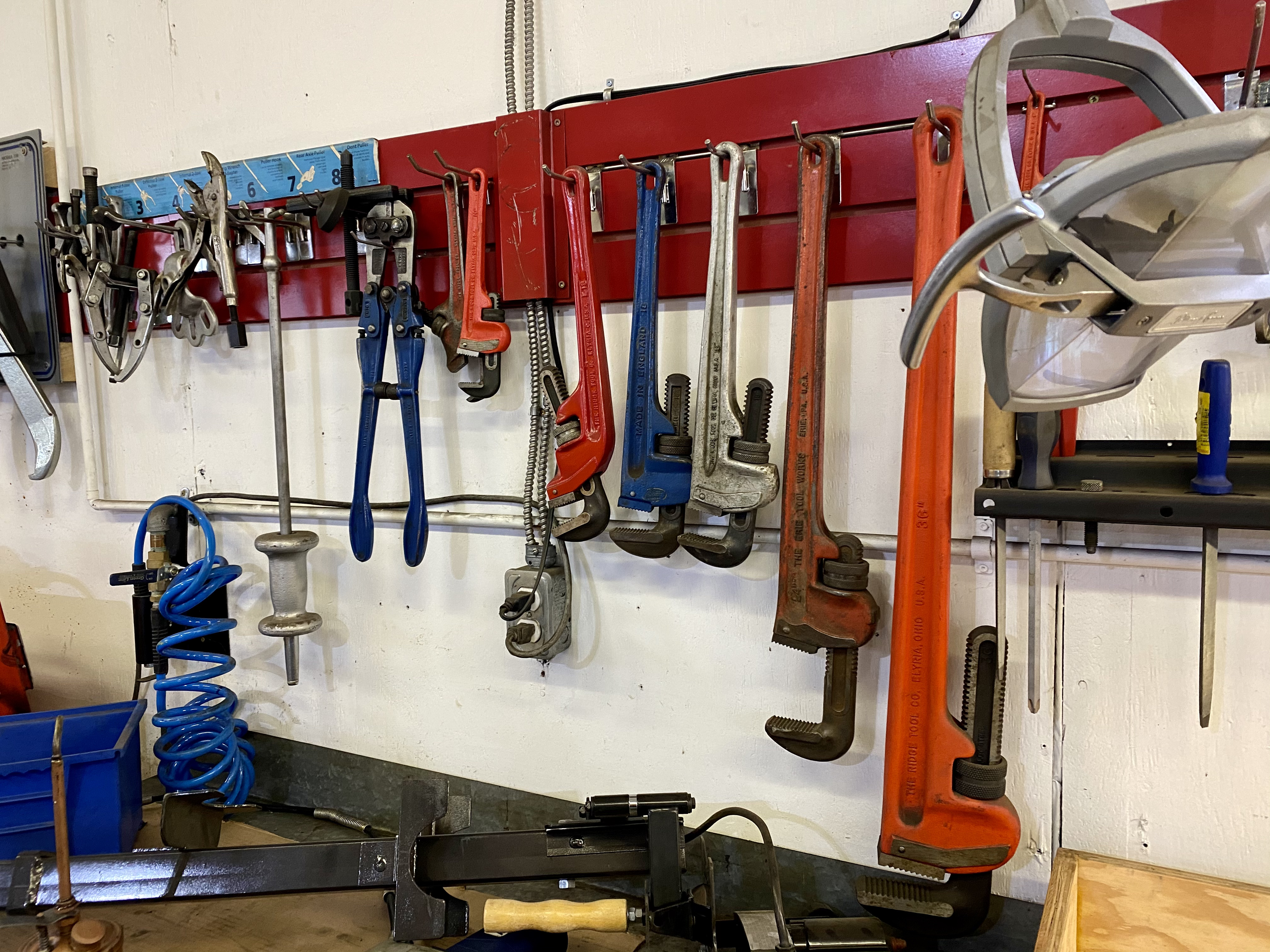

I don't have a picture but pipe wrench holder (actually storage) I think about at my home place all of Grandad's adjustable wrenches he mounted a board on one wall with 2"x2" blocks either end. All wrench jaws hang from it.
Pipe wrench storage is pretty easy for me as all handles have a hole in the end of the handle.

Are your blue and red zones getting mixed up? I see a blue bin and air hose in the red zone.:confused3: :D
Always a smart ***** in the mix.
/ Smart Shop tips! #508
Nice dodge, Terry. We know you're color blind. :D

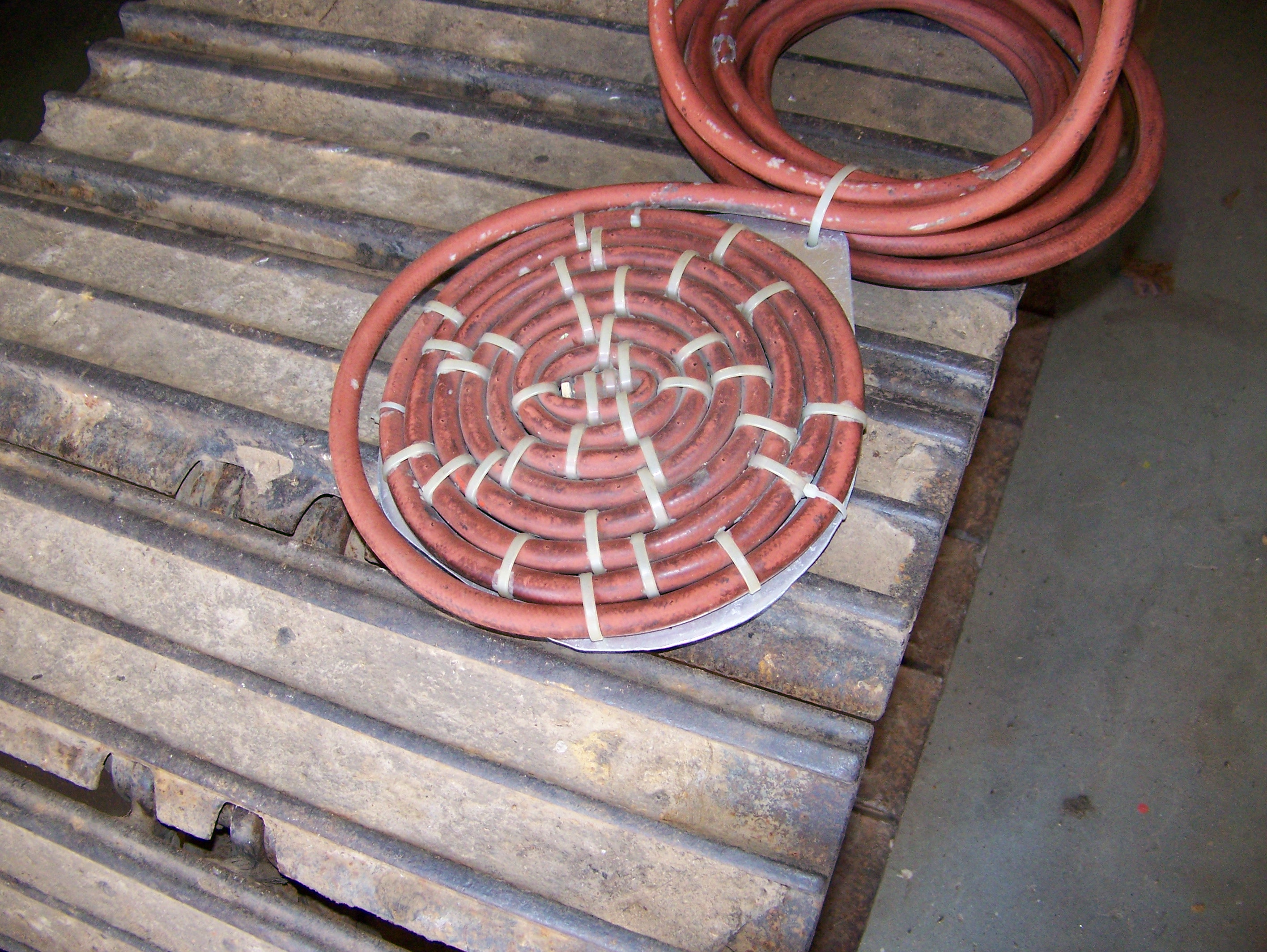

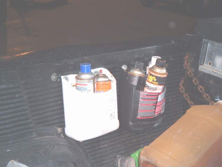

Working in the hot baggage bins and cockpits, I coiled up an air hose in a tight coil. I ty wrapped (zip tie) it to an aluminum plate to secure it. It was about 12 foot long. I then drilled little holes into the top side of it about every inch or so. Plug it into an air supply and I always had fresh air blowing on my face.Air Hose Fan.jpg

Working in the hot baggage bins and cockpits, I coiled up an air hose in a tight coil. I ty wrapped (zip tie) it to an aluminum plate to secure it. It was about 12 foot long. I then drilled little holes into the top side of it about every inch or so. Plug it into an air supply and I always had fresh air blowing on my face.View attachment 685164
hugs, Brandi
very creative idea... love it!
