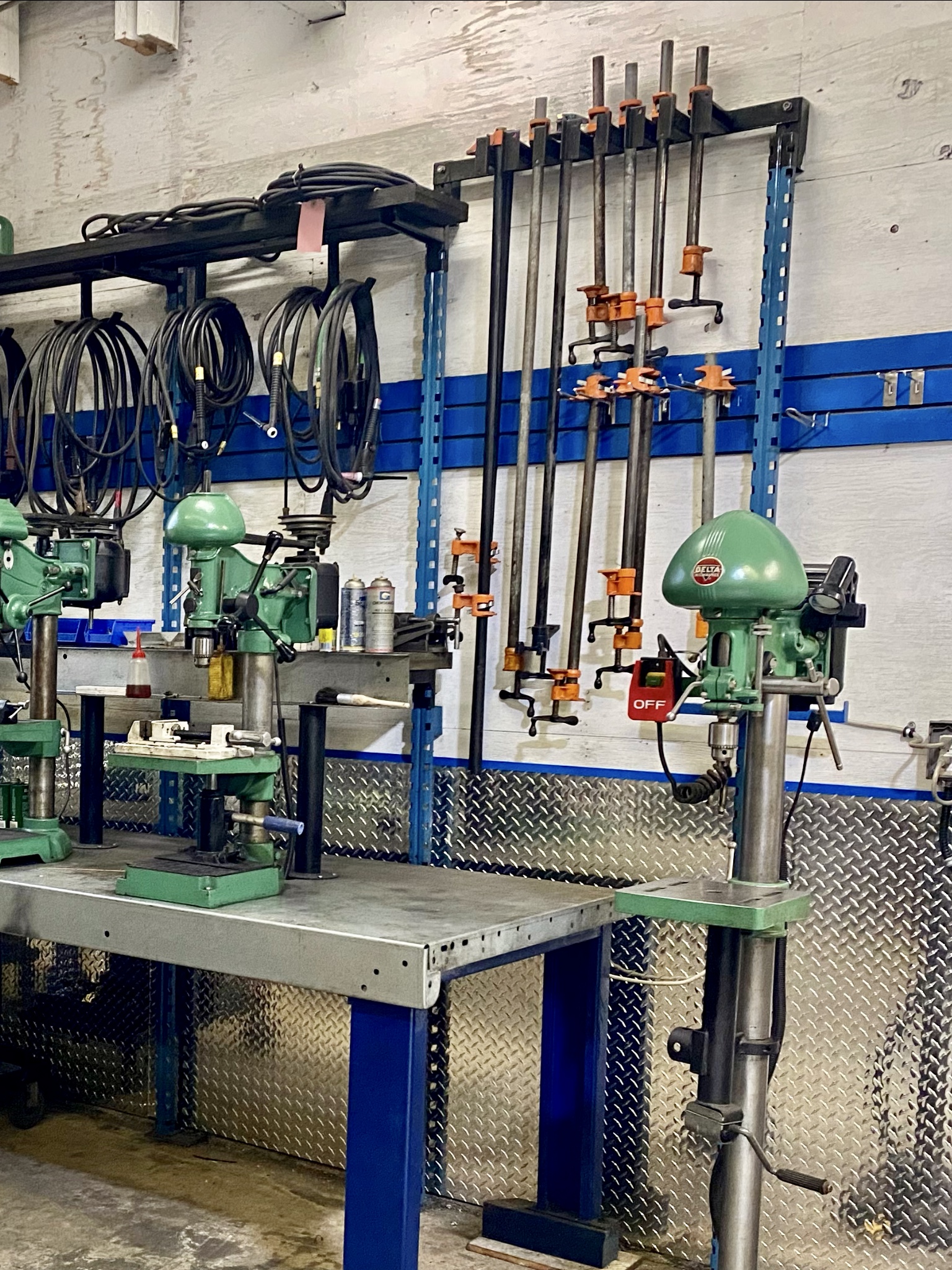

Hey nice shop. :thumbsup:
I have the same drill press minus the mods.
I’d like hear about your mods to your drill press.
No fancy mods. Just added a hydraulic bottle jack to one and a trailer tongue jack (side wind) to the other for table lift assist.
/ Smart Shop tips! #479
I didn't even notice the other drill presses.
However, what caught my eye is the switch on your floor model.
My drill press is like that one, but the switch is damaged and I'd like to find a nice replacement switch like yours.
The trailer jack is a great idea!!
/ Smart Shop tips! #480
Those paddle switches are available from Amazon, Grizzly Tools etc.
Here's a closeup of the trailer jack if that helps...
