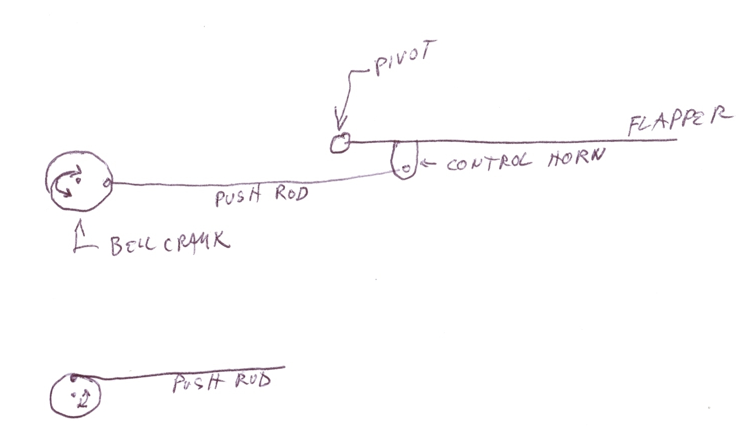

Red Dirt, I'm sorry if I led you astray. I have no drawing or completed design but while reading the post to which I replied a couple methods came to mind.
One was a cam and the other was a bellcrank and control horn with pushrods.
First the cam: if you cut out a steel cam to be attached to the bucket and have the cam follower actuate the flapper then the cam can be flat until slightly before the end of travel of the curl. Then as you begin to reach the end of travel the follower will ride up on the slope of the cam and activate the flapper. This would probably need a spring to keep follower in direct contact with the cam and to keep the attached flapper out of the way till the curl action energized it.
Bellcrank and control horn approach:
If the curl action moved a pushrod connected to a bell crank and a second pushrod connected to the bellcrank activated the flapper with a control horn then adjusting the radii of the connections of the pushrods and the location of the bellcrank and length of the control horn would allow you to essentially get only a little motion from the output pushrod until the bellcrank rotated quite a ways through its travel and then when the proper geometry was achieved the output pushrod would rapidly start to actuate the flapper connected control horn.
Since my bellcrank description may be less than complete, concise, and communicative I have included a sketch to completely eliminate any ability to understand my meaning.
In the sketch you can see that rotary motion (bucket curling motion) when moving the attachment point of the push rod in the upper portion of the sketch will not move the pushrod very much from about 2-4 O'clock position. Note in the lower partial sketch just showing bellcrank and pushrod with the attachment point of the pushrod at or near the 12:00 position that the pushrod will be moved the most.
By adjusting the radius at which the pushrods (both at the bellcrank and the control horn) are attached you regulate the angular to linear motion ratios which as seen in the drawing are non linear. Of course you would want the least range of motion of the bellcrank on the flapper to be in the range of rotary motion when the curl was not to near the limit (when you want the flapper to expel dirt)
I have built mechanical systems just like this for non-linear rotary to linear to rotary motion conversion but NOT A BACKHOE BUCKET. It was to apply elevator control for an airplane.
I suspect the equipment already doing this sort of thing has worked out all the design issues and would be a far better starting place than my brute force and awkwardness.
Pat

/ smaller backhoe bucket #28
Pat, thanks for the sketch. You've given me some ideas I'll need to chew on when I have more time. I kinda like the cam concept; less moving parts in a confined space. Maybe I'll start a design/build thread later on an "ejector bucket" as charles' fine work is beyond this point and this ejector stuff is getting off his topic.

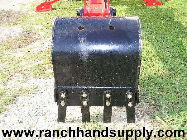

RedDirt said:
For the suction aspect would drilling several holes in the back of the bucket help relieve the suction? I'm thinking 4 or 6, maybe 3/8" dia holes.
My hoe has these holes drilled in the bottom of the standard bucket (pic attached).
I'm still considering buying the 8" trenching bucket.

Didn't have any Pam in the kitchen, but the ingredients on our other nonstick sprays list canola oil as the primary ingredient. I guess I could buy a quart or two and spray it on with the garden sprayer.
I remember reading once to spray plows with vegetable oil after use to keep them shiny and from rusting.
/ smaller backhoe bucket #37
Around here, those holes in the bucket would let sand out faster than you could dig it! Guess you better make sure of what your digging before drilling.
David from jax
/ smaller backhoe bucket #38
David from jax
Good point.
/ smaller backhoe bucket #39
shvl73 said:
Good point.
I would drill the holes and then have a plug made that I could bolt on. Basically something like and very big carriage bolt, with the head inside the bucket.
Wedge
/ smaller backhoe bucket #40
