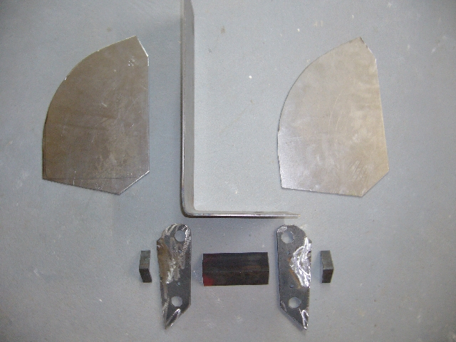

My Kubota b7100 came with a b670 which had a 16" bucket. I have a fair amount of sprinkler line to put in and I decided to make a smaller bucket. I read some of the posts on here concerning dirt sticking in the smaller buckets but we don't have clay so I think it will be OK. Also, I could just rent a trencher but what fun is that? ;)

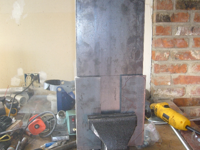

I made templates from my original bucket, here are the materials, one bucket side already cut out:
I used the pieces for the 'ears' to help make the 90 angle that is at the back/bottom of the bucket.
Both sides now cut out, bottom bent, 'ears' made. I cut the sides with some Harbor Freight metal cut off wheels in my angle grinder. Worked pretty well and used about 1.5 of them :)
The original bucket and one pin had a wee bit of wear so I made a new pin. I thought about reworking the bucket to use collars on the ears and longer pins. I figured if this is what 30 years of use does the original design would probably work for me ;) The holes in the original bucket were out of round about 1/4 inch on one side, some quick work with the welder and they were close to new.
Everything tacked together for a test fit on the tractor. It fit perfectly.

The original bucket is made out of surprisingly (I thought) light materials. The sides and bottom are 1/8 inch plate, the ears are 3/8 plate and for the angle bracket across the back I used 2x2 by 3/16. I couldn't find any references as to these parts being made out of anything other than mild steel so that is what I used. The cutting edge wraps around a little on the sides and ties the whole thing together.
I used a local place that is one of the Metal Supermarkets stores. They cut everything to the right length etc. with only one $5 shearing charge. Obviously your mileage will vary based on your particular hoe but here was my cut sheet:
(2) 1/8" plate 10"x14" (had to be sheared out of a sheet)
(2) 3"x3/8" bar 9" long (something was a little off with my measurements.. probably really needed 4"x3/8" but I made it work)
(1) 2"x2"x3/16 angle 5-1/2 inches long
(2) 2"x2"x3/16 angle 3/4" long
(1)1/8"x8"plate 25" long (need more like 24" but I wanted some room if my bend ended up wrong or I measured wrong... it's easy to cut off)
(1) 1"x7-3/8" 4130 round bar for the pin.

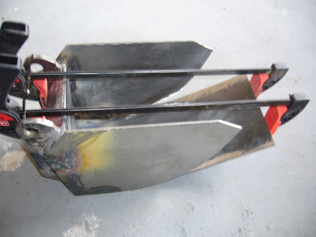

Had a chance to work on this some more today.
I thought I would give bar clamps a try to bend the bottom to fit. I drew a line on the inside of both sides as to where the top of the plate should be. On the big bucket the sides extend past the bottom about 1/4 inch. Sorry its at bit out of focus, didn't realize that until I downloaded the camera. The alternate method was going to be to mount the bucket on the hoe and then use the hydraulics to press it against the ground and bend the plate. With the clamps I didn't have to crawl around on the ground :)
Worked the clamps alternating sides... it was tough going sometimes. I tacked at little more than one inch intervals. When I got to the end I couldn't get it to bend in much. Looking at the big bucket I realized the end slowly tapered out until the bottom was flush with the edge of the sides. Makes sense as the cutting edge sits on both and is welded to them. Bending it in that much was easy.
Went back and slowly welded all the spots between the tacks.... Hard to weld inside the bucket but I did manage to duplicate some of the not-so-hot-looking welds on my original bucket ;) Notice the extra 1" of material I added to the bottom plate is there at the end... looks like I didn't need it after all. I will wait to cut it off until I have the cutting edge in hand.

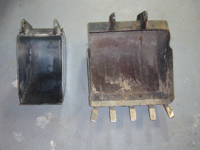

Here is a pic of the new bucket next to the 16" I am using as a template.
Looks like I have better get on the stick and order the cutting edge and find some teeth!

Great looking work. There are lots of places to get the teeth as well as the cutting edge. I have never priced lengths of cutting edge, but I wonder if using plow shares (~$14 or so for 16" length) would work.
/ smaller backhoe bucket #11
I'd try it without the teeth first. You may find that the narrower bucket likes to cut in on its own.
