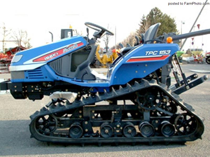

I would LOVE to have one of these. I can't find anyone bringing one in. It is too small for you , but just right for a lawn toy.
Thanks for this information. I will more into it.:)
