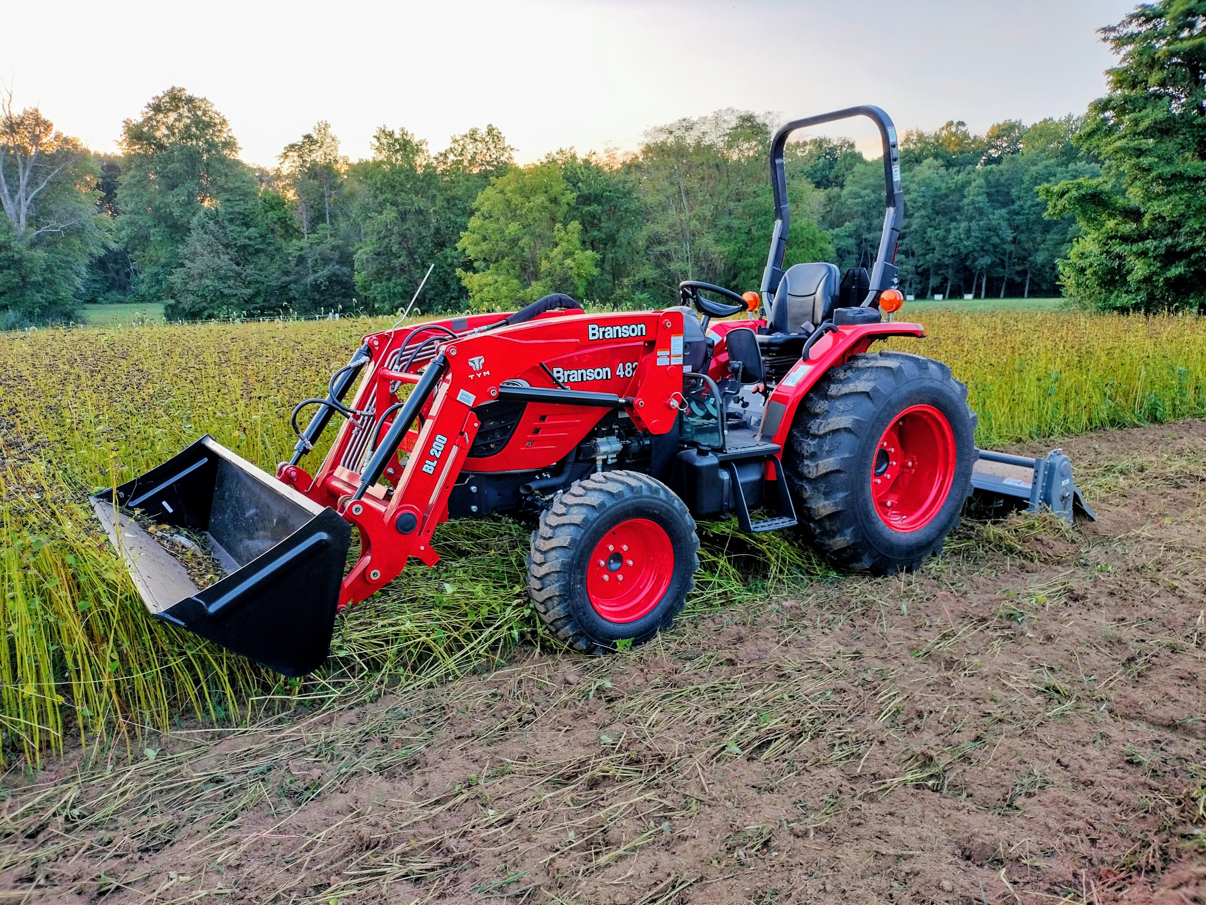

I grow a couple acres of buckwheat per year. I cannot fathom the work involved in hand threshing 1/4 or 1/2 acre. 🤯. You are talking over 500 pounds of seed!
How do you harvest your buckwheat?
/ Small (tiny) combine - pull type - for grains? #22
Right now I don't, I till it under to self seed. One acre requires 100lbs to seed, but will produce 1000-1500 pounds per acre. Plenty of small, older combines around here that could do the work though.

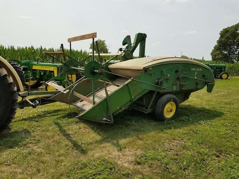

When we lived in Upper Lake, there was a vineyard/winery across the road from our friends on Tomki Rd in Redwood Valley that planted wheat between the vines for crop/harvest/cover and I think they were going to sell breads, flour, or make Whiskey?
Frey Vineyards in Redwood Valley, CA.
They had a mini combine that would fit between the vines.
They got hit real hard by a forest fire about 8 years ago and lost most of everything so I'm not sure if they're still doing the wheat thing.
I'm trying to post a picture of them and their little combine.
