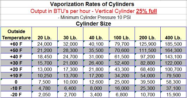

I found this chart:
So smaller tanks give more capacity per pound of propane, especially at lower temperatures. Three 20 lb tanks roughly equal a 100 lb tank.

Thanks. This is incredibly helpful, really gets to the question I'm asking. So a bigger tank does give better performance.
Cooktop is 50K BTU -- five burners, one 16K, three 10K, one 4K.
625854d1571886357-small-scale-propane-qeudt9u9_o-jpg
The vaporization chart shows btu's for 1 hour with a continuous withdrawal.
An intermittent withdrawal could operate a larger load.

That's a handy chart Tiller. One can use it to size tank and appliance for emergency back-up based on expected low temp. If back-up is critical such as room heater for the elderly,I urge people to have professionals set it up. As ambient temperature fall's below 30F and/or gas consumption increase's,the possibility of complete system shutdown is a reality. The risk can be dramaticly reduced by experienced installers. U-Tube and forums ARE NOT substitutes for classroom and field training.
/ Small Scale Propane #34
If you really need lots of vaporization and it's cold outside, there are heaters specifically for increasing the vaporization rate. You'd definitely want a pro to install that.
