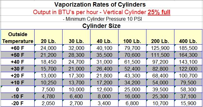

I have exactly one propane appliance, a cooktop, the oven is electric. When I bought the house there were two 100lb tanks out back, which were rented, and I just assumed the rental. The first few years the propane company would come out once a year, top up the tanks and inspect them. Because I use so little it was included in the service call, it would cost about $40/year. After a few years they said they wouldn't do that any more, they would only fill the tank when it was empty, I should call them.
A couple months ago I thought the cooktop was burning low, so I called them. It took them four days to come out! And when they came out it turned out the tanks weren't empty. They also said that from now on they aren't serving tanks below 250 lbs, and wanted to sell me a 250 lb tank. I feel like we're going in the wrong direction. I want smaller tanks, the ones I have now are big and ugly. I looked at my checkbook and the last time they were out was in 2014, so I figure we're using less than 20 lbs a year.
I'm thinking of just getting rid of the rented tanks and buying smaller tanks. A 20 or 30 lb tank would fit under the deck out of sight. It would also be something I could take to the hardware store to refill when it was empty rather than waiting four days for the propane company to come out. I'd probably get a pair so I always had a spare.
The cooktop has a rated capacity of 50,000 BTU if all burners are going. While we rarely/never use all the burners, I'd like to be able to supply it. Any special considerations for the regulator?

Get two 20 pound cylinders and an RV type regulator. The tanks will switch over automatically, and you get a red flag that one has gone empty. This way you'll never get an interruption in the gas supply.

100lb tanks with the multi fill valve that the propane truck can fill are $150 that may be your easiest option once you find a new propane supplier.
Are you sure your cook top is 50kbtu? If it is thats with all burners on and on high.
Fo arguement sake lets say your normal use isnt more than 25kbtu. A 20lb tank isnt enough in the winter still. Its hardly enough at 60*. Going upto a 30lb tank dosnt really help much. Also at the price of two new 20lb tanks your about $50 shy of just getting a 100lb tank that will vaporize in a way you need for your max of 50kbtu.
If you do get two smaller tanks get 20lb ones. The way i see it i buy them once and exchange when old to a newer one and the cycle starts again.
Take a look at this propane cylinder vaporization chart.

Thanks. This is incredibly helpful, really gets to the question I'm asking. So a bigger tank does give better performance.
Cooktop is 50K BTU -- five burners, one 16K, three 10K, one 4K.

I have an RV with 2- 30# propane tanks and a 36k btu heater, in the winter in central Texas I go thru a tank in 2 to 3 days. That's a lot of area exposed to the cold with only 1.5" insulation. Since you're only running a cooktop off your tanks, they'll last a whole lot longer. The point being that you're not drawing much and will last awhile. The outside temperature and shape of tank is important for vaporization, there are charts that can tell you the BTU rate of vaporization for temperature and tank size. (The vaporization rate changes based on how full the tank is.)
It is theoretically possible to determine how long a gallon of propane will last when you run your cooktop. If we assume you run 2 of the 10k burners full on (not likely) for a half hour each day that's 10K BTUs per day. Propane has 91,502 BTUs per gallon, so you could run your cook top for 9 days on one gallon of LPG. A 20# tank (if it's properly filled) has 430,270 BTUs and would last 43 days.
