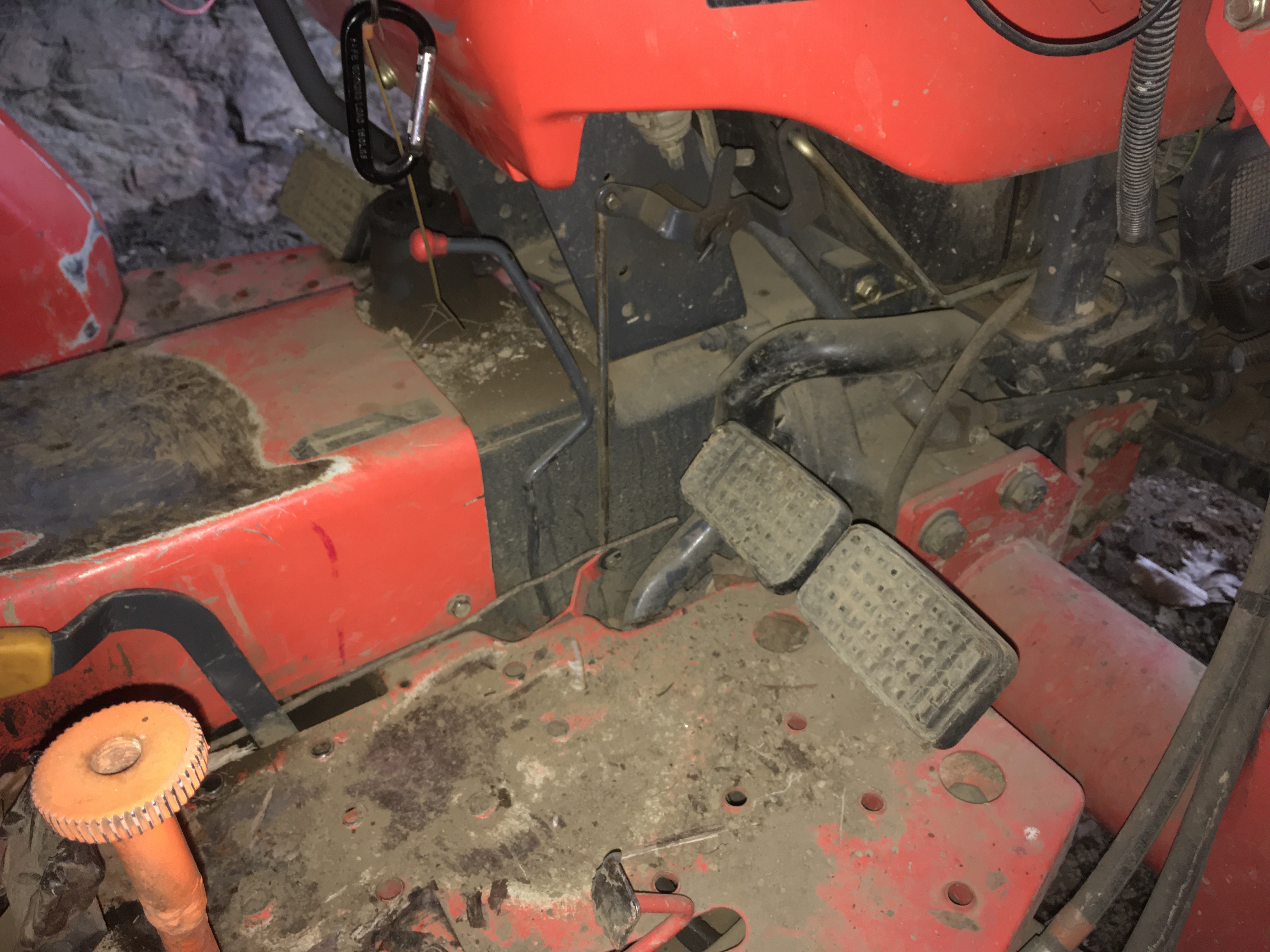

Kubota is an international company. Rules for lighting on roads vary. Also upgraded features on some models. Worth looking for unused brackets or threaded holes. Sometimes part manuals show optional equipment.
On the B26 under the dash was a nice bracket with hole coming off the steering column. Don’t know the intended purpose. It was perfect for a rear motorcycle switch to connect to the parking brake linkage with no modifications.
A friend who thought his wife would still try to operate the tractor with the parking brake on, warning light on, tied into the HST pedal safety switch to shutdown the tractor if tried to move with parking brake applied.
/ Small improvement for L3400
#23

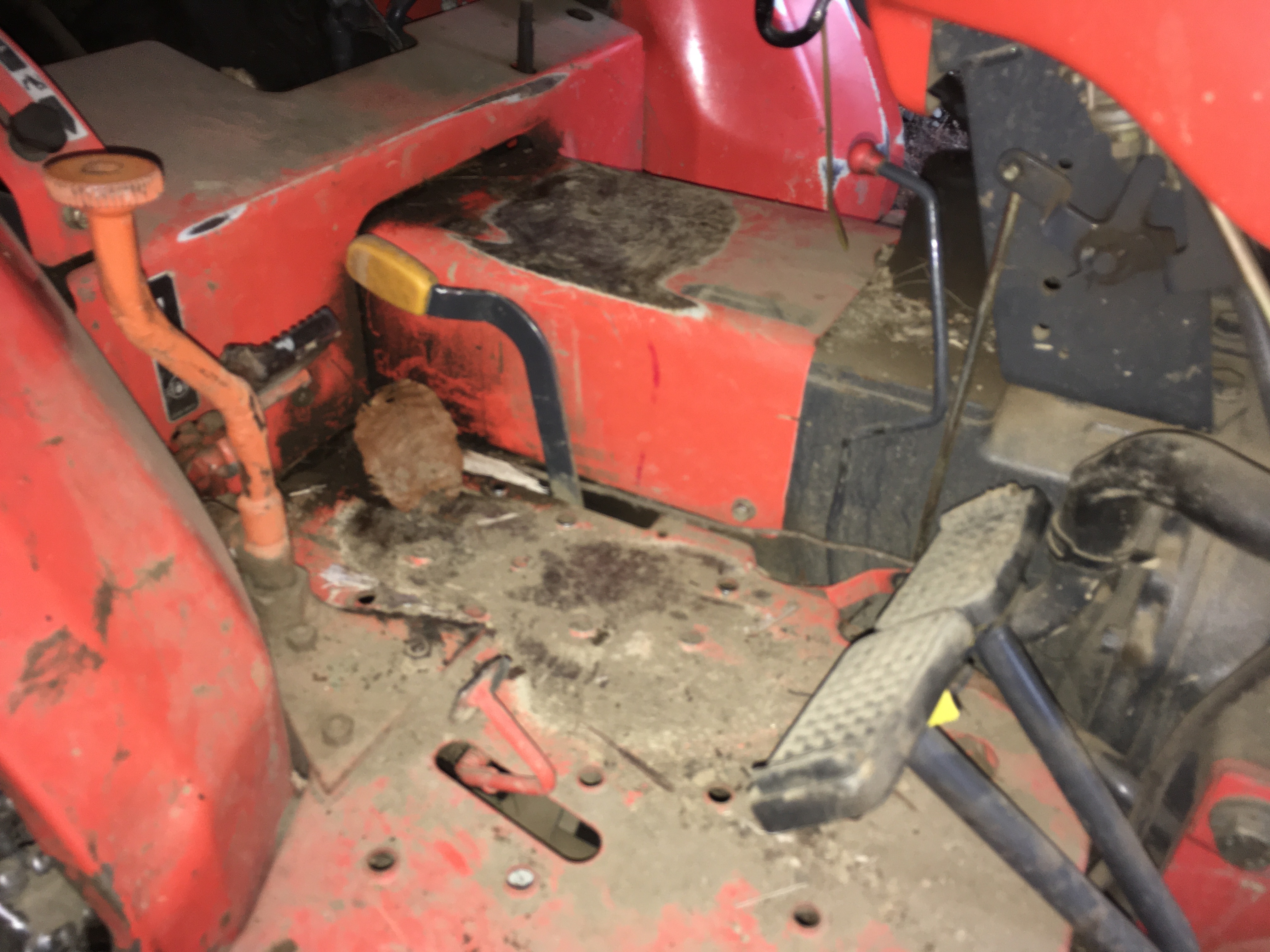

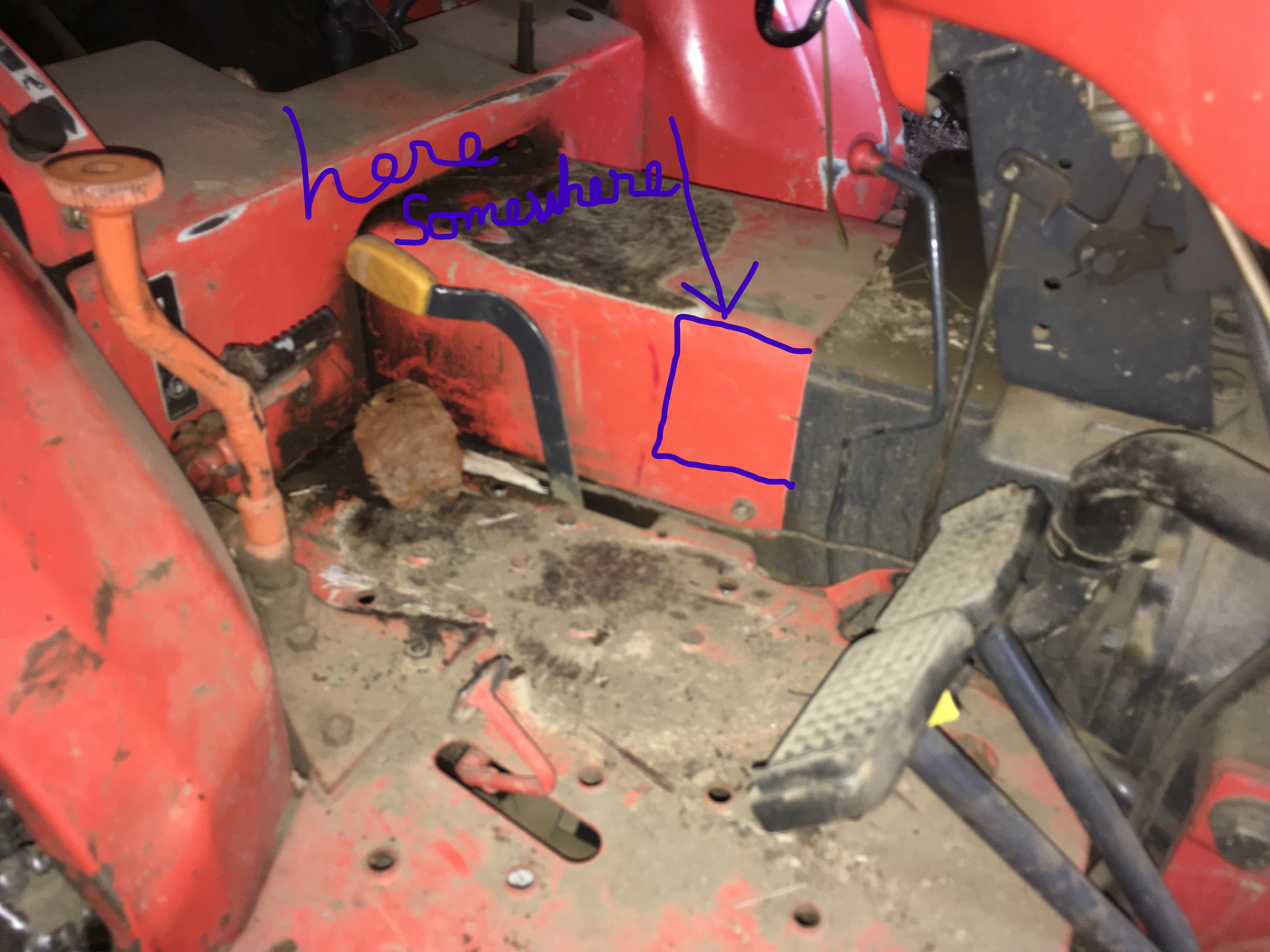

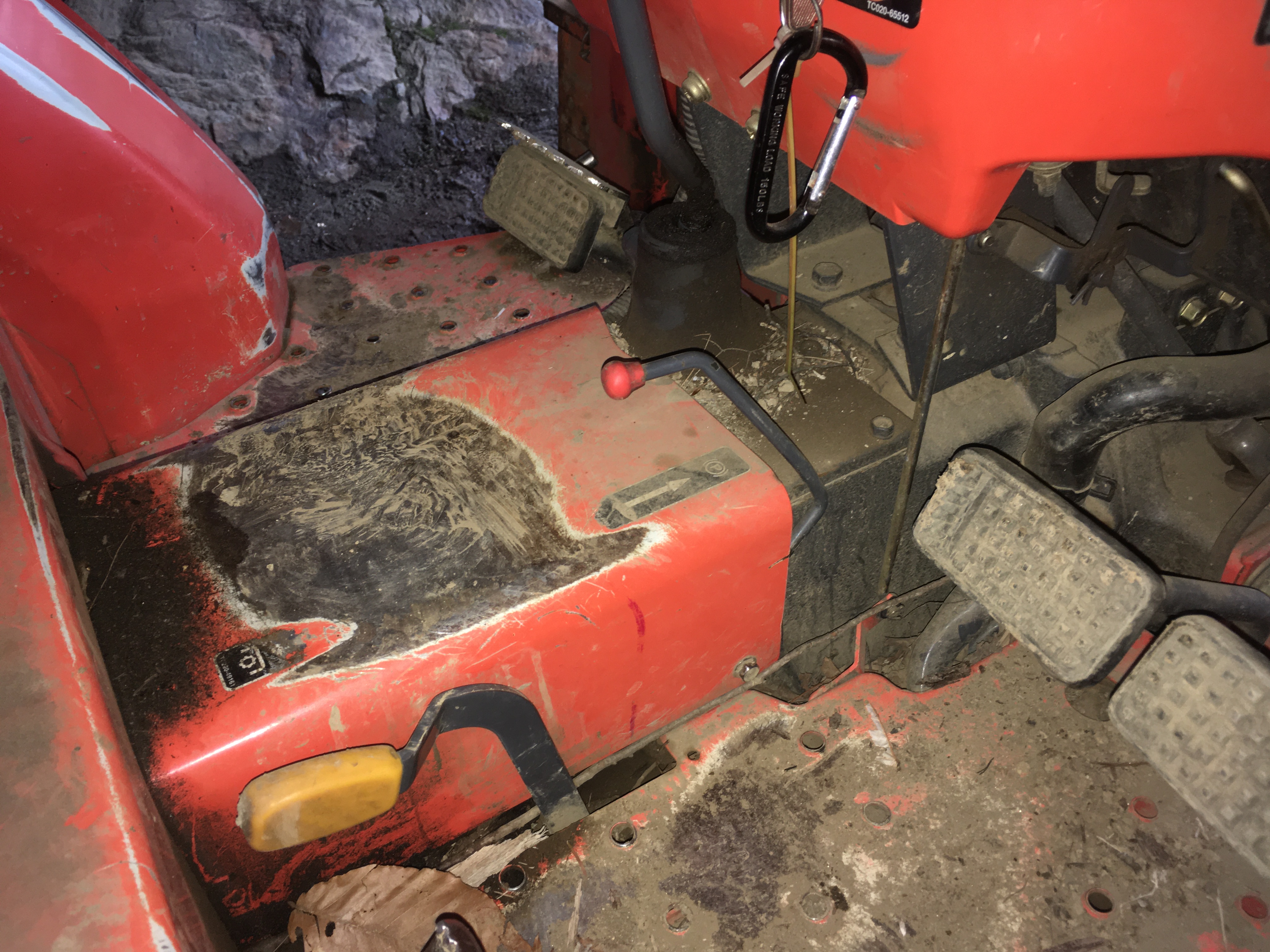

Oldpath and others- I mounted my switch on the inside of the gray cover plate on the side of the red-knobbed lever that you push forward to engage the parking brake. Oldpath doesn't seem to have that plate on his tractor, though. I wanted something simple, and out of the wet and dirt areas. The engagement point of the lever isn't precise- it can vary a little according to how hard you have pushed the brake pedals, and the springy nature of the arm on the micro switch accommodates that nicely. All I can add is look at my photos again? The first photo shows the inside of that gray plate, off the tractor. I took some measurements to locate the switch- like I said, it doesn't have to be precise due to the springy nature.- just so the switch stays engaged when the lever is caught and the brakes are on.
/ Small improvement for L3400 #24
Oh your right that's what throwing me off, I dont have that grey cover plate, must be the HST difference. Anyhow I need to back up a bit, I dont want a glowing light for a brake light, I want a blinking light for a brake light, a blinking light gets my attention everytime, so now I'm back to square 1-1/2, let alone what to do about that grey cover.
#25
I still haven't used the tractor yet, but I think the red light is bright enough I'll notice it? You can probably fabricate a bracket to hold the switch and mount it on the tunnel cover... or with a long flexy wand, stick it under the dash, since the micro switches take almost no force to actuate. With the gray cover, mine was an easy job.
