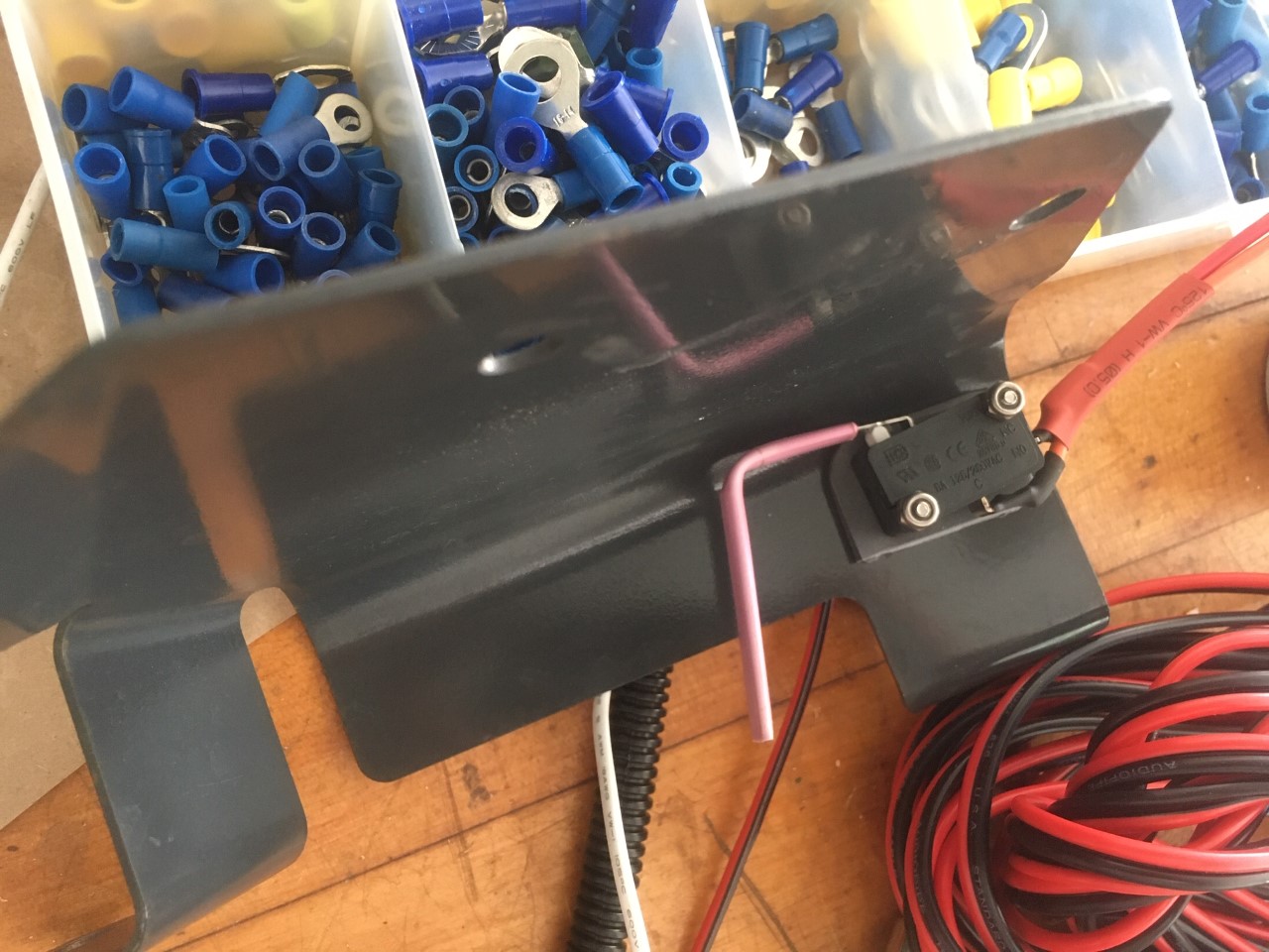

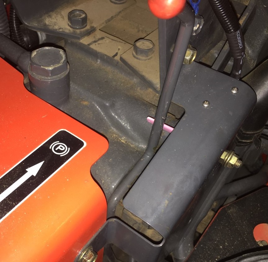

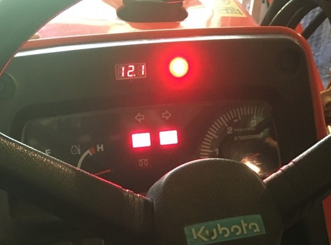

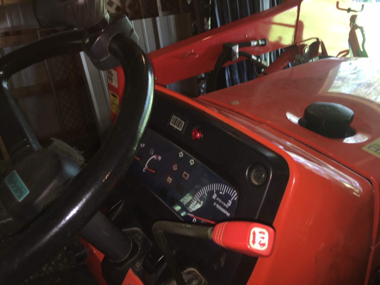

If your like me, you probably have a lot of time on your hands these days. One think about my L3400 that bothered me was my tendency to apply the parking brake to prevent creep, and then to forget to release it. No big deal, but in low range, you can travel a bit before you have the "dah!" moment. So, I found a micro switch and a spare LED indicator light in my junk collections, and wired up a warning light for whenever the tractor is running and the brake is on. Who knows, it may get old having a bright red light on, and I haven't used it yet, but we'll see. Here're some photos showing the switch installation, in operation with the brake pressed, and so forth. It's not really as bright as in the photo, but it is visible. Sorry for the crappy photos, but it's been raining and the barn lights are minimal.

It’s bright and obvious! Wife picked the color (purple, probably the color of my face!) and no more discussions about operating with the brake on. Much cheaper than marriage counseling.

Yup- its a "manual" micro switch, which is activated by depressing the brake pedal, and it is wired so it's hot only when the tractor is running. See the first photo to see the switch, its wiper arm attachment, and how it's mounted to the cover plate from the brake assembly.

To the original poster, I think with the addition of the voltmeter and the parking brake switch, you have made some really useful additions to your tractor. Good work. I added the voltmeter to my Kioti, it already had a parking brake reminder lamp. The voltmeter is very handy.

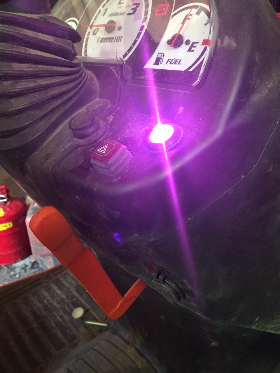

I know HST is a little different but still not quite sure where exactly you put that switch. My first picture is brake off, the rest are brake on.

The rod with red knob the parking brake engagement? Looks like you move it forward to lock the brakes?
Just spit balling here;
Under the center cover as you indicated would be a good place to mount a switch. The motorcycle switch would not well. The OP switch would. Switches are normally open (NO), normally closed (NC) or sometimes have both options.
A common truck plunger switch, NC (normally closed) would maybe work too. The truck brake pedal at rest pushes the switch plunger opening the circuit. Push the brake pedal switch closes and lights the brake light.
So a switch mounted under the center cover that the parking brake rod holds open when operating would work. Engage the parking brake would close the switch and light the warning light. The fun is getting the right switch in the right place. Not too hard but does require some innovative thinking.

You drilled a small hole in that small brake lever,,,,, but the brake lever is already spring loaded.
The switch spring is simply the linkage that connects the switch to whatever, parking brake lever or pedal. Easy way to connect the two together to have “give” and have travel difference. The switch needs 1/4” pull to operate while the handle or pedal might move inches. If they were connected by solid linkage you could pull the switch apart.

Yes the red button lever moves forward a little for brake lock. And yeah the fun of finding allusive right place, but it is hard and thinking hurts. I dont think theres 1/2" room under that cover, the only thinking I think thats going to happen is do more innovative thinking of where to put the switch or what switch, just want to avoid the expensive trial and error..........
