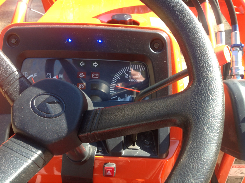

Here are my blue brake lights.

Oldpath, I bought the lights at Walmart, LEDs that plug into the cigarette lighter. I cut them apart, pulled the dash off, drilled two holes, siliconed the lights in and made a bracket to hold a momentary switch against the brake lever. I had to make the fine adjustment using electrical tape. I taped into a hot wire on the ignition switch.
Thanks for the info, I see you hooked up the switch to the brake release lever, that's what I had in mind, but what is a momentary switch and where did you find it or will any switch do, maybe I could take a light switch out the house and try that

Old path, the switch is only on when you press it, any auto parts store will have them. Make sure you find a wire that only has power when the key is on.
/ That dang parking brake! #19
I used a door switch out of an old refrigerator. Most have 2 switches, the fan switch turns on when the button is pressed in and the light switch turns on when the button is let out so you use the one that best fits your set-up.
The older round switches are the best because it is easy to drill a round hole in a piece of metal to make a bracket to hold them where you want them.
