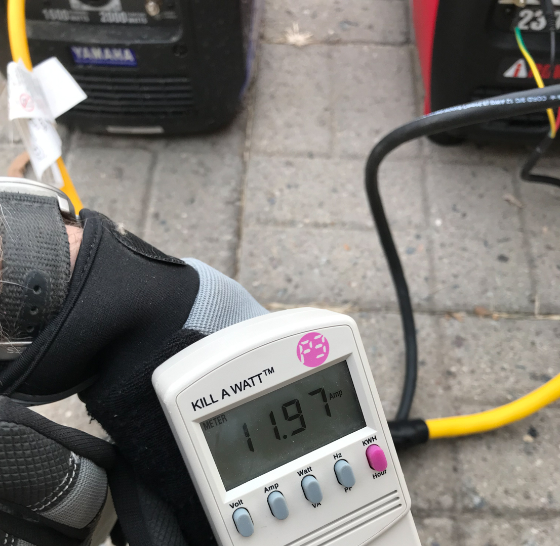

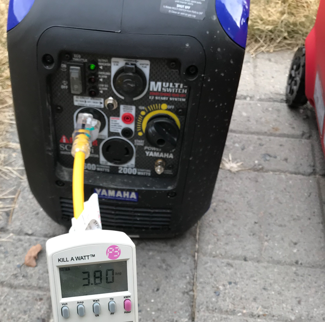

I finally got around to trying all 3x A-iPower inverter generators in parallel.
Started and ran the air compressor just fine. Even with ECO mode on.
Then I tried it again with just the 2x 2300W. Didn't work before, but it works now. Even in ECO mode.
Then I tried it with a 2300W and 2000W. Also worked. Even in ECO mode.
I don't know what the difference is between now and when I tried before. Warmer day? More hours on the SUA2300i's?
One 2300W generator won't start it though.
Pics show roughly 1/3 amps coming from the SC2000i when all 3 are powering the air compressor.
I'm kind of guesstimating the trio can output around ~5200W starting and around ~4100W running, although the breaker will probably limit me to ~3600W (30A).
