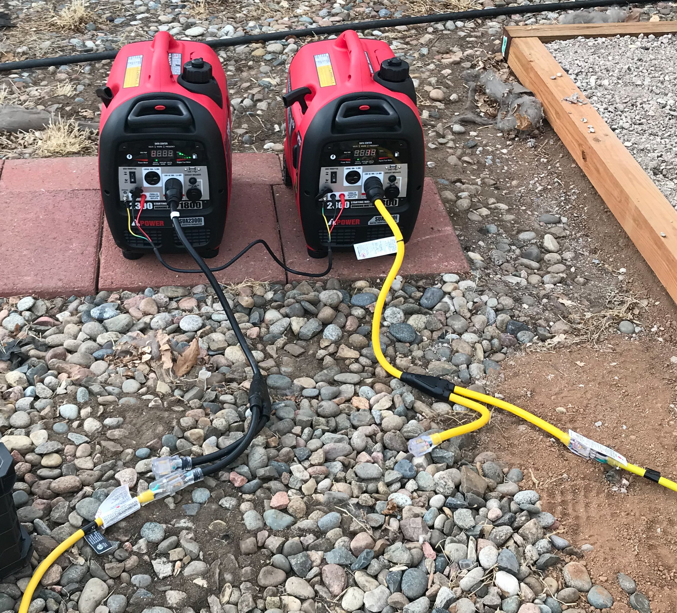

I bought the little A-iPower SUA2300i's from Sam's Club when they were on sale for $249/each. I also have an A-IPower SC2000i from Costco. I think it was ~$450 on sale in store.
Painted the inside of the shed today. Wound up using a 100' 10ga extension cord connected to mains electricity. I didn't notice any difference -vs- a 25' extension cord.
I strongly suspect the two little generators in parallel could have handled it. I might do some more testing when I'm not pressed for time.

I sort of mixed two different electrical loads into the same topic.
I'd been thinking it would be "nice to have" more generator capacity than the single SC2000i. I've been watching the price of the SC2000i, thinking I'd snag another one if they ever went on sale from $550 to $450 again.
I needed to paint the distant (about 125' from the house) AND I noticed the SUA2300i's on sale for $249/each at Sam's Club. I assumed the two SUA2300i's in parallel would be fine for the paint sprayer, but I decided to "test" them with my heaviest single load -- the Dewalt D55153.
I figured if they could run that Dewalt compressor, they could run anything.
When they ultimately couldn't run the Dewalt compressor, I started 2nd-guessing whether they could even run the paint sprayer.
I wound up using a 100' 10ga extension cord and 50' of paint hose.
I may still look for a ~5000W (running) or larger generator just to have around for larger jobs.

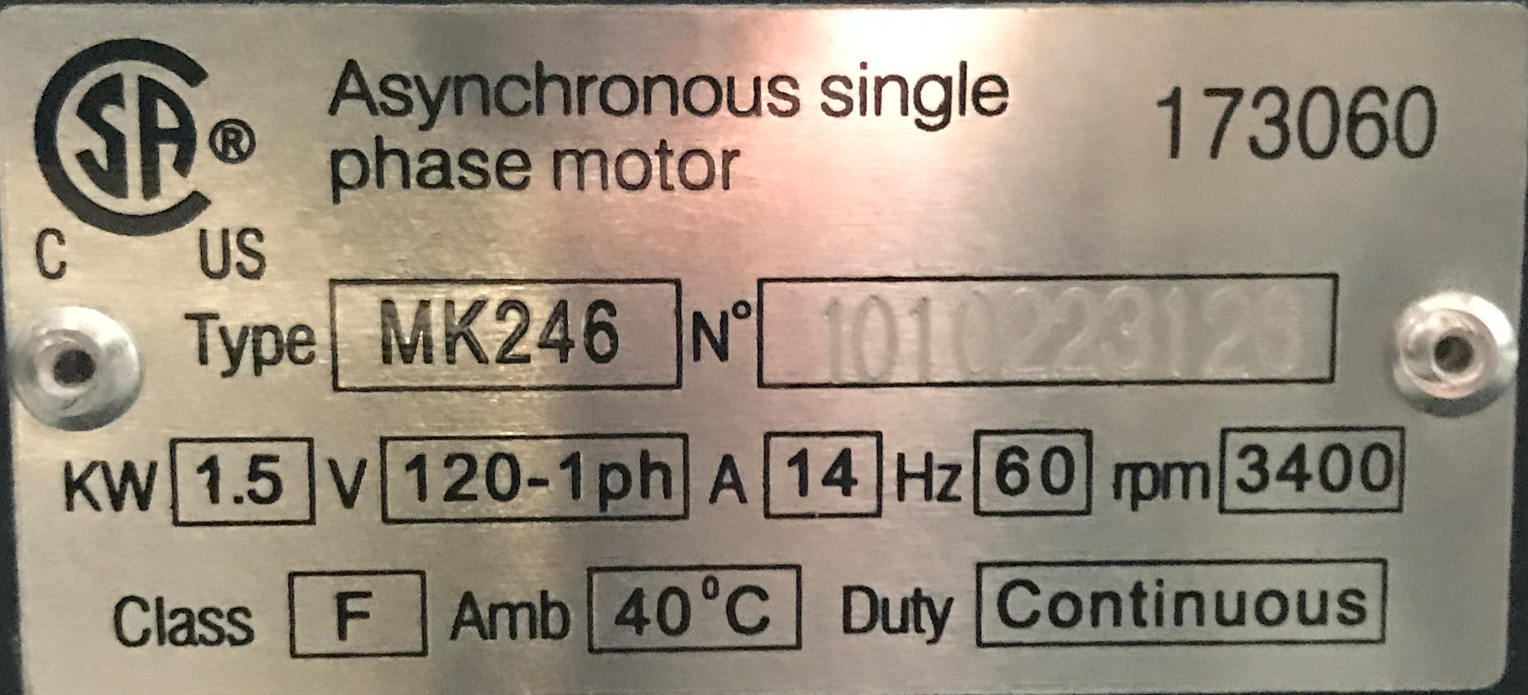

Is there any way to estimate from this placard how large a generator would be required to start this air compressor?
I've seen charts that predict the starting watts for an air compressor to be anywhere from 2x to 6x the running watts.

look on the data plate for LRA amps, THAT is what the motor will draw when starting up, multiply the LRA amps times the motor voltage, and THAT is the wattage. for instance, 40 LRA times 120 Volts=4800 Watts.
/ Small generators #33
Is that the only spec plate for the motor on that ? Most electric things (motors) will list an amp rating somewhere
I don't see one here

A general rule of thumb is to calculate the size of generator required , then purchase a generator twice that size . Not kidding or trying to be funny.
A small consumer grade generator should not be operated anywhere near 100% load . Plus reserve capacity is required for inrush loads .

As previously stated several times by others . Inverter generators will not provide that momentary 2 or 3 times full load rated current . An Inverter generator goes to max current then shuts itç—´ self off.

Honestly, that's what I thought I had done.
I wanted to be able to run any single 120V appliance that could be powered by a standard 15A outlet (~1800W).
These little generators are rated 2300W surge / 1800W running. So roughly 4600W / 3600W combined.
Even after compensating for altitude, that should be something like 3600W (~30A) surge / 2800W (~24A) combined.
