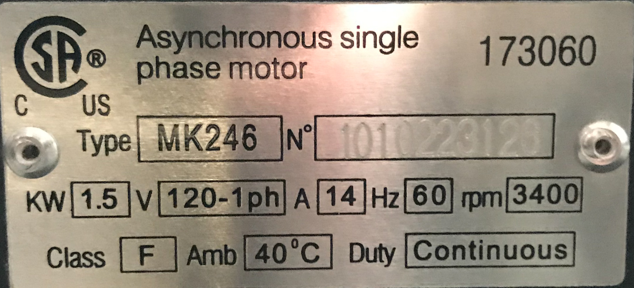

Is there any way to estimate from this placard how large a generator would be required to start this air compressor?
I've seen charts that predict the starting watts for an air compressor to be anywhere from 2x to 6x the running watts.
/ Small generators #32
look on the data plate for LRA amps, THAT is what the motor will draw when starting up, multiply the LRA amps times the motor voltage, and THAT is the wattage. for instance, 40 LRA times 120 Volts=4800 Watts.
/ Small generators #33
Is that the only spec plate for the motor on that ? Most electric things (motors) will list an amp rating somewhere
I don't see one here
/ Small generators #34
A general rule of thumb is to calculate the size of generator required , then purchase a generator twice that size . Not kidding or trying to be funny.
A small consumer grade generator should not be operated anywhere near 100% load . Plus reserve capacity is required for inrush loads .

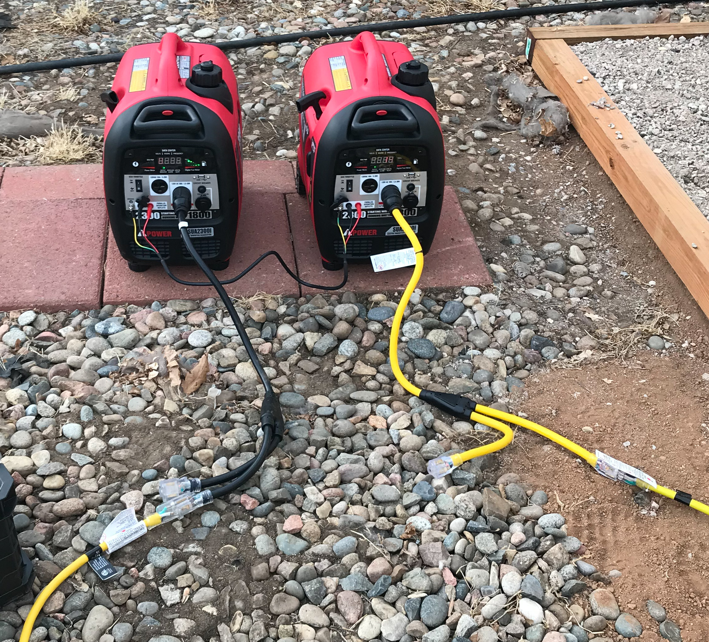

Honestly, that's what I thought I had done.
I wanted to be able to run any single 120V appliance that could be powered by a standard 15A outlet (~1800W).
These little generators are rated 2300W surge / 1800W running. So roughly 4600W / 3600W combined.
Even after compensating for altitude, that should be something like 3600W (~30A) surge / 2800W (~24A) combined.
