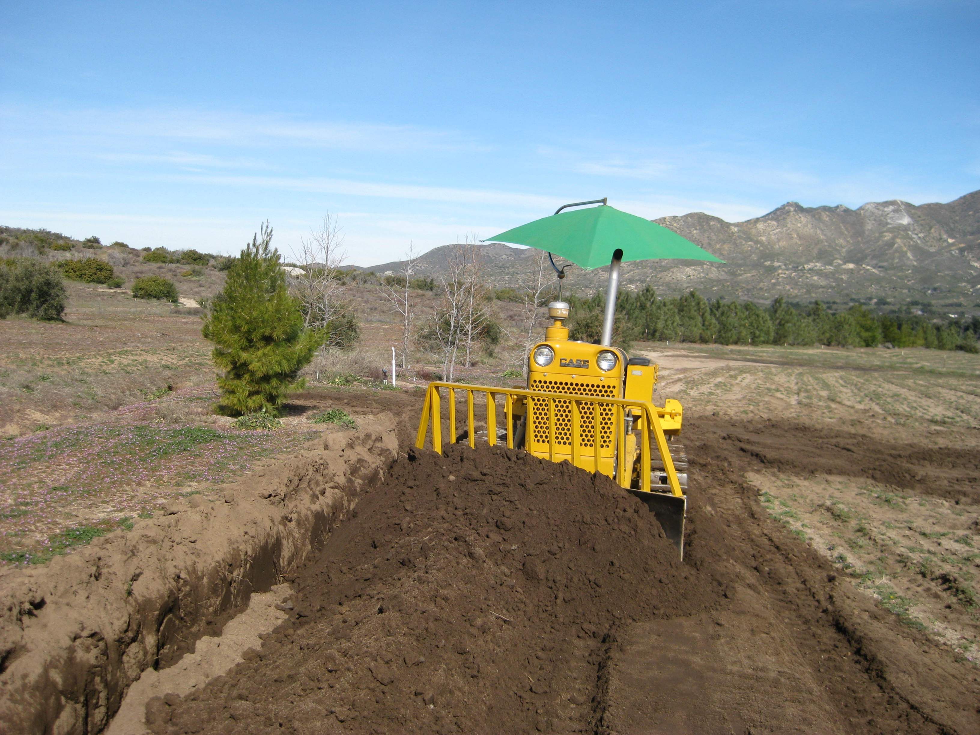

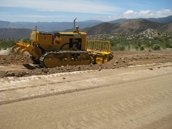

Price range? This will make a big difference. First ones that come to mind are CASE & John Deere, but they will have to be older to be small enough, 350s and 450s I think. Mitsubishi and Komatsu have some small units.
It actually is unbelievable how much these small machines will do. :cool: :thumbsup:
