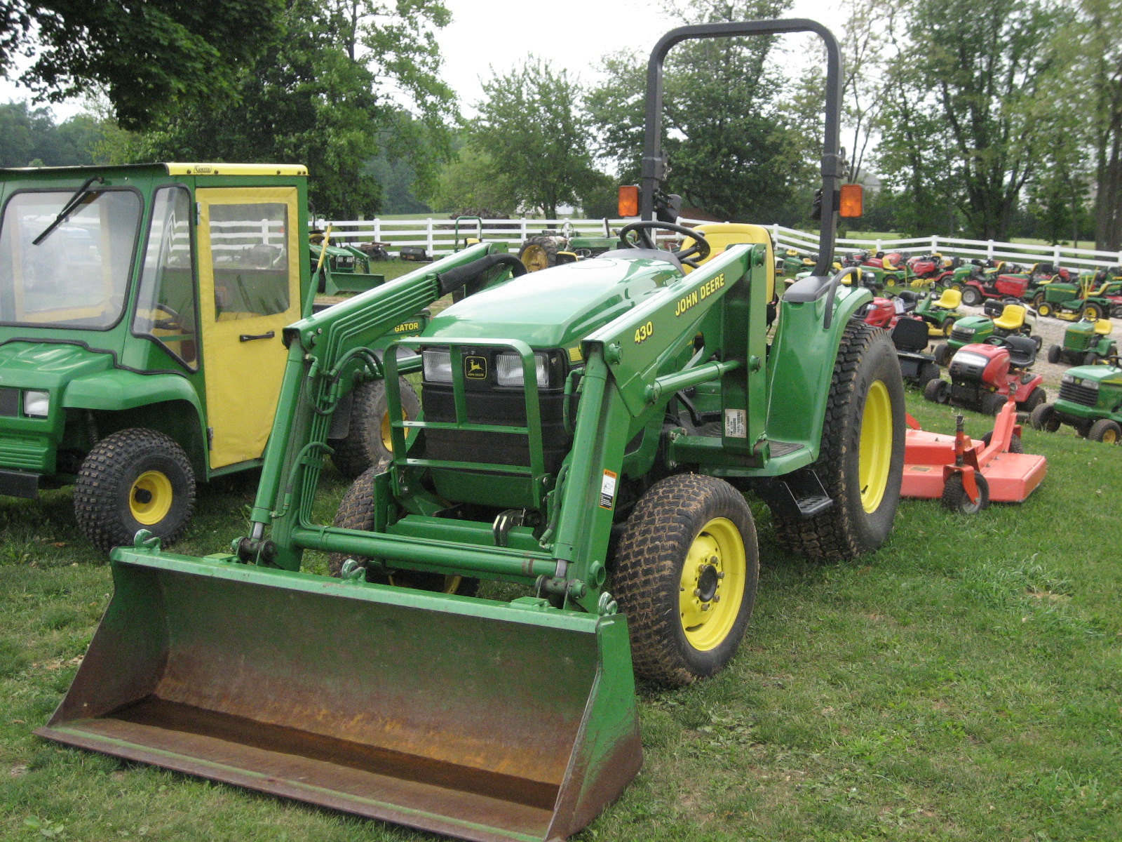

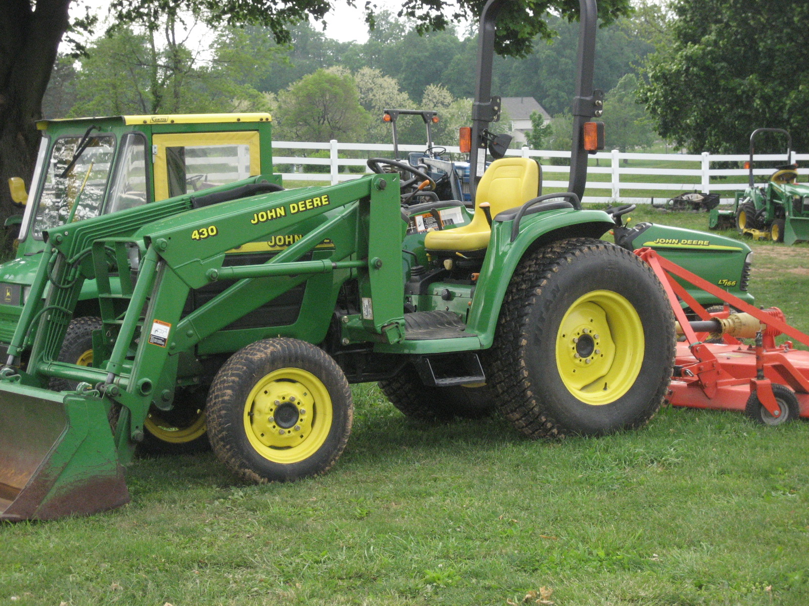

The 4400 is what was considered a medium frame tractor back when they were built. The 4100 was a small frame (close to a subCUT) and weighed (base tractor) under 2000 lbs. The 4400 weighs in at just about 3000 lbs (again, base tractor...no loader).
I've attached pics of the tractor (just pics I have...nothing to do with the "slopes" thread). You'll see the 4400 is quite a bit larger.

Pictures! I tried to hold the camera level, but you can see by the tree trunks in the background I tended to tilt it to make the slope look *less* than actual.
Unless the ground is uneven, it doesn't look to me like the front axle pivots.
With a close enuf check you would find that the front axle pivots uphill relative to the chassis on a flat slope.

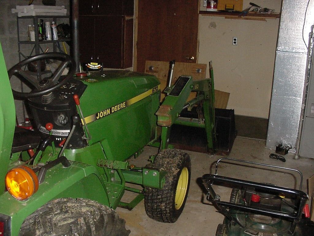

Actually, tiltmeters are quite handy and well worthwhile...especially for the novice tractor operator or when working on unfamiliar turf.
It's not a gage you continuously watch (you don't continuously watch your temp gage or fuel level gage either). It's not for those abrupt changes (upslope rock, downslope rut) but work well for any slope or if the slope gradually increases in steepness.
Easy to calibrate, but you'll need a level and preferably do this on a concrete surface (well, not dirt or gravel). Once leveled, there is not reason to re-level it unless you know it's been moved somehow.
Attached pic is my tiltmeter on my old 670.
