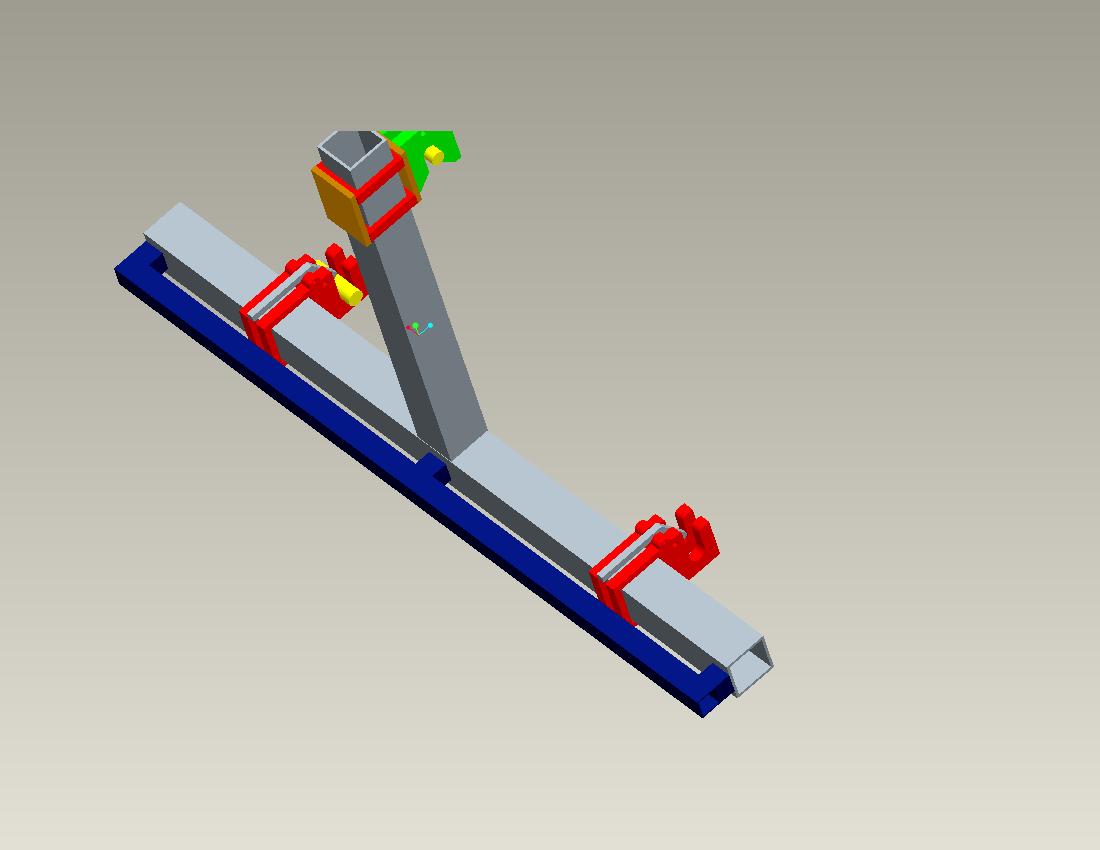

Since building the landleveller for my neighbours tractor I have realised the benefit of having an adapter to lift tractor implements with my skidsteer. It is a category 2 type hitch which is the most common hitch used in Ireland. I have started a design in 3D cad and was just looking to share my ideas and maybe get some feedback off people. My goals in the design are

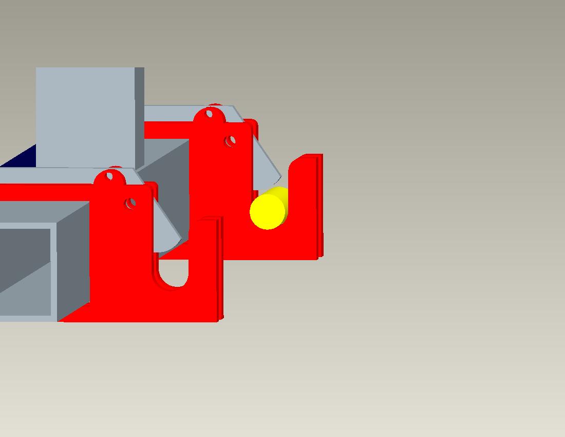

1. The bottom two pick ups can be connected without leaving the seat. ( The width of the pick ups will be adjustable and will have to be set before trying to lift the implement) Upon lifting the latches should open and let the pins enter the hook. They should then return into the original position and lock the pin in place.

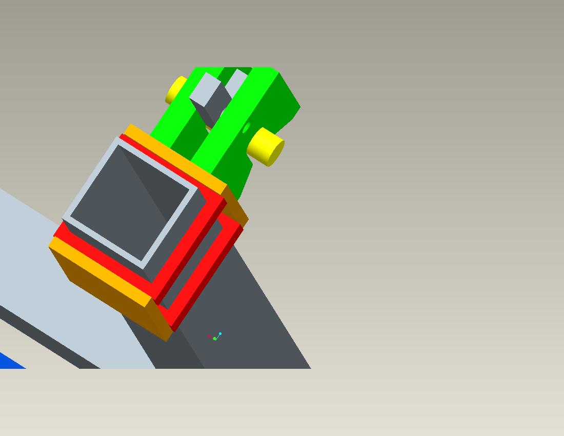

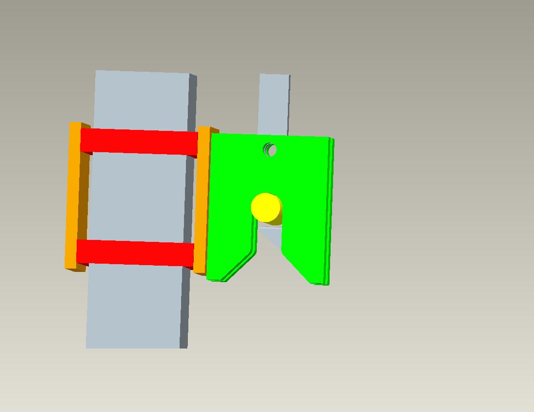

2. Once the bottom two pick ups are connected then the top link can be attached by angling the loader so that the top link latch lines up with the pin and by pushing the top link latch downwards where it will latch into place.
3. Disconnecting the implement will be the same steps in opposite. I hope to put a pull cord to open the bottom two latches and manually open the top one with the lever when doing this. I am also contemplating putting in lynch pins that lock the implement in even though the latches are designed to prevent this so that it is impossible for an attachment to fall off.
4. I hope to be also able to move trailers with this implement also by adding a ball hitch in the centre
I havent shown the pick up points for the skid steer yet but I will hope to angle it slightly so that I can tilt the attachment towards the skid steer cab if needed.
I have attached a few screenshots and a 3dpdf for anyone who is interested to have a look.
Thanks,
Ron

I don't understand why your top bracket is upside-down...
I think it should point upward like the one I'm contemplating...

The top link pin will not provide any lifting force and therefore it is to prevent the implement from rotating about the lower pins. the reason I put it on upsidedown is that I can just lean out of the skidsteer cab and push it down to connect the top link. I will be connecting directly to the implements not using a top link.
Regards,
Ron
