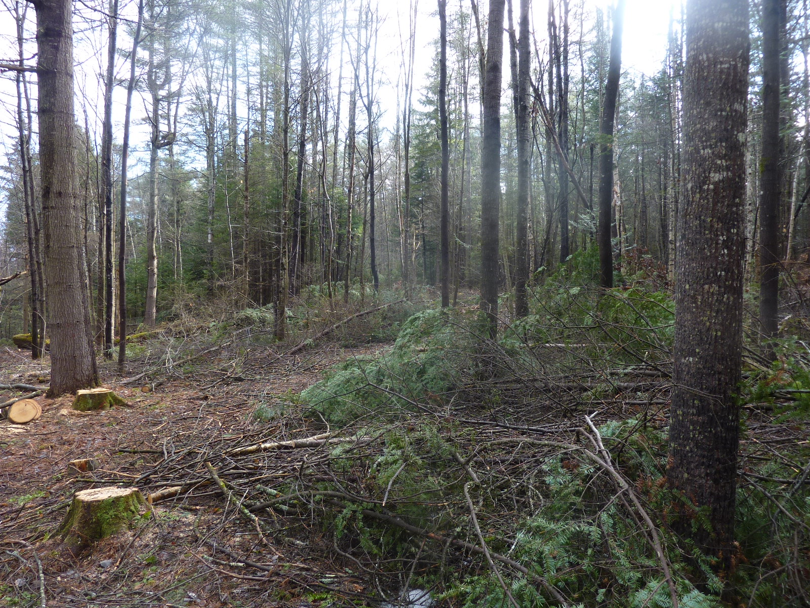

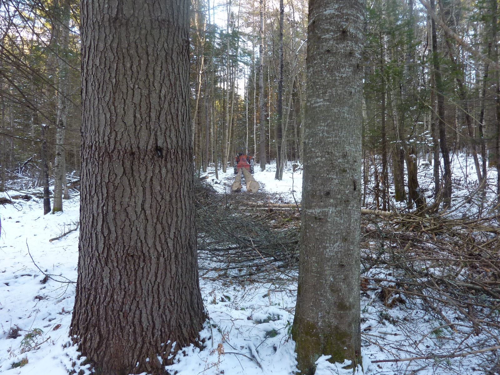

A thinning job I did last year with my winch. I put in a dead end tractor road last July while it was relatively dry. I thinned the area in the picture behind the tractor.
I cut in late December after the ground was frozen.
This is what it looks like now. I took this yesterday morning.
gg
I was going to get some pics. of logs that my three point hitch wont pick up and you have them in your second picture. I bet you miss the snow already, with any luck you might have some Monday.
