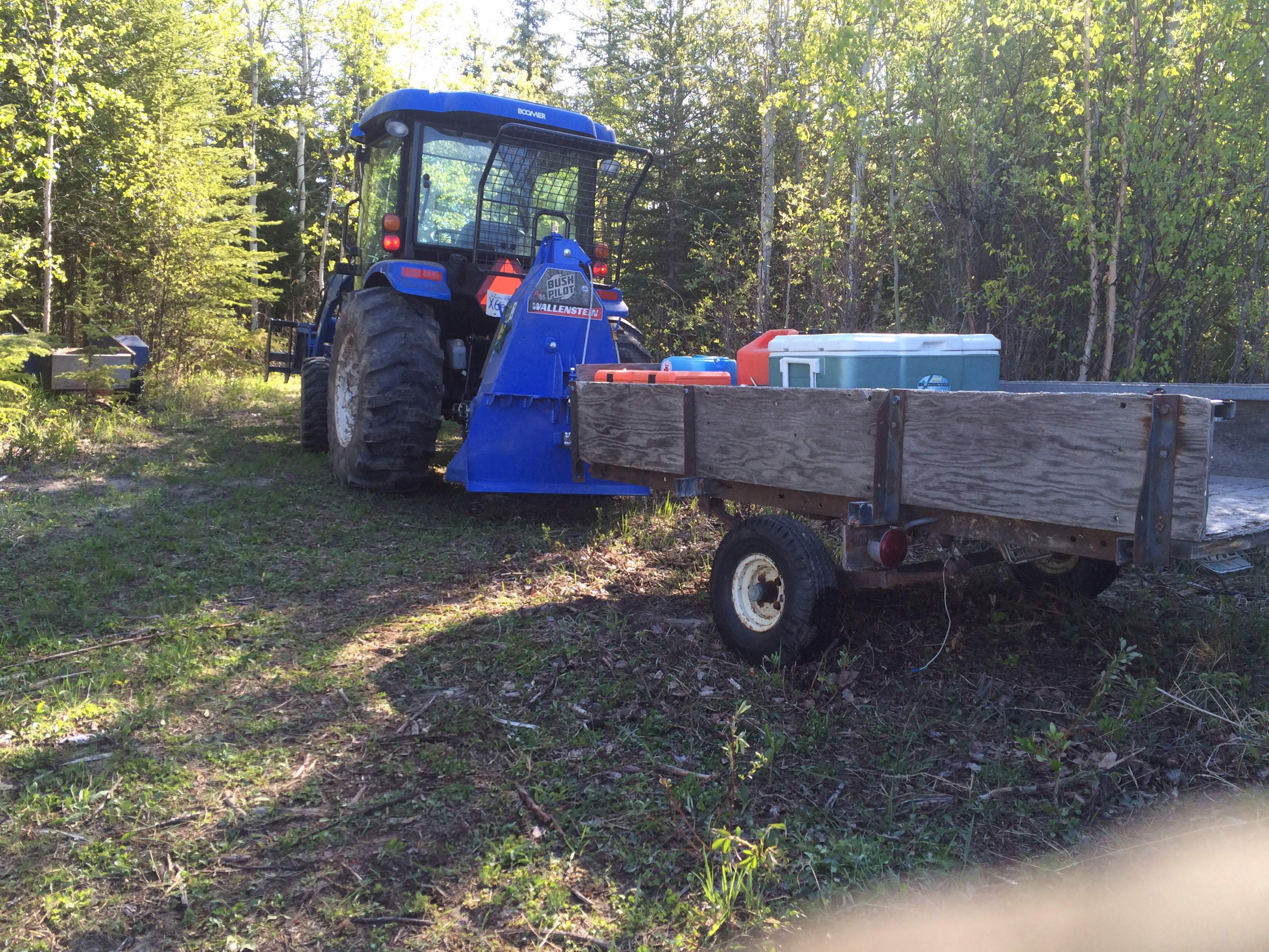

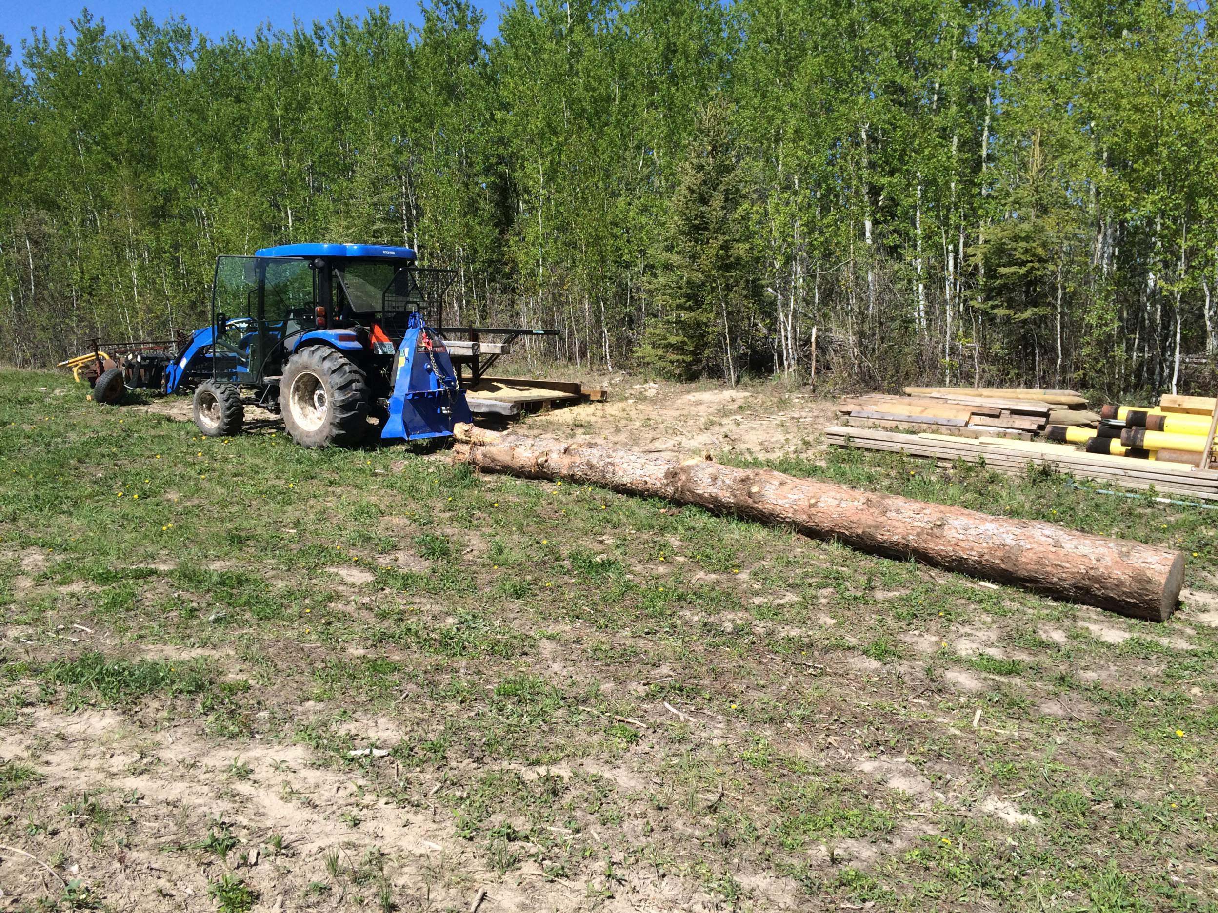

Quite a few of us on this forum have skidding winches. I would like it if you could share and ask questions about these awesome attachments.

I like how it matches your tractor. ::thumbsup:

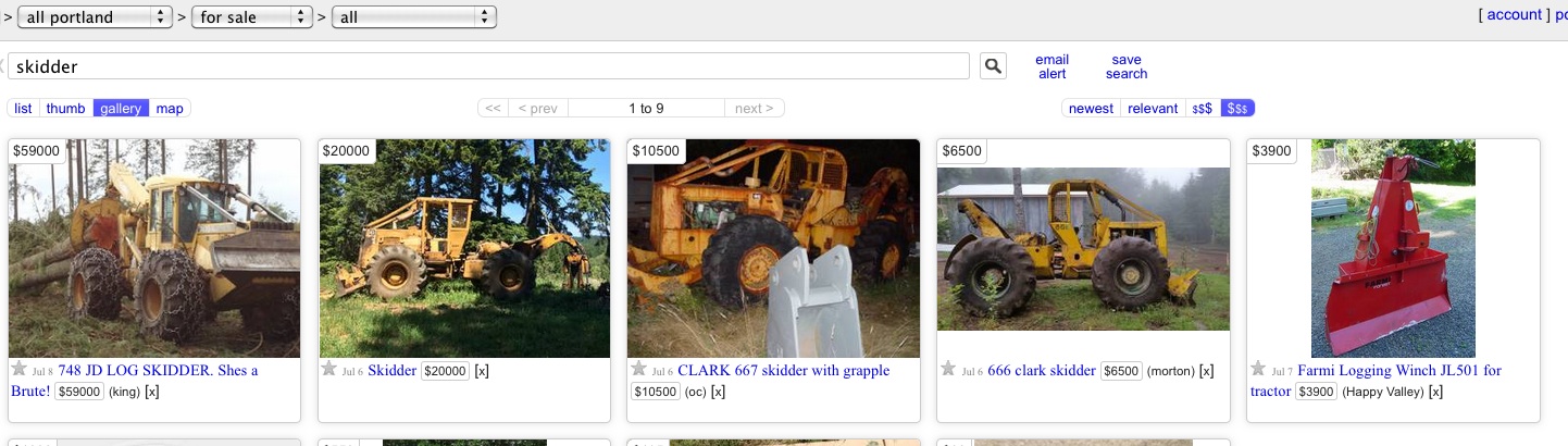

A mechanical drum lock, not a brake? Or a brake, too?
I've watched several videos, but can't see what is going on in the machinery that is out of sight. And see different methods used.
Tractor logging winches are scarce around here, maybe once a year on CL. But lots of these in sight on rural drives. Maybe that's why so few tractor logging winches.

From what I have seen of WA which is mostly the North Cascades and Olympic Peninsular you have vey steep ground and very big trees. Neither of which tend to be tractor friendly. Maybe that is why winches are scarce.
On CL today, the 2nd Farmi I've ever seen on CL.

For that price, you can get a new FX90 old model, or new FX85 delivered.
I've never seen one on CL here either, and we have a lot of gypo logging going on.
