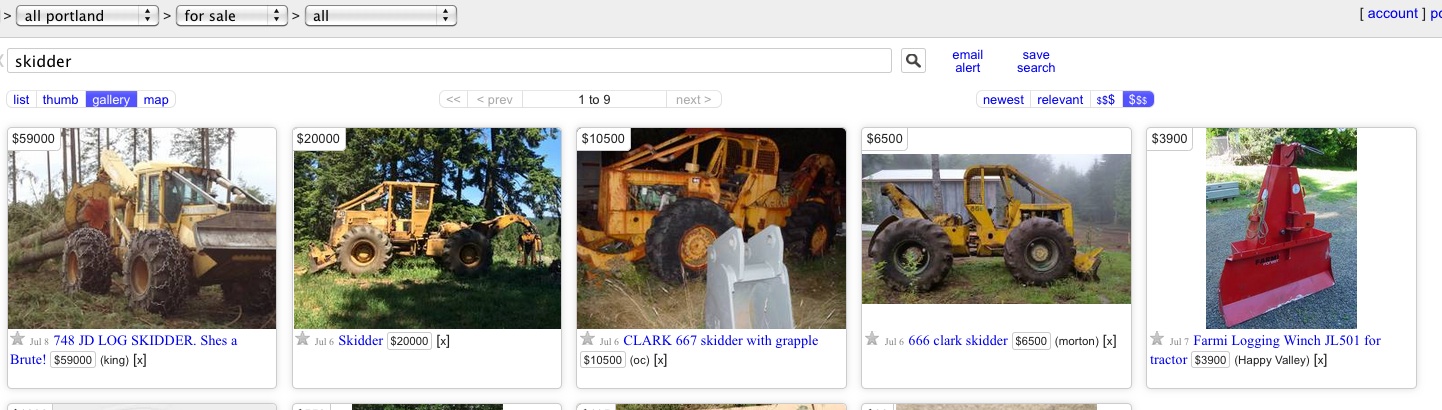

For that price, you can get a new FX90 old model, or new FX85 delivered.
I am not sure you can get one delivered to the west coast for that price. An FX85 only pulls 8500 pounds and weighs 470 pounds. A Farmi JL501 pulls 11,000 pounds and weighs 725 pounds. Apples to Oranges. Needless to say the winch sold quick to somebody who knew what they were looking at.
