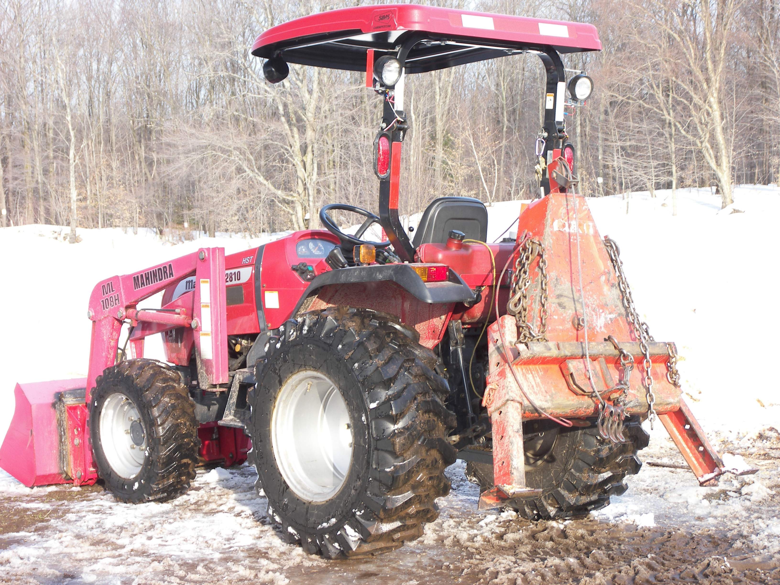

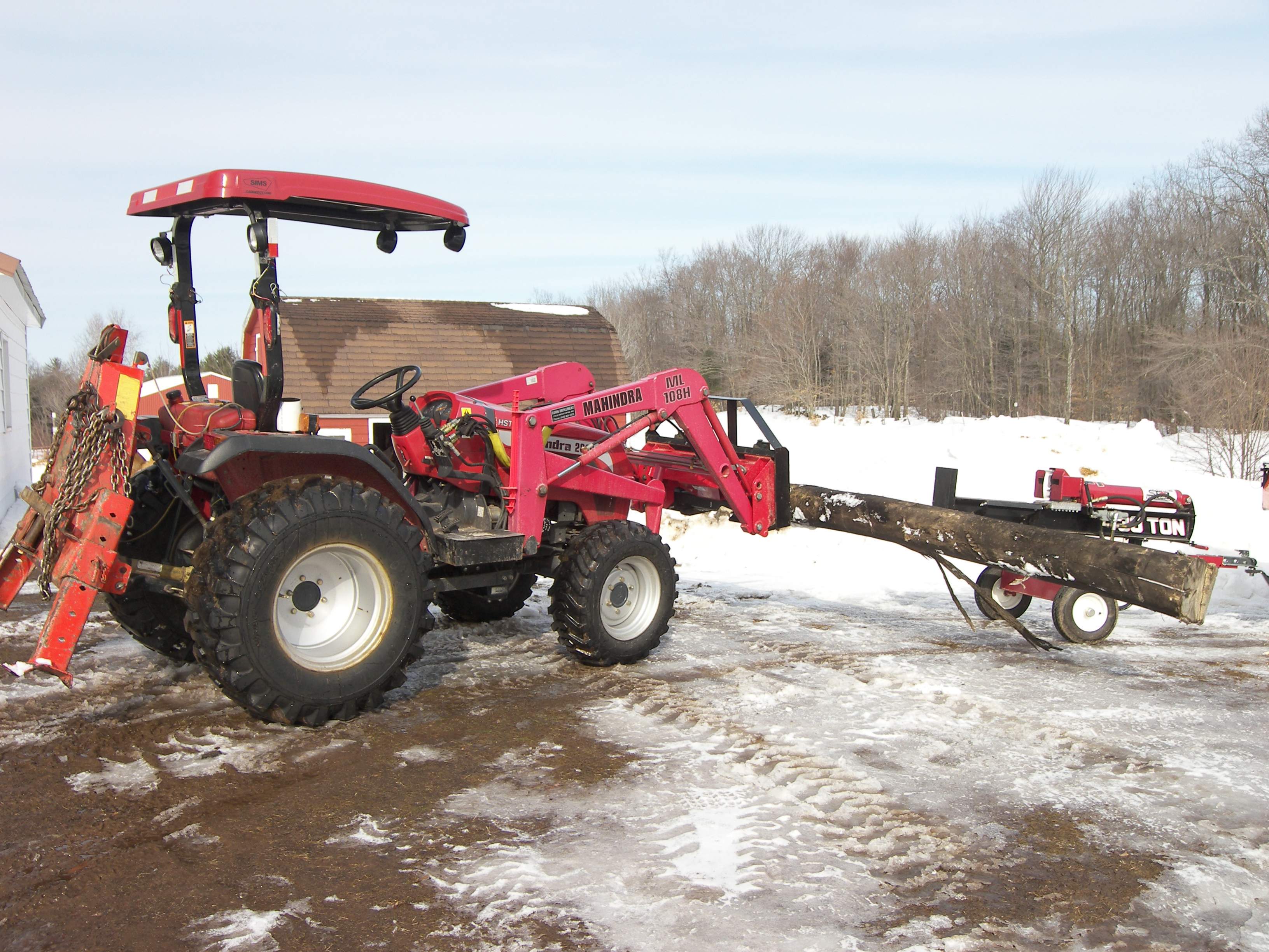

Well my Farmi is a JL300 and its old and well used. I use to run it on a Belarus 400 which is i believe 58 HP. Run it 10 hours a day for years for production firewood and saw logs. Using my winch just last week the drive chain broke. It took about 20 minutes to replace and its as good as new! Most likely which ever one you choose you will never hurt it. They are one tough machine. I still have the original cable on it even though it is getting bad. I did have to replace the forged hook that came on the cable originally because it straightened out while pulling. I put a campell hook on the end and have 3 cable clamps on it now. IMHO which ever one you choose, you will not be disappointed! and when you get use to using it you will ask your self 2 questions, #1 Why didn't i get this sooner? and #2 how did i get along with out this before?
Heres a pic on my Mahindra, i'e since put it on the Kioti. . . .John
Just looked at the Farmi site and the 501 puts out 11000 lbs of pulling power @ approx 60 Hp. and at 720 lbs thats A LOT OF WEIGHT! The 351 is just a little over 400 lbs. Without being on your game all the time you could do serious damage to your tractor with this one. Back in April of 2011 I broke the rear axle housing on the Mahindra pulling with my winch. Believe it or not this is a serious machine to do serious work, not a toy like some people think. These winches are used in commercial applications in pine stands to haul logs for production because of their ability to with stand abuse and on the back of a tractor provide low ground disturbance. I guess my choice would be the JL351P if i was buying another. Great machine thru and thru . . . John
