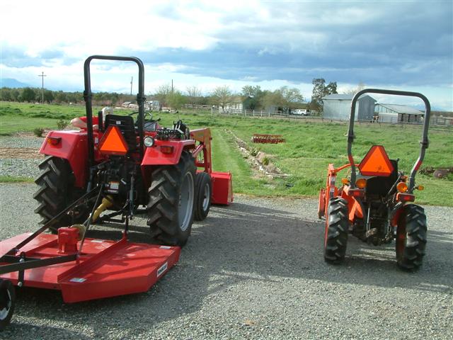

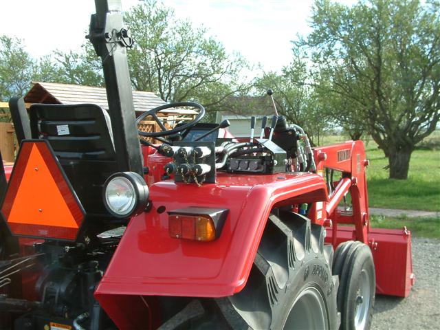

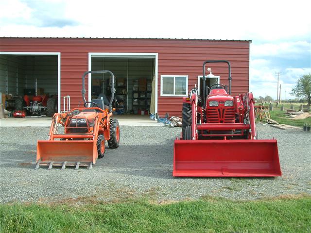

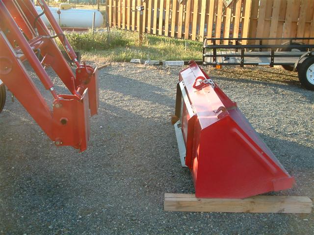

For example, my big tractor is a 2008 Mahindra 5525 (54 hp engine, 45 hp pto, 2WD, gear tranny 8F/2F, power steering, triple rear hydraulic remotes) with the ML250 FEL (6-ft wide bucket, skid steer quick attach option, 2950 lb lift to 10.5 ft height). Cost about $19K new. This 3-year old tractor probably has lost $5K or so in value.
The little tractor is a 2005 Kubota B7510 HST (21 hp engine, 17 hp pto, 4WD, hydrostatic tranny, power steering) with a 4-ft wide FEL bucket.
DSCF0061 (Small).JPGDSCF0062 (Small).JPGDSCF0067 (Small).JPGDSCF0110 (Small).JPG
If you want to get into older tractors, you could find a 1980s John Deere like my neighbor's JD 2640 (a 60 hp pto tractor) with FEL for under $10K.
