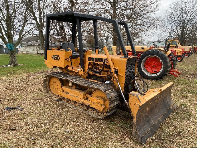

/ Size of Dozer? #12
These older small Case 450 and the John Deere equivalent were very popular and are excellent landscaping dozers. You can usually find them reasonably cheap.
They are just the perfect size and weight for finish landscaping.
