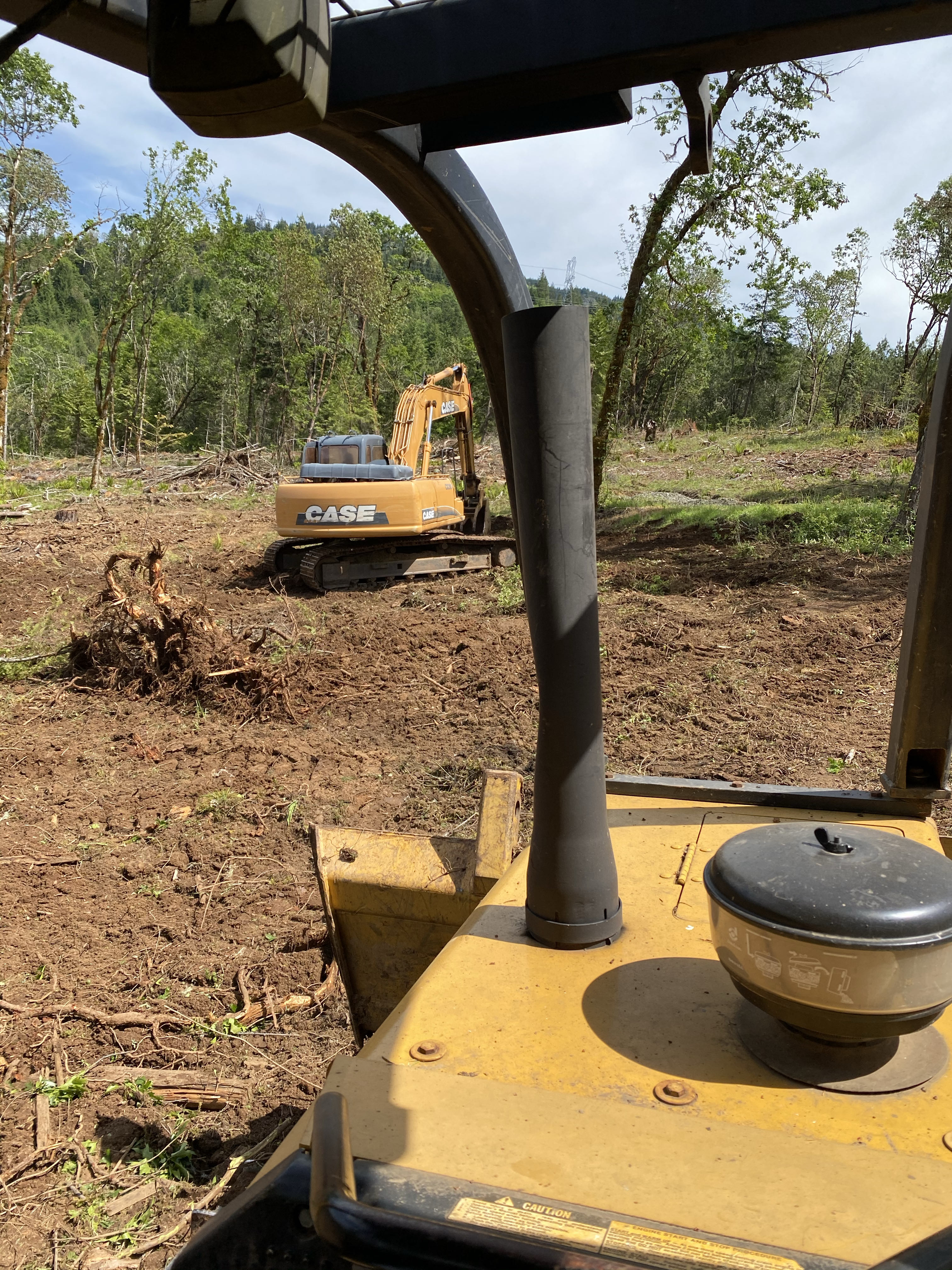

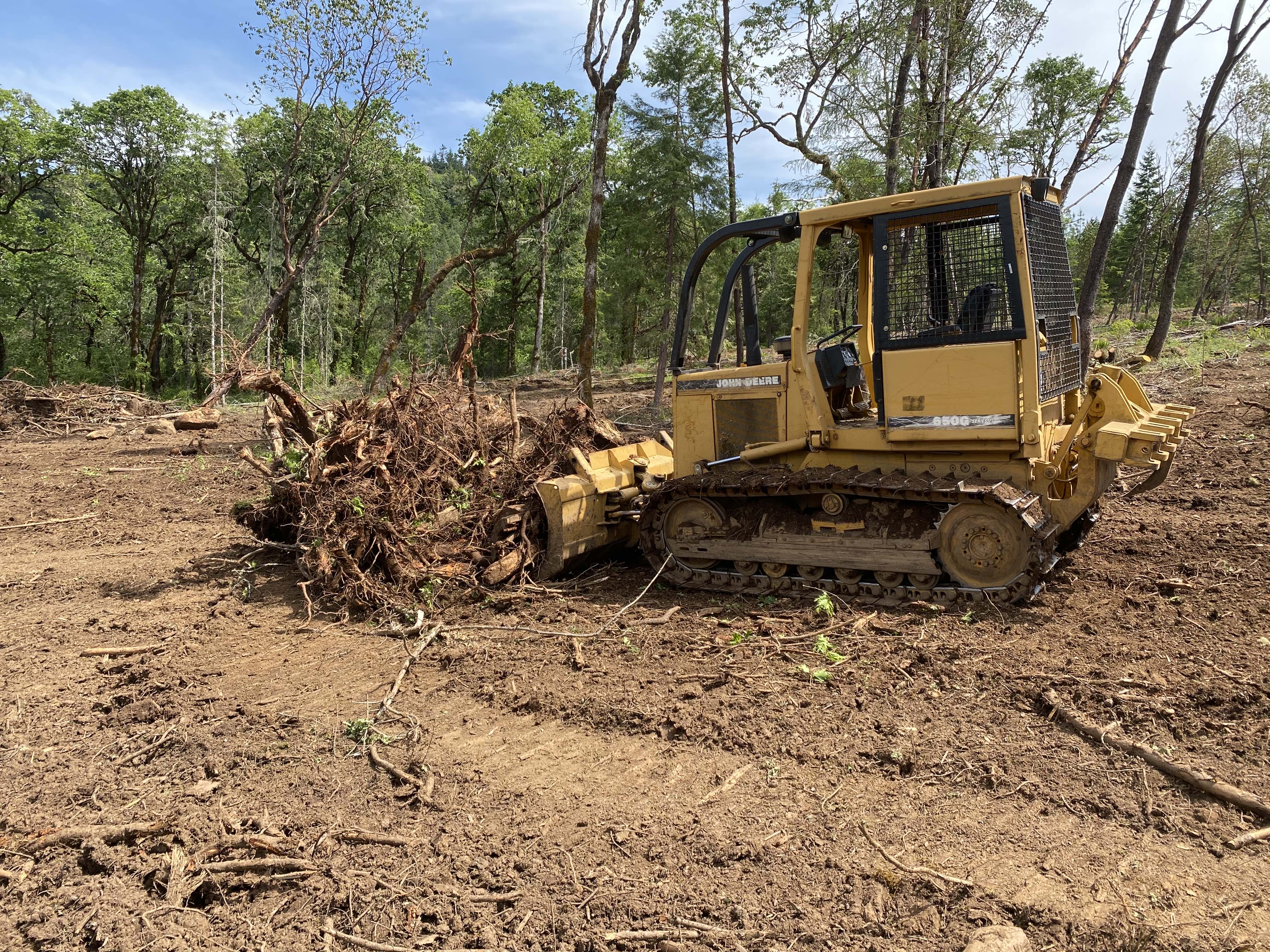

I’m not sure how much heavy land clearing you will be doing, but if it’s a substantial amount, I’d by an excavator first, and then come in with a dozer to finish up. A 20,000lb dozer is the smallest I would go with, but heavier is going to allow you to get more done per hour. My dad and I have cleared many acres of land over the years, and find that a 20 ton excavator along with a 20k lb dozer makes for a great combination.

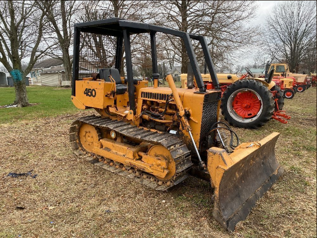

These older small Case 450 and the John Deere equivalent were very popular and are excellent landscaping dozers. You can usually find them reasonably cheap.
They are just the perfect size and weight for finish landscaping.
