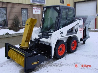

I chatted with the Reist Industries folks in Elmira, Ontario, Ca
today to ask about their snow casters.
The Series 1000 48 inch wide 540 PTO single stage snow throwers were $2,750+
options and taxes and freight.
It comes standard with a manual chute rotation and manual adjustment of the spout angle
and it runs between 450-500 revolutions per minute under load at 540 RPM
The drive and driven sprockets can be changed if desired to better manage the snow conditions you "have".
The sprockets are secured with locking ring compression rings(Ringfedder type) to secure them in place.
The only thing I did not like was that the tensioning sprocket that is attached to the rubber torsion arm
is mounted on the top of the roller chain between the drive and driven sprockets.
I can see why they did it though in order to reduce the shock loading on the roller chain under load.
On the IHC 12 horse CUB we had used roller drive chain that was under tension at all times and the chain was replaced if it
stretched if I remember the manual correctly.
SO to do battle with the elements you can have the following options added:
1. hydraulic chute rotation; The hydraulic motor is on a spring tensioned mounting plate under the guard
to maintain chain tension on the roller chain. The roller chain is a longer link roller which lets them cut
larger gear teeth to make it easier to rotate by hand with the standard manual rotation included in the price.
2. hydraulic spout control
3 hydraulic motor drive for a high flow skid steer system
4. skid steer mounting plate and hydraulic motor hardware for a skid steer loader
The hydraulic motor replaces the right angle gear box to rotate the cross shaft
that rotates the drive chain that spins the single stage cross auger
5. they also offer a set up with a gear pump mounted to the rear PTO shaft
and a hydraulic reservoir that is attached under the bottom step of the tractor
By the looks of it you can add the hydraulic doodads later with zero issues too.
The only thing it lacked was a slick sheet lined chute and spout but that can be added easily using
the flat head washer bolts to attach slick linings sold by Gemplers.
They have not thought about mounting one of these units on a RTV with a hydraulic power pack
as the tank would be very large and require a big engine to power the gear pump
In a sincere nod to Muhammad and a Shameless Plug for TBN I mentioned to them that they should
advertise their product line on TBN.
View attachment 1000 Series Snow Blower manual May 2012.pdf
