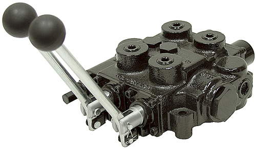

when you say stacked valves do you mean like this?
i would install a 2 valve block like the above of DA valves and then a single SA valve separate for things such as the trailer and lowering and raising SA mowers
Cheers Ed

actually scrap what i just posted above, i'm pretty sure that's still not a stacked valve
Cheers Ed

Do you absolutely need a SA valve with only one work port.
A DA valve will do the same thing after plugging one p ort.
There are plenty out there.
https://www.google.com/search?q=ces...a=X&ei=Z_NkVNOhK8eogwTgmoOwDg&ved=0CAYQ_AUoAQ
It is just too easy to convert a DA valve spool to SA by plugging one of the work ports, or running the unused workport to tank.
A monoblock valve is one piece construction.
A stacked valve is just that, spool sections stacked together with an input and output, and bolted together..
/ single acting #29
Sounds like you need a three spool DA valve and plug one work port on the third valve to make it a SA spool.

plugging one work port on a DA, now that sounds like an idea!
or as you say i could run it to the dump line, would just plugging it cause any extra wear to the pump?
is this all i need to plug it, obviously in the right size
Blanking Plug Hydraulic Compression Fittings Part Number - VS-M20X1.5-WD | eBay
also is the dump line under pressure, would i need a check valve on any lines T'ing into the dump line to stop other oil being dumped going up the pipe T'ing into the main dump line, if this makes sense? can do a basic diagram if it helps?

Yes, that is a stacked valve.
You can see the bolts connecting the spool sections together.

contacted two companies now for a quote on stacked valves with 2 DA valves and one SA with carry over (PB) port and 1/2" ports and one is going to post me a quote and i will phone one on monday when their specialist valves guy is back
Cheers Ed
/ single acting
#36
is there really an advantage if getting a slice or stacked valve with 3 double acting ports and plugging one outlet and just getting a normal mono block 3 valve block and plugging one outlet?
basically is there any advantage of getting a stack valve over a monobody valve if they have the same specs and you are doing the same thing with them?
just getting a monobody would be a fair bit cheaper
and for a 3 point mounted forklift of a reasonable size, what would determine if i need 3/4" ports or 1/2" and how many l/minute flow rate i need?
Cheers Ed
