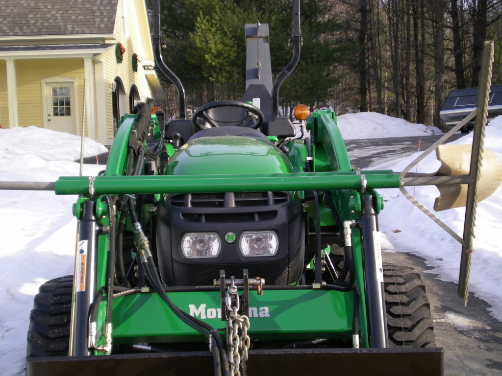

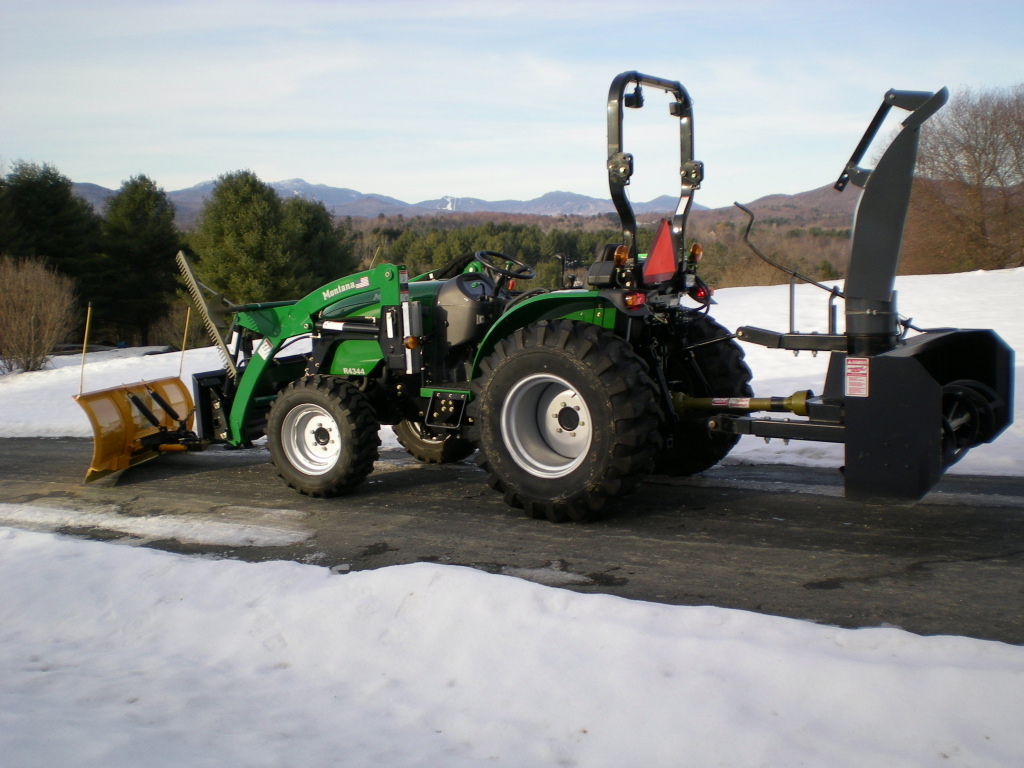

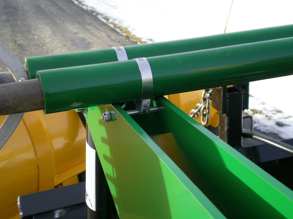

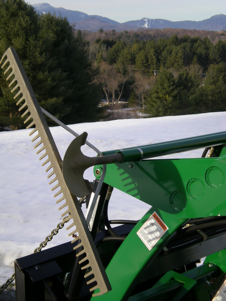

After searching for a way to carry a shovel and landscape rake on my tractor I came up with this PVC tube idea across the front of the FEL. The 1 1/2" tubes are mounted using stainless hose clamps and the shovels and rakes fit snugly. Here are some photos. Greg

Do you use the rake to clean up what the blower misses?
