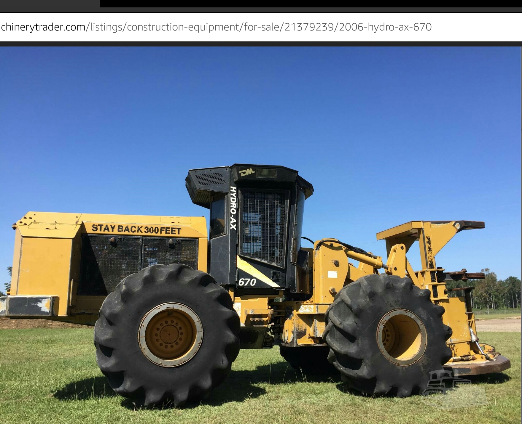

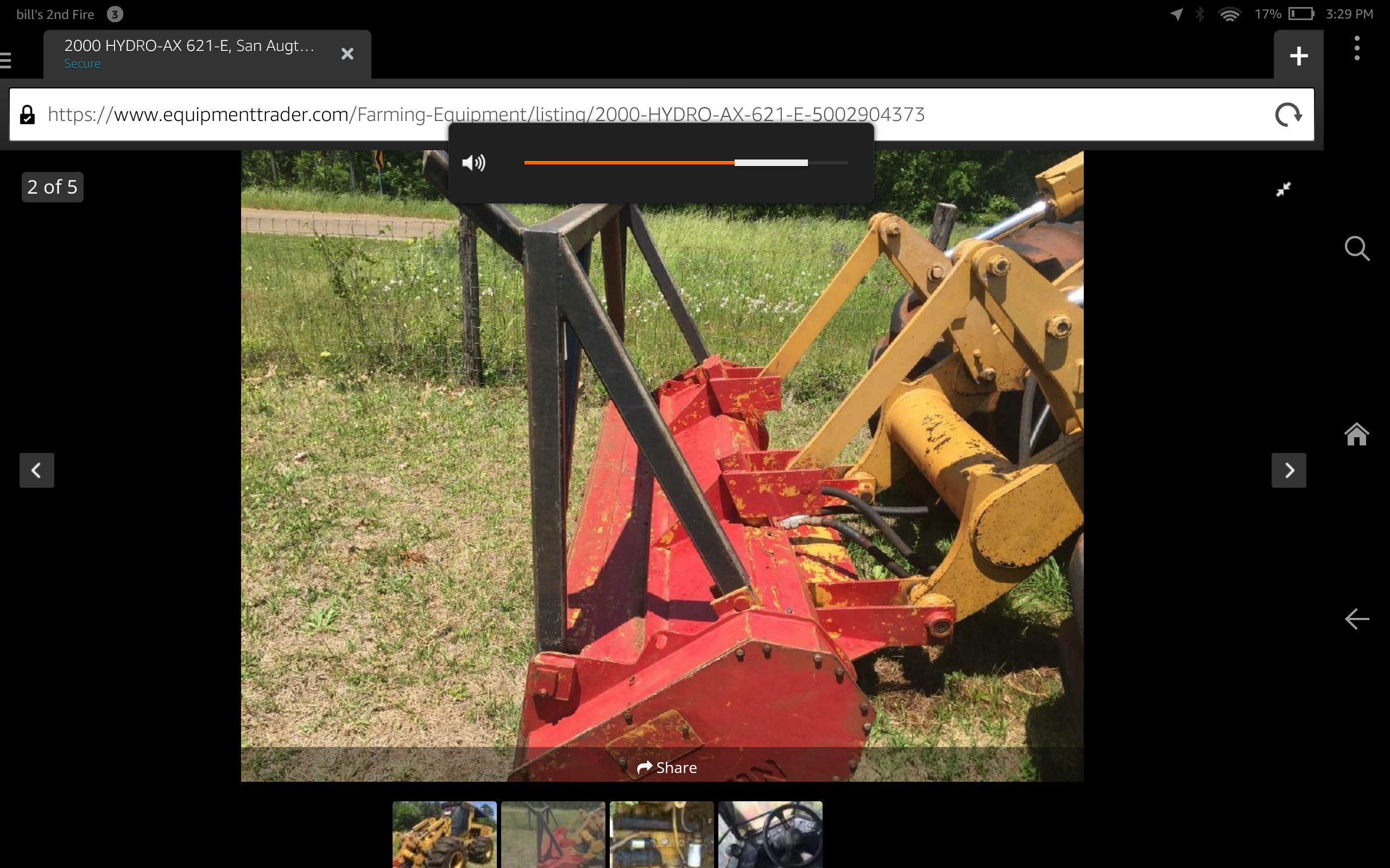

Never seen a roadside mower w/ duels? Got some pics, Many of those operators have frequent underware changes. Ther primary purpose for tractors is twofold: one is visibility and the second is roadspeed so they can get back to the barn to change their shorts.
And dont laugh too hard, wouldn't want to to loose your balance. The OP is not mowing the roadside, CORRECT?
1010, Completely missed my point, Said tractors are used over skidsteers for TRAFFIC visibility. Said nothing about duels and speed. But the Current trend for roadside work is a hydo side mount flail and a rear flail. Duels DO interfer w/ that Application!!
EDIT: ROW tool my utility uses: ROW and Roadside maintenance, two very different applications, the OP does neither. The additional hydra ax head used for Utility Power Line access maintenance.
