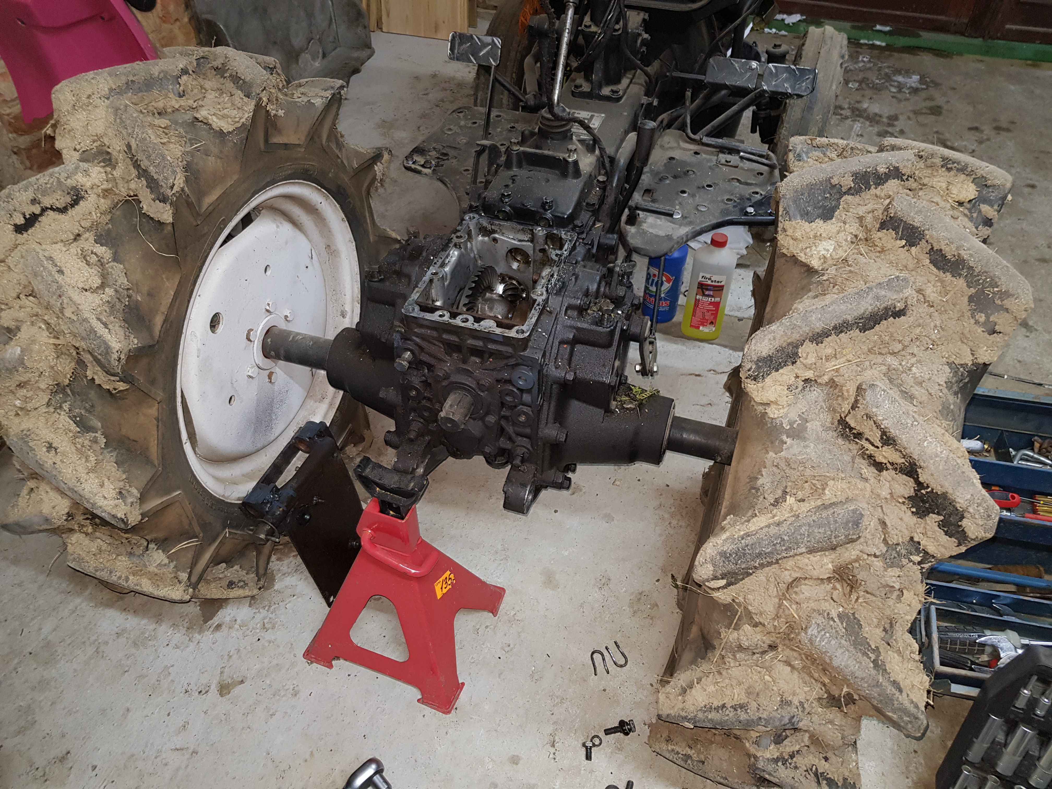

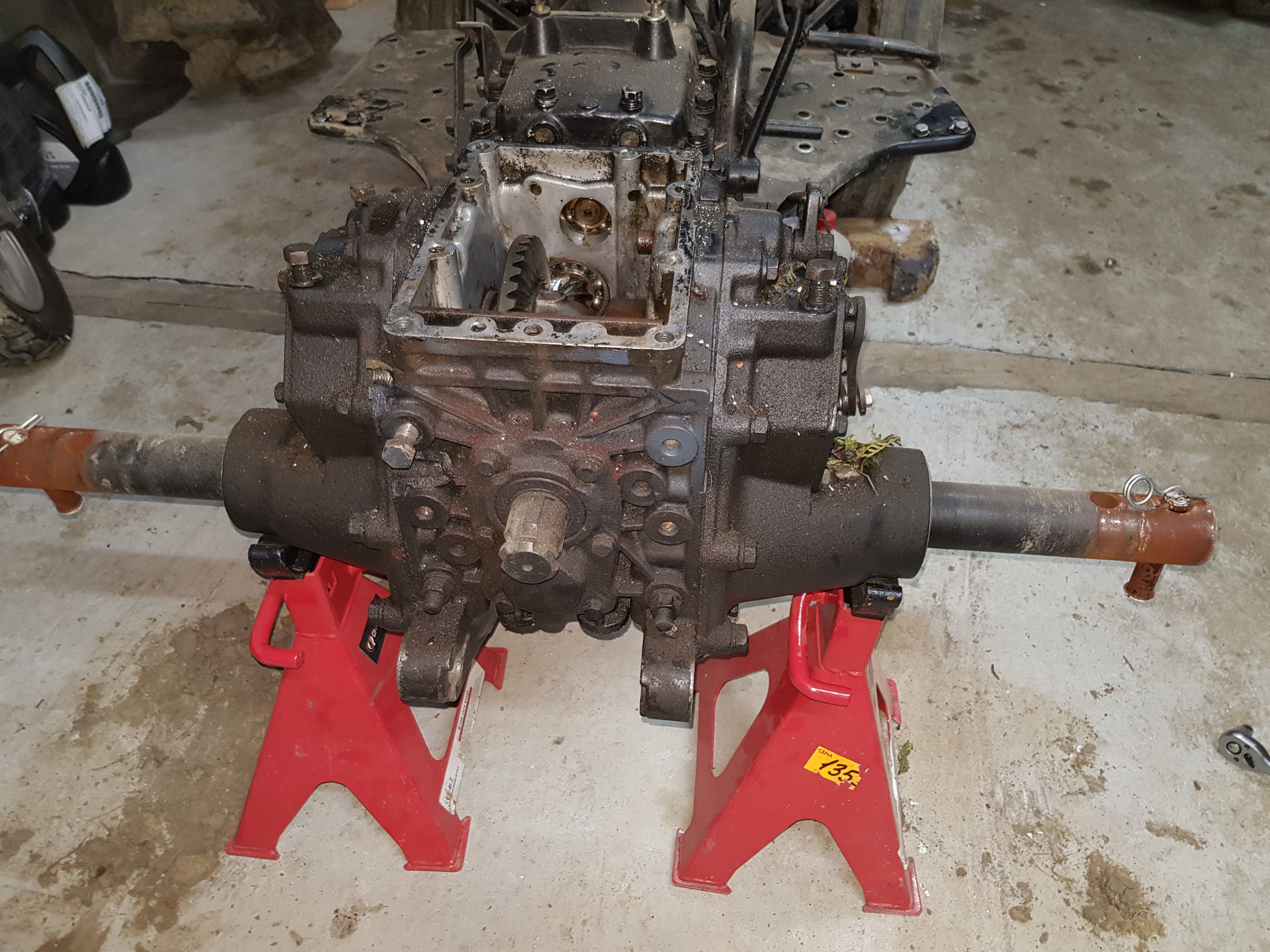

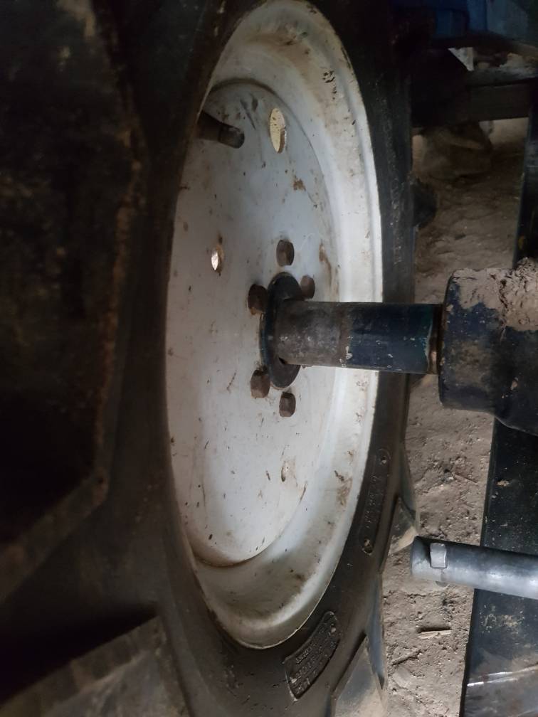

Ok i see what you mean... But my wheels have a different structure, cannot do that. But it got me thinking...
My wheel-axes are just sticking out of differential, and the wheel is shoved onto the end of this axis. So what i could look for is some big cylinder that i can put/shove onto these axes, and then stick some piece of steel (same thickness as the original axis) into the overlap part of this cylinder. I hope this makes sense.
This is what my wheels and axis looks like:
I will start looking for some steel next week. Thx!

Can you remove the 6 bolts on the hub by the axle, and add spacers there?

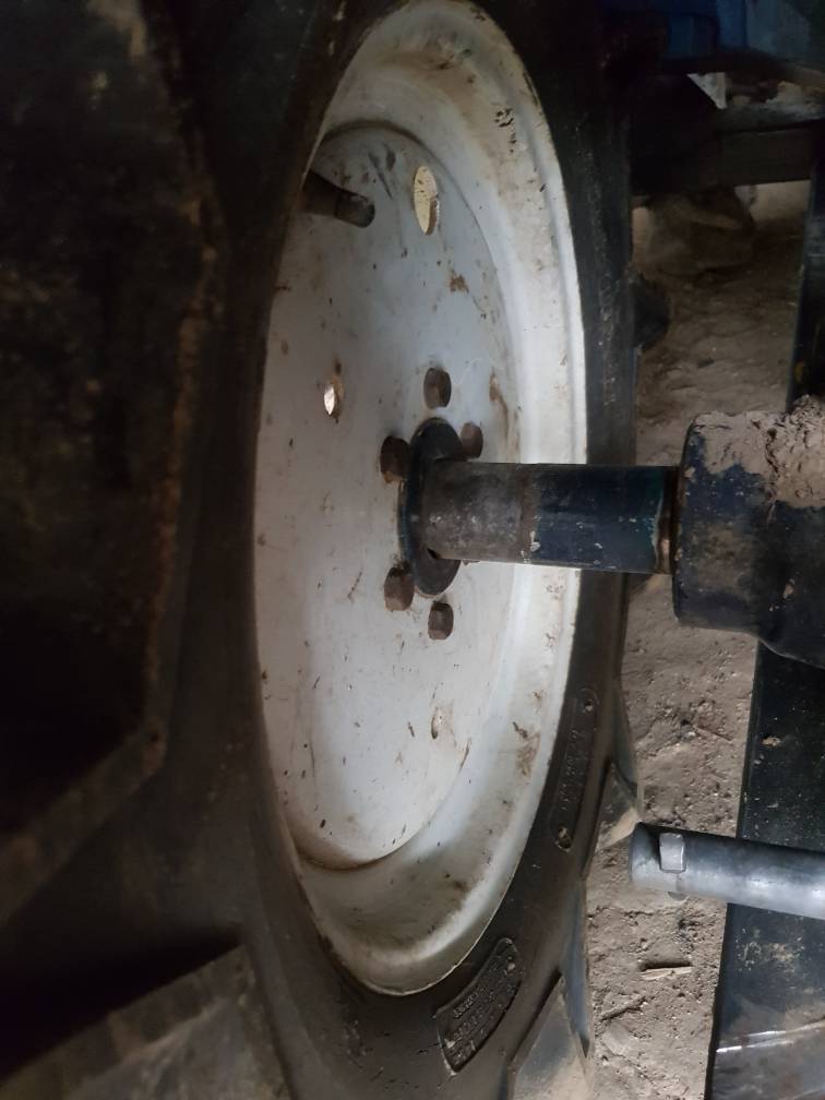

Hi d2cat, good observation, that could actually work. These bolts connect to a cylinder to go around the wheel axes, with a hole in them to secure position. I think I can move these cylinders from outside position to inside position?
/ sided my tractor: question about weight #17
Thx M. View attachment 620163View attachment 620164
Reverse the hub, as well as check the dish of the wheel... if the tires are swapped side to side to keep tread direction correct, you may gain some width that way as well, no fabrication needed.

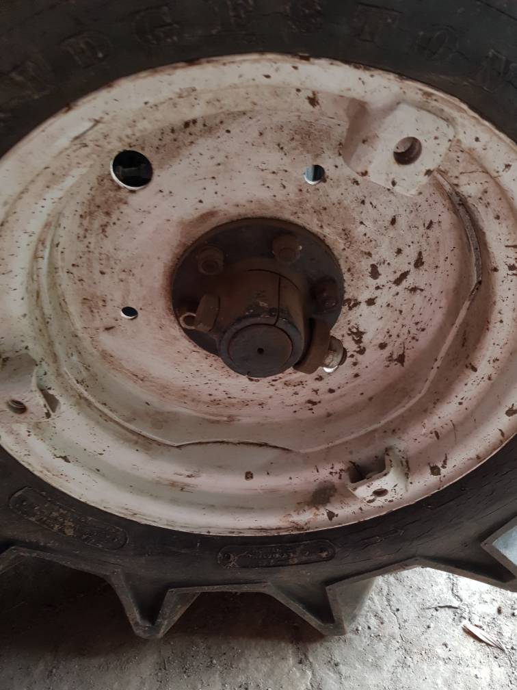

Marcel - looking at the outside of the wheels, there are 3 attaching points for something - I assume wheel weights but is it possible to have the person who fabricated your loader build you a set of special wheels that attach to those points and have rear duals? May be too wide for you but watching the video of you plowing it would be nice to have more traction in your soft ground. What you really need is a new Fendt Vario. I say this because one of my pension checks is from AGCO and I’d thought I’d try selling. But I’m impressed with what you can do with your Iseki.

Haha Michael thanks for pointing out the fendt, but I'm afraid this would be well over budget... :)
And Yes, those holes are meant for weight, but this is not available for these 40 year old iseki's...
The double wheels is a good one. Really. I remember seeing a photo here on the iseki forum of an iseki like mine with double rear wheels. I will pursue this, trying to find the owner and ask about how to configure this. Better to copy a solution then to invent it.
