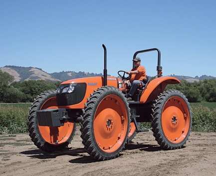

Tractors with large rear wheels and smaller front wheels are inherently unstable.
Buy a tractor with equal size wheels all around.
[/url]
SMALL equal size wheels all around. :)
Not a side hiller:
