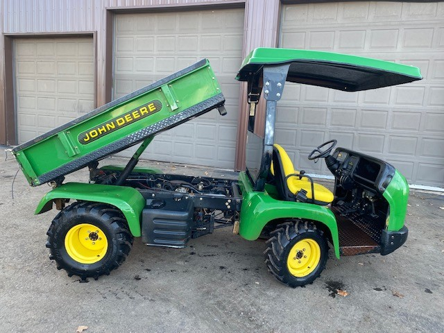

I have a Deere Progator which is made for golf courses. They come 2wd or 4wd with a 5spd manual with a real differential. There is also a lever you can pull to lock the rear differential for more traction. They have a 4x5.5' hydraulic dump bed with a 2000lb capacity and the newer ones can be set up to have twice that. They also have optional rear hydraulic remotes to run a pump or for use as an open center power beyond for say a towed log splitter. I have the diesel 2wd version that I put R4 tires on and haven't gotten it stuck yet in mud or snow but 95% of my property is only at about a 3-4% grade max and I don't use it much when the snow is deep.
New ones are pricey but you may find a used one in good shape, and competitor models are made by Toro and Cushman. I really like mine.
Pic not of mine but mine looks identical:
