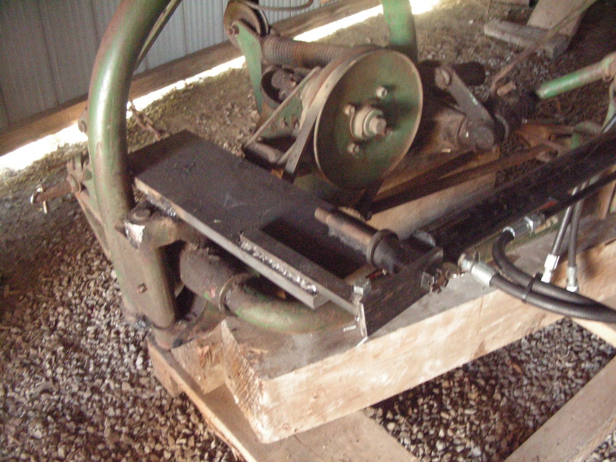

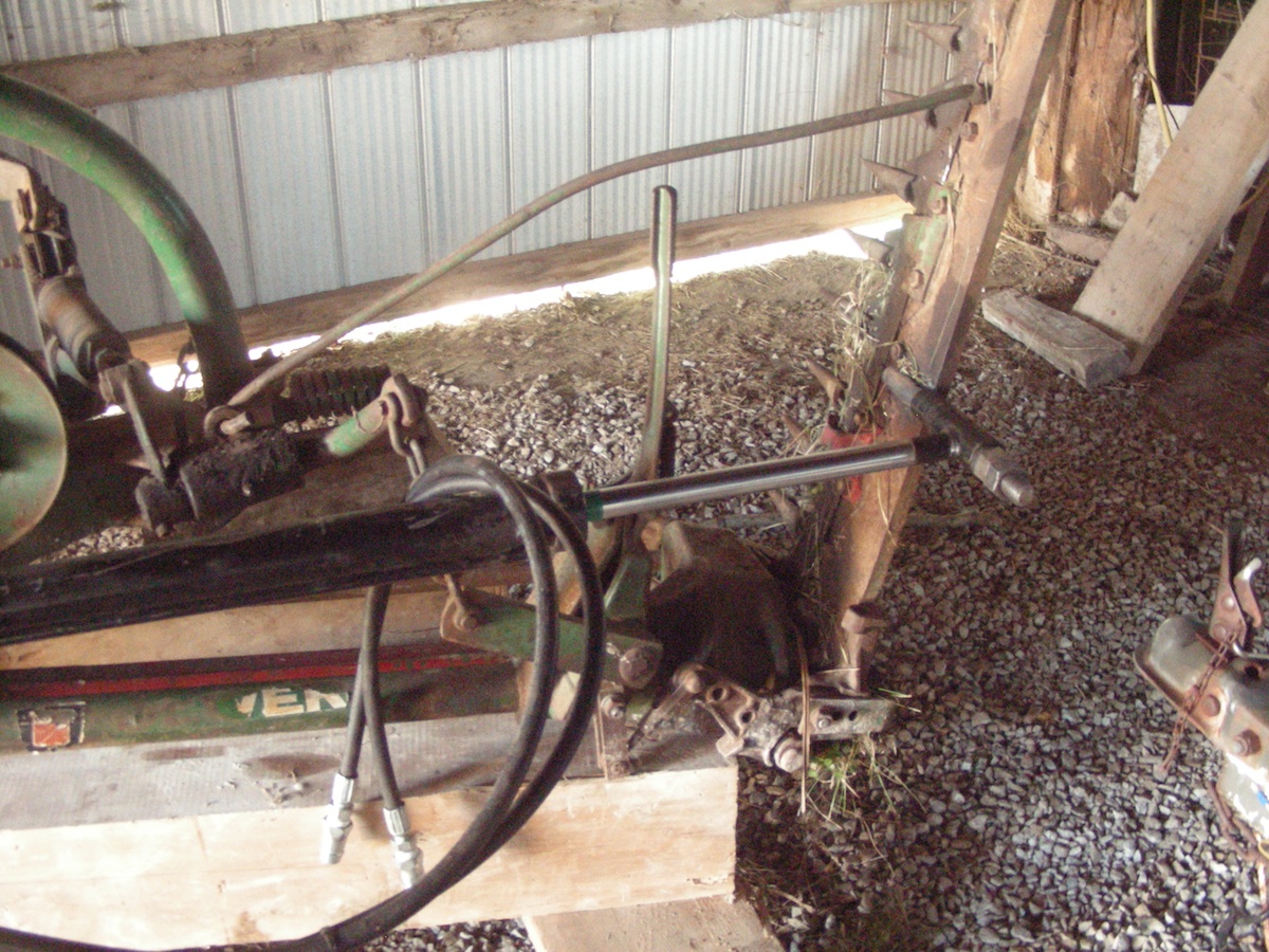

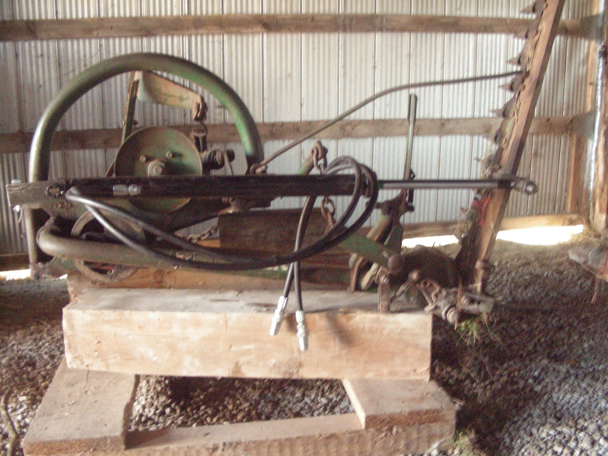

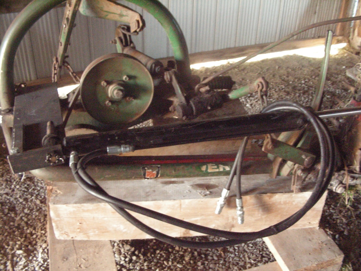

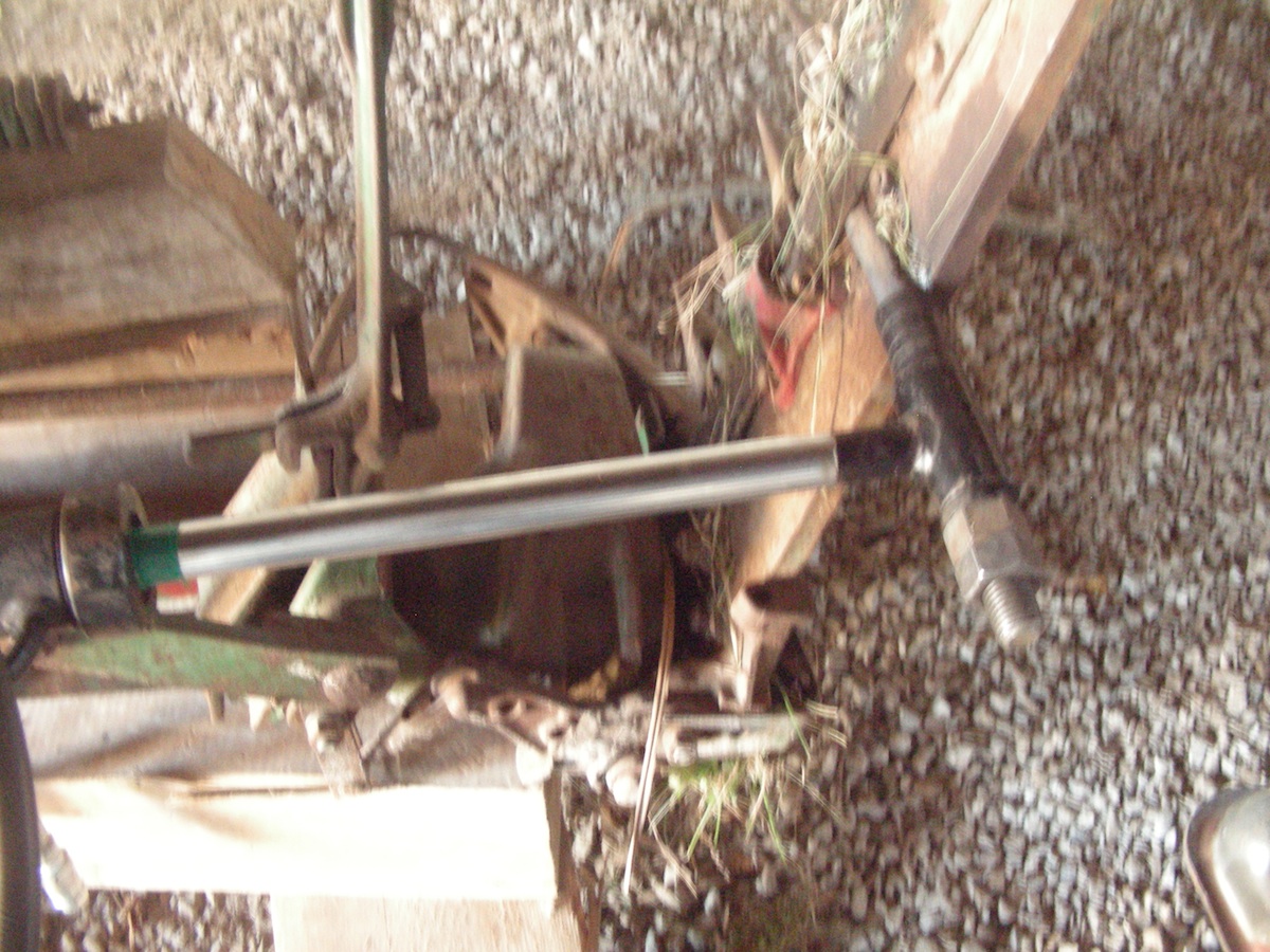

I have rigged a hydro cylinder to my Oliver SMower to raise and lower the bar. It was a learning experience, to say the least. The first setup to hold the cylinder end was done with 3/8' x 1.5", braced; needless to say, the first test, bent that all to H. The second try is 6x20x3/4" (in a different location on the mower); works fine.
Problem: raising and lowering is very jerky. My B3030 puts out 9gpm; do I need to reduce this flow? Is there a smoother lever arrangement?

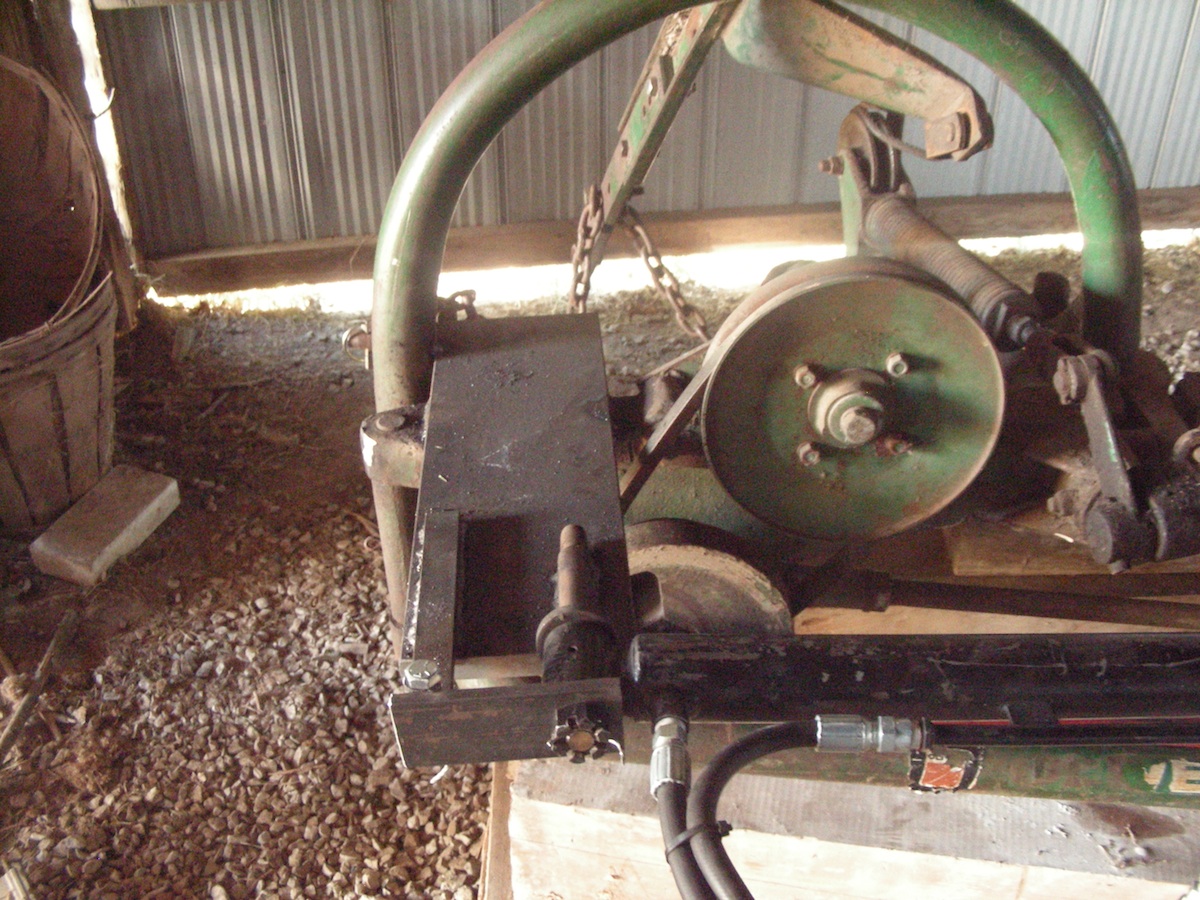

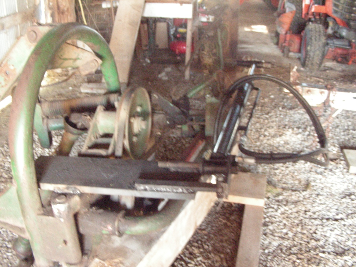

More pics: Please ignore the idiosyncratic welding...

What cylinder are you using--bore, stroke?
/ Sickle Mower Hydraulic #5
Match the flow of the pump to the valve.
A larger cyl bore.
1/4 in hose will limit flow somewhat.
Restricter orifices in the circuit.
Needle valves that you can adjust to suit your needs.
http://www.surpluscenter.com/item.asp?item=9-7961-4&catname=hydraulic
Feather the valve. I believe the valve flow is linear over the spools, so if you move the lever a little, a little fluid will flow. If you push the lever fully fwd, total pump volume will flow.
If you want really slow, then you can split the hyd flow and give the sickle bar mower hyd's the priority flow, which can be low, like 2 to 3 GPM,
Select the valve to match the flow to the sickle bar mower and you should be set.
If done right you should see a big difference.
http://www.surpluscenter.com/item.asp?item=9-4158-3&catname=hydraulic
The speed of cyl operation will also depend on the cyl mounting geometry.
/ Sickle Mower Hydraulic #6
Try this before investing in restrictors or adjustment valves. You only need a single acting cylinder because weight of the sickle bar will pull rod end out and allow it to lower. Remove the hose from the base end of cylinder and connect only the rod end hose. Try lowering and raising. If the jerk is gone, get some type of breather and screw it into the base end port.
Also be sure both ends of the cylinder pivot freely and are well lubricated, some drag here can cause it to jerk.

Make sure the cyl can extend enough for the down hill distance below horizontal , and use the float mode to follow the contour.

Some of the jerkiness is caused by the flex of the cutter bar, but it will jerk less if you raise the height of the cylinder mount on the frame because the vertical component of the initial force is lower. Yes this would alter the range of movment of the cutter bar if you don't also change the lower location.
