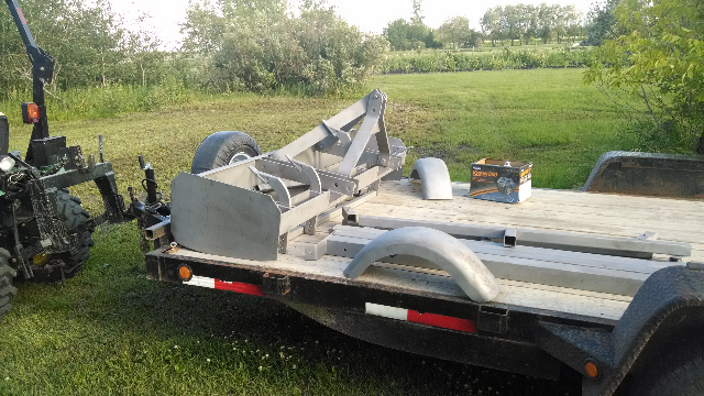

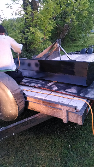

I repainted my box blade this summer. Relatively easy project. Disassembled, sand blasted, primer with xylene based primer than painted with tremclad. So far I'm happy with the results.

Looks nicely done!

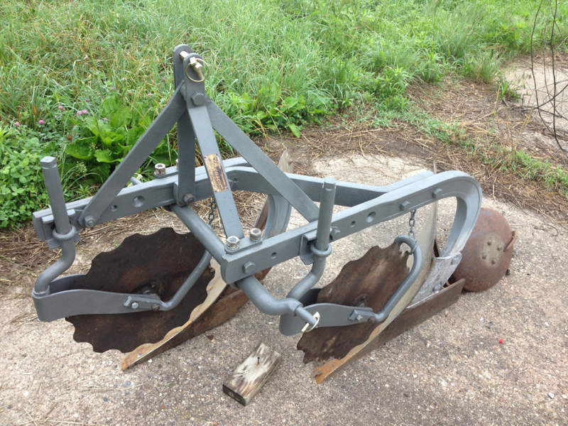

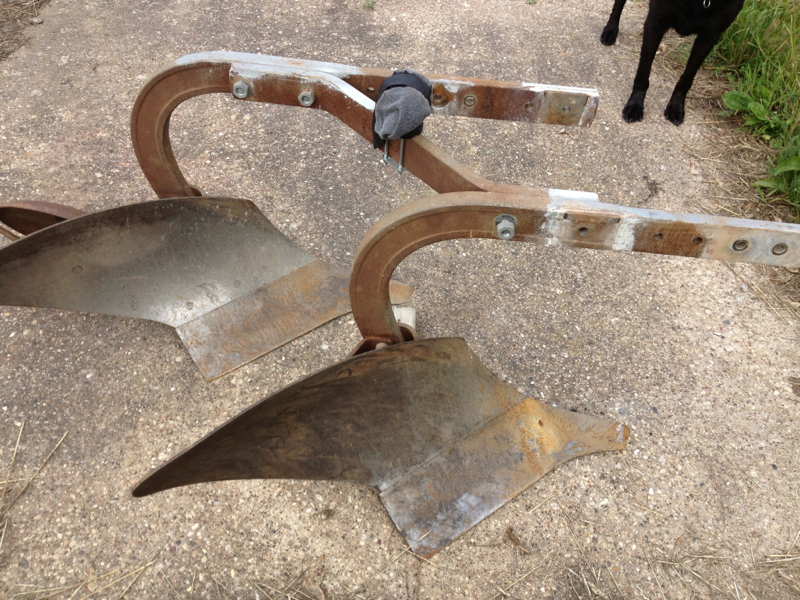

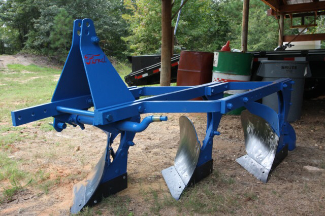

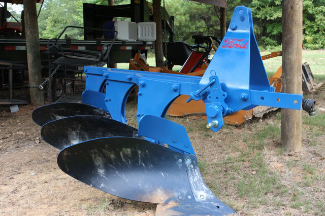

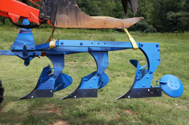

Ferguson 2-Bottom 14-inch Plow

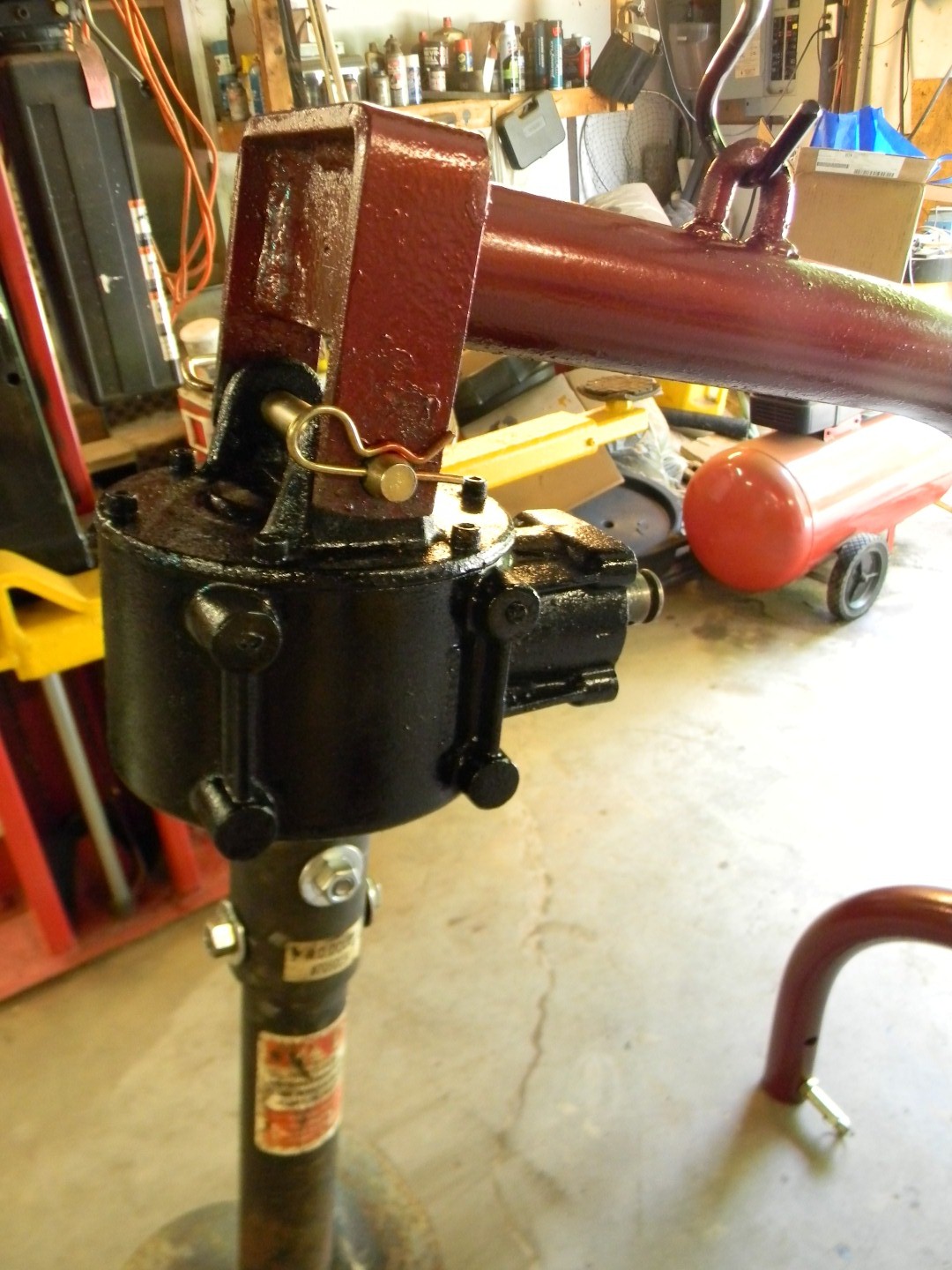

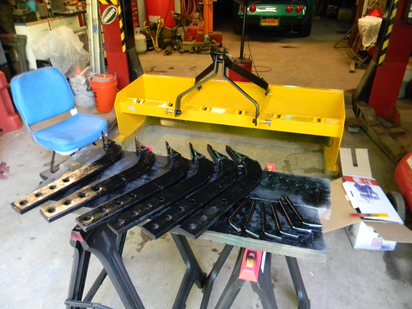

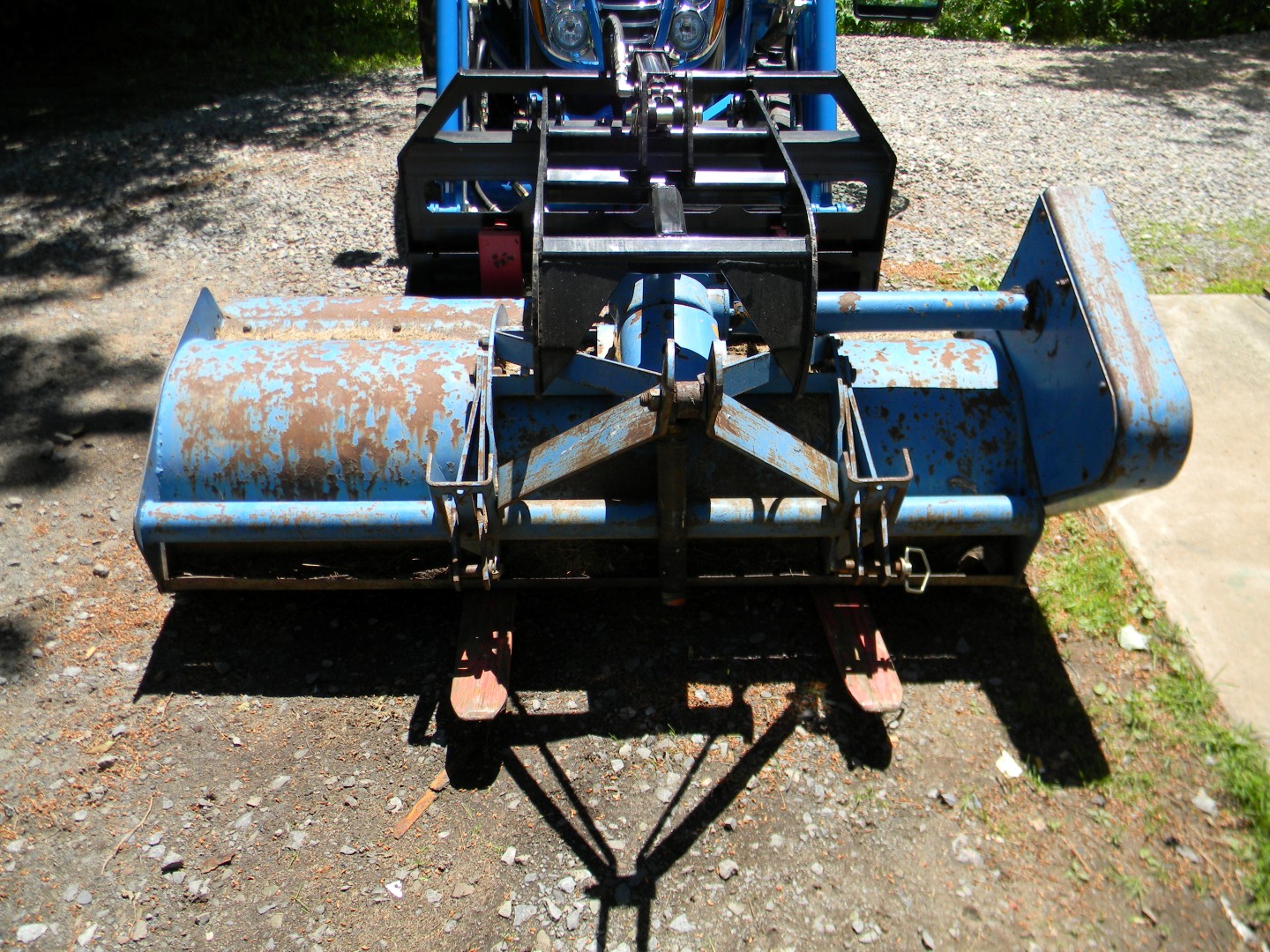

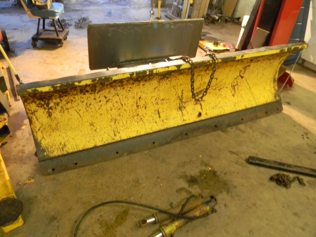

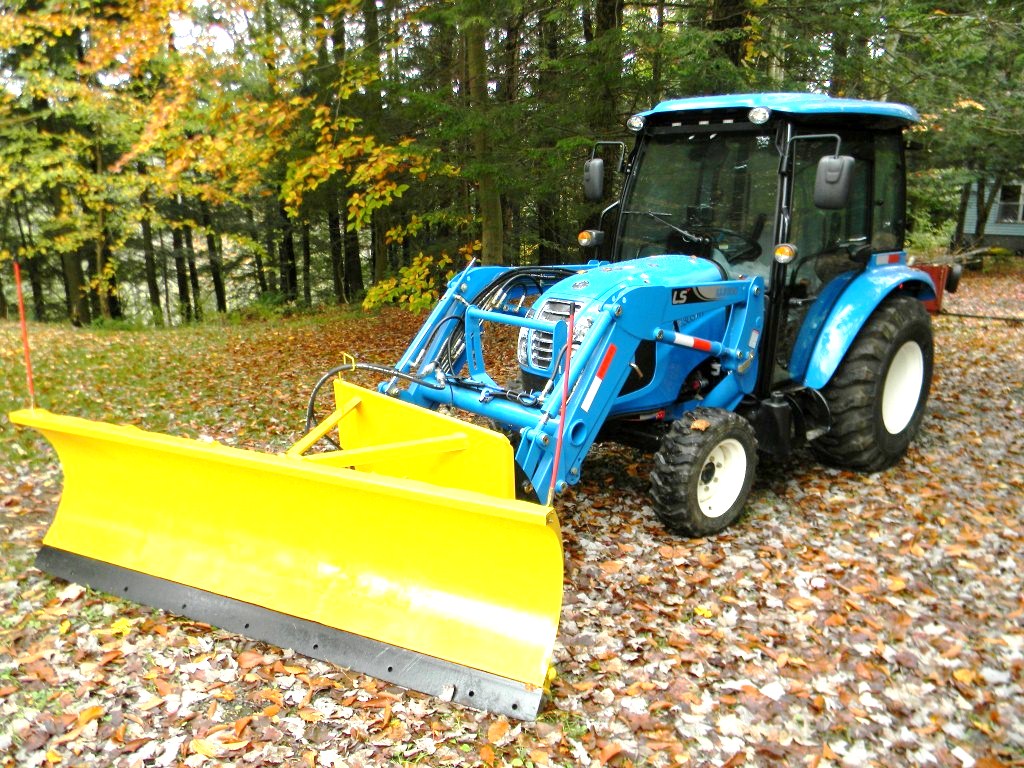

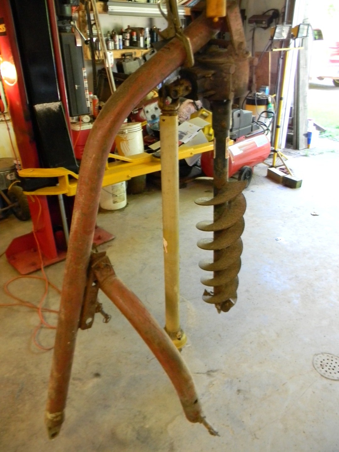

Post hole digger, Box blade, and Flail mower, snow plow.
Post hole digger had to weld on new steel, rebuild U joints, gear box seals, and paint.
Box blade was just a clean up and paint.
Flail had to clean and sharpen blades, replace roller bearings, U joints, gear box lube change, clean and paint.
Snow plow was a complete adaption to SSQA plate for tractor.

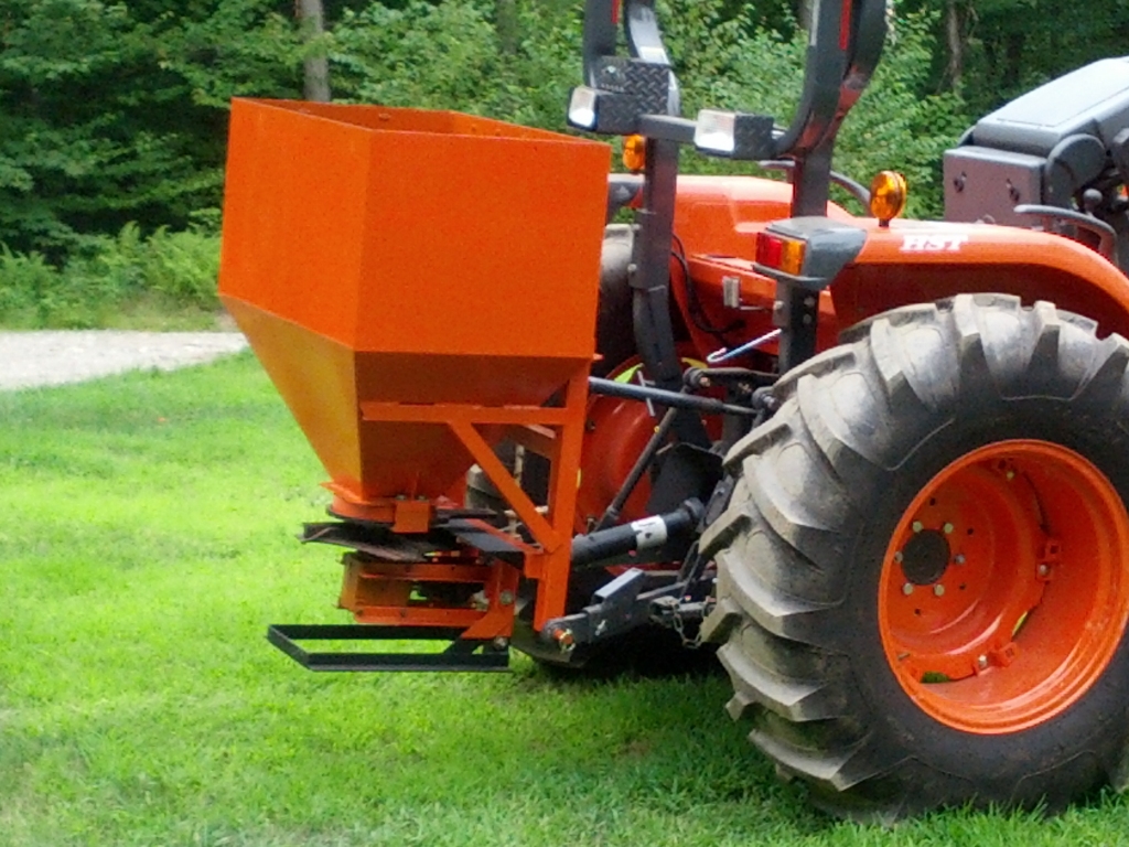

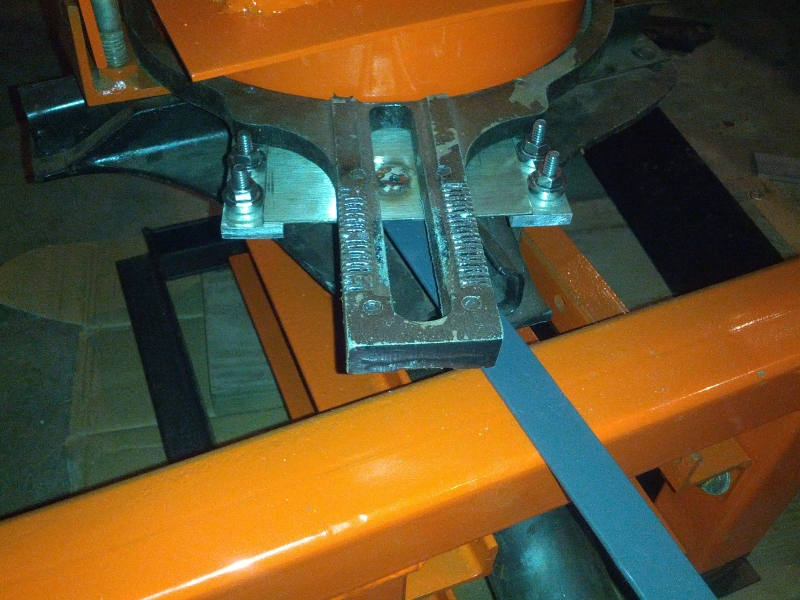

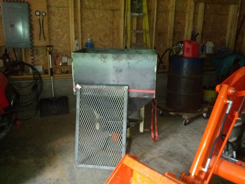

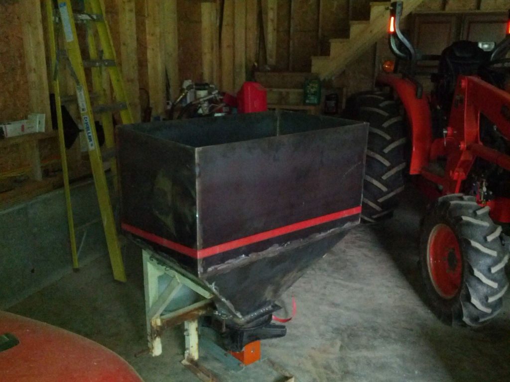

I have a Herd spreader that I got cheap. it was left on it's side so most of the sheet metal was rusted. Also the fertilizer had ate the aluminum plates (the spreader and hopper bottom) so I replaced them. I also installed new seals and shafts in the gear box. It's now basically new for about half the cost.
I don't have too many pictures on this computer but here's what I've got.

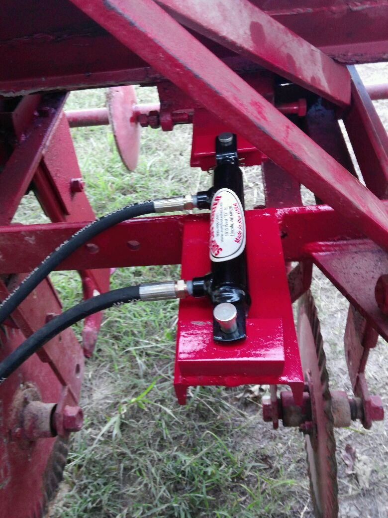

Bought a Taylor Pasture Dream off CL cheap because the 3PT lift mechanism was worn and would not adjust.
Removed the original mechanical arm and installed a small cylinder to open and close the shutter bar.
Worked great!!

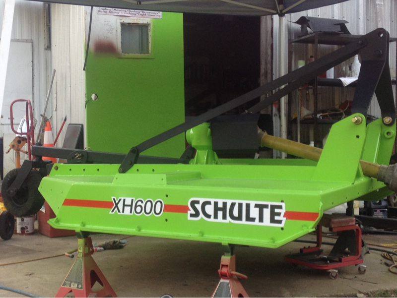

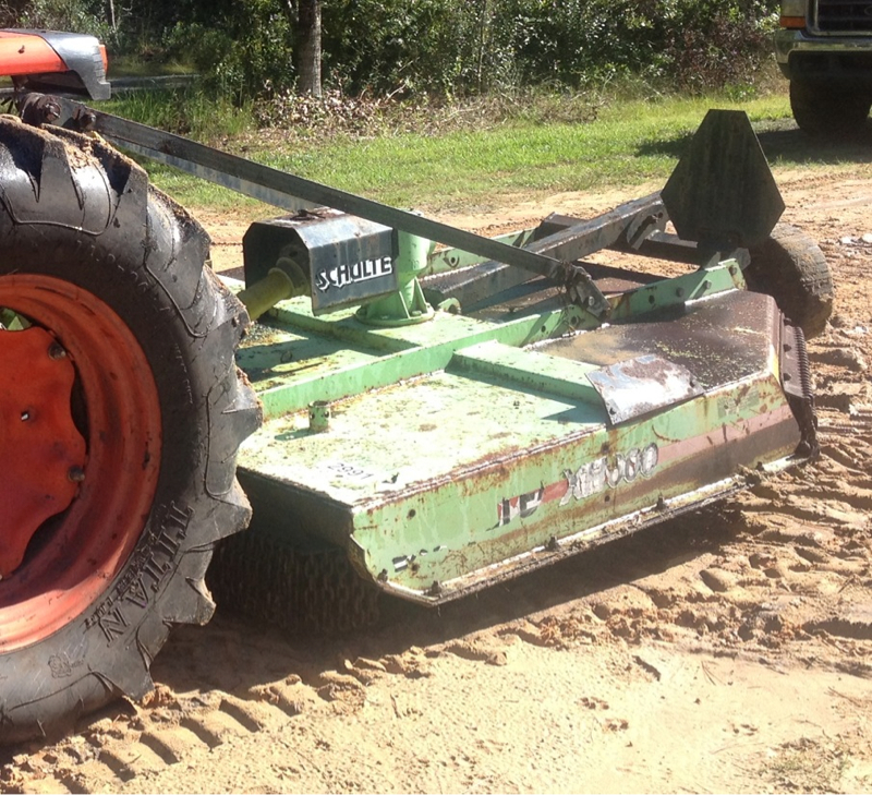

This is a cutter I bought cheap and reworked this past year, it works very good and was worth the effort I put in it. I enjoy reworking equipment,implements and trucks

Thanks. Sadly, I never use it, even though plowing is one of my favorite tasks. I now have a Truax no till seeder so I just don't plow. I need to sell it to someone who can use it

Those are some nice projects! Your MF reminded me of walking into this guys place one day. I was driving down the road and this place looked a little untidy but he had quite a bit of tractors and implements for sale. I stopped in and got talking, he lead me to his shop out back, a true craftsmen.
Check out his website, Idk if it truly makes him justice.

I bet the shipping to Nebraska would be expensive. :(
