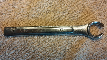

Here is a good example of needing a special tool. I had to change the oil pressure sensor on my Dodge Diesel Ram. So I purchased the dedicated socket. The problem I had was I had an interference fit. The socket would not go straight on the socket. Forcing it on I broke the old sensor. Time for Plan B for the install. All I had was a HF open end wrench. Cut down I had enough room for the install. As pointed out here HF tools are good for making special tools. I usually go to a pawn shop and buy assorted tools to keep on hand.
