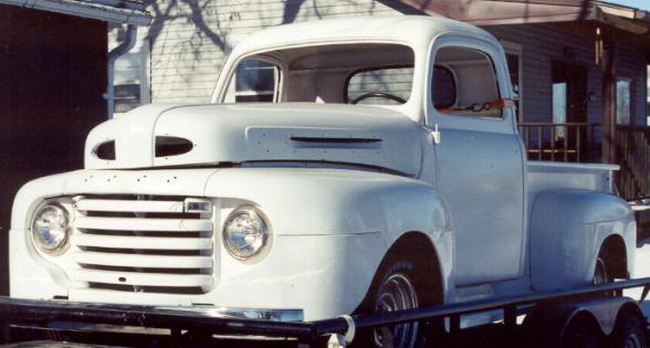

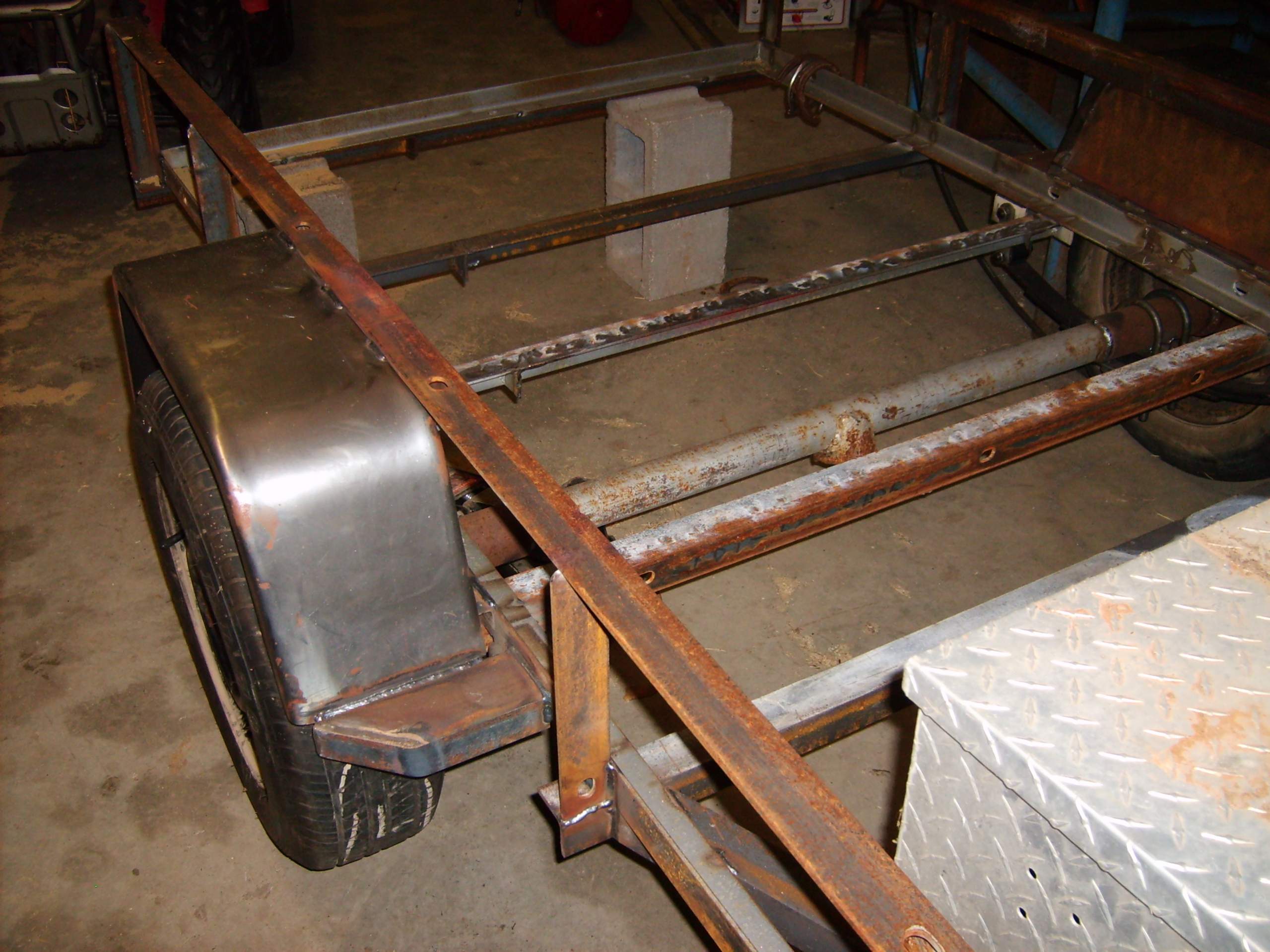

LOL, well here is my first ever real mig weld project...
from start to well almost finished. The truck is on hold for, well, several years.
Bought a a sears little mig welder with a tank, have done countless projects with it. would like a bigger one, but am satisfied with this one also- the 110v makes it handy to cart to others housed for projects

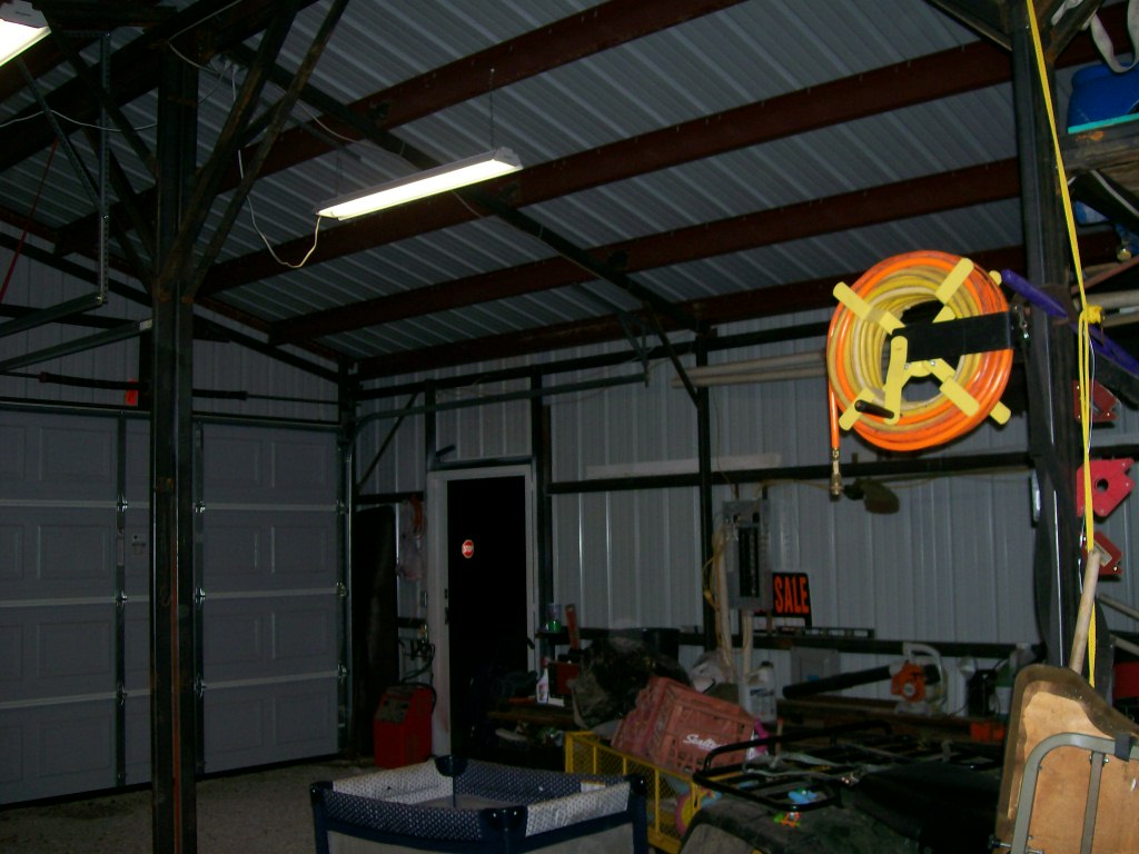

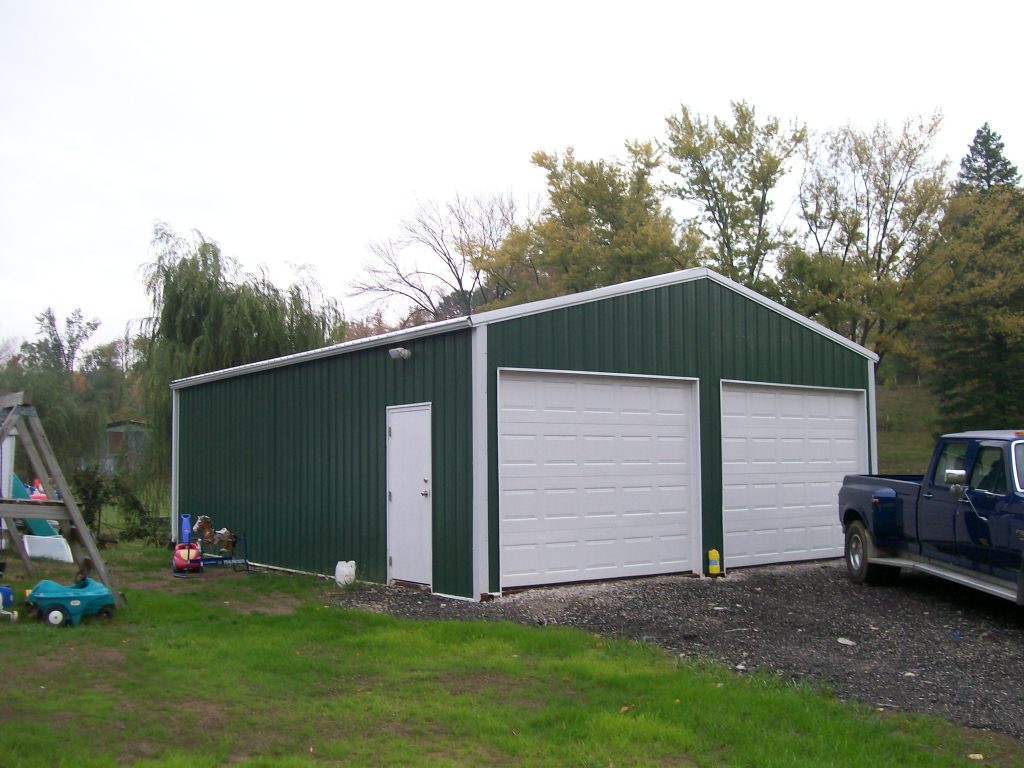

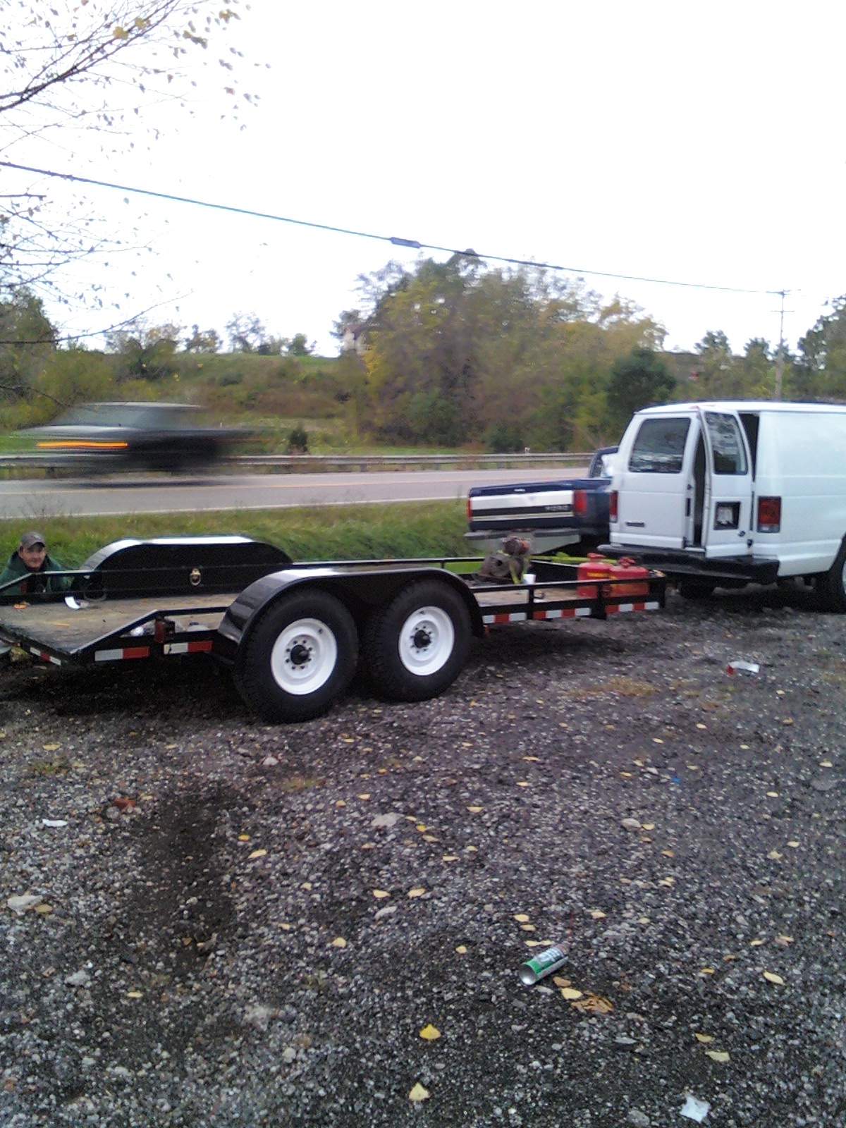

I would say the possiblities are limited only by your budget. Here are some photo's of my bigger projects with the miller 135. The shed is 24x33 build in 2 sections so it's portable all welded with 110v miller hooked to a generator. The back hoe bucket was done with the little mig & a stick welder as the quick attachment plates are 3/8" thick and the mig would not weld that. I use 25/75 mix most of the time. The trailer was a rebuild that I put new fenders on and painted. I do have a larger mig that I have been looking @ but I the guys @ IL-MO got me to try a plasma & I purchased it first, as I have a stick & 110v mig. I got a miller plasma that will run on 110v or 220v. Being able to run on 110v is a real plus as you can plug them anywhere.

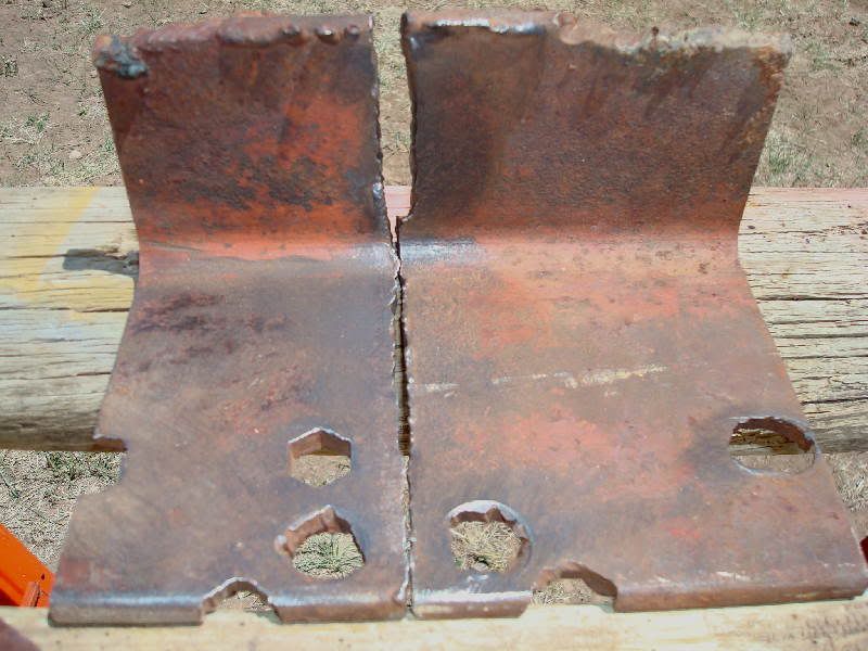

I bought a skidsteer QA off of Craigslist that was supposed to fit my B3030 (according to the seller). I had to re-do most of it in one way or another, cutting it in the middle to narrow it..... widened the outside edges, etc. It was as much a drill press project as it was a welder project, but it came out pretty cool. It now fits my loader perfectly and is probably the best single improvement I made to my tractor.

After fitting the QA to my loader arms, I had to cut the original brackets off my bucket. I could have bought a weld on QA plate for the back of the bucket, but decided to build mine from scratch.
