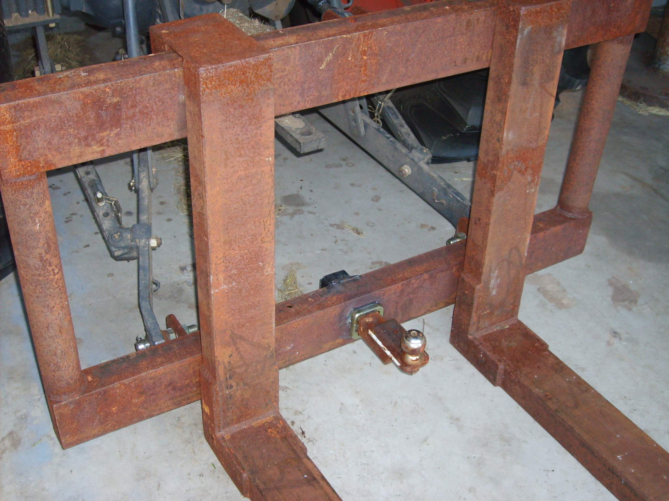

Here's mine. Put it on my most used implement, the forks. The close up pic shows the lower ball and the distant pic shows the upper, gooseneck ball on top.

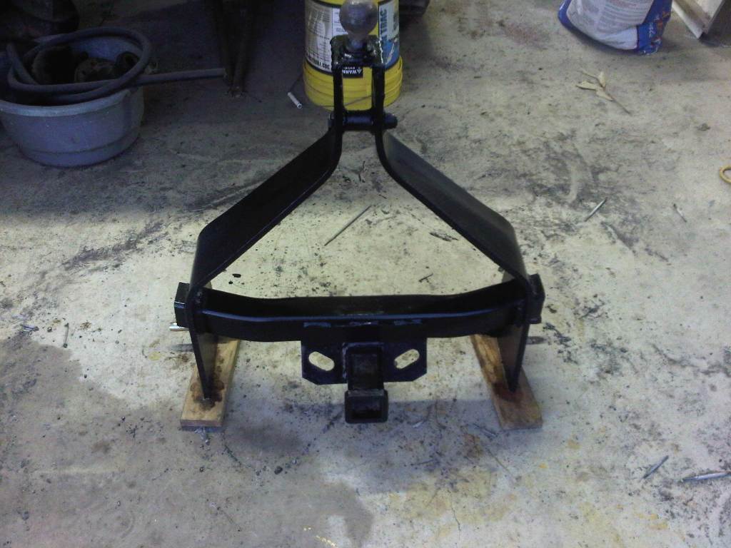

She's not pretty but she'll work. I'll probably weld a 2" and 2 5/16" ball on each side of the reciever later.
