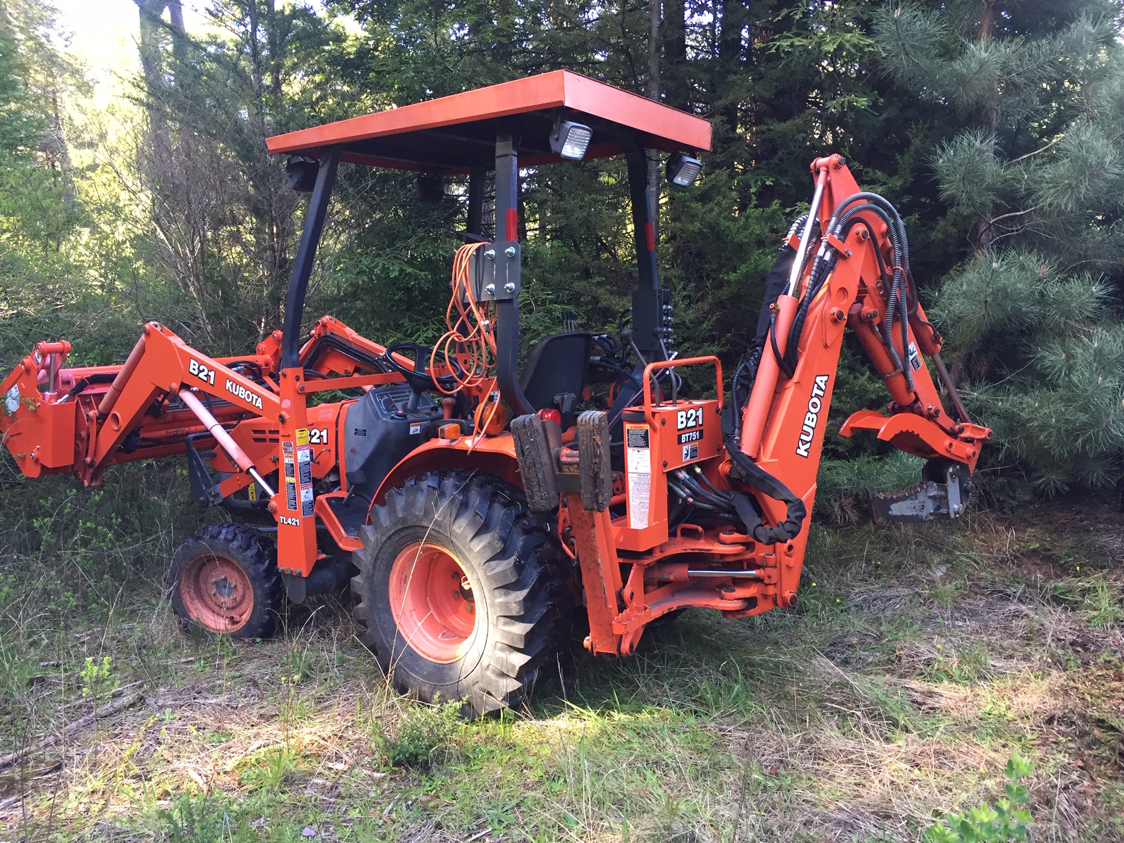

I have a grapple and forks but found the way that puts least stress on my small tractor is the backhoe with root ripper. For most trees I cut the roots on one or two sides then slowly nudge the tree over. A bunch of TBN folk have made them, I bought mine.

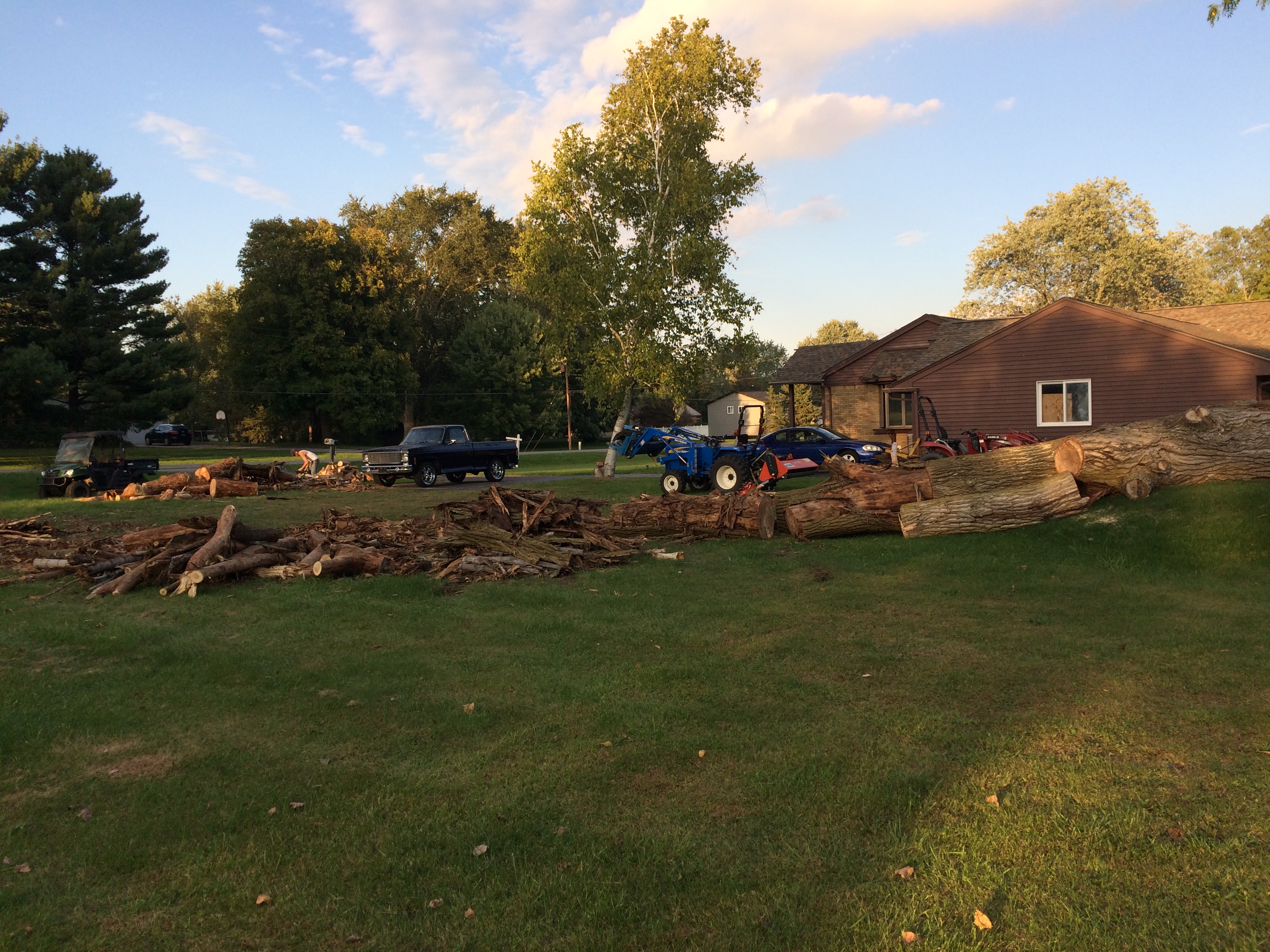

I bought another CUT to not have to take a grapple off to move materials or snow with a std bucket. Of course now that I have vertical and horizontal grapples I bought another CUT for that.
Here's a tree I cleaned up using two machines, and the truck I loaded up using the MIE "Hound Dog" grapple. :)thumbsup:)
Here's what I did with what my 18" Echo CS400 rent asunder to haul off the site, some UNLOADED by hand, but piled on with the grapple.
Be warned! A good grapple won't come cheap, and the 'payback' can stretch into weeks. :D
